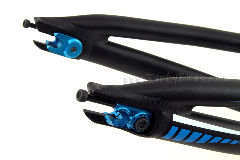

stirlingpowers Posted October 25, 2013 Report Share Posted October 25, 2013 There's snailcams, sprung tensioners with two sprockets, self-made spokes, Hoffmann's eccentric system, and the types I am interested in for this thread: Sliding axle mounts (Ozonys), Deng-style "screw through dropouts", and Inpulse's tool-free comfort screw: If you have had experience with one of the latter three, could you comment on their practicality in adjustment and their ability to hold a position during riding? Quote Link to comment Share on other sites More sharing options...
Martin Reynolds Posted October 25, 2013 Report Share Posted October 25, 2013 I've used the top one on the onza blade, and it seams a solid way to tension your wheel. These as with other systems, the adjustor screws are there only to make the tension, its the axle bolts which should clamp the wheel and stop it moving. Quote Link to comment Share on other sites More sharing options...
J.KYDD Posted October 25, 2013 Report Share Posted October 25, 2013 Onza us a system pretty much the same as the Echo one and its always worked perfectly. As said above, the screws are only there to achieve the right tension, the axle bolts are what actually clamp the wheel Quote Link to comment Share on other sites More sharing options...
Ash-Kennard Posted October 25, 2013 Report Share Posted October 25, 2013 ive found on the onza ones that the tensioning screws seem to bury themselves into the block that contacts the frame and the hub, very annoying as it is a pain in the arse to tension, but doesnt really move once its set Quote Link to comment Share on other sites More sharing options...
dngr2self Posted October 25, 2013 Report Share Posted October 25, 2013 I've used the Onza system which, as stated, is the same as the echo system. I found it to be really easy to set up but did nearly lose a bolt, a drop of loctite though and it didn't happen again. 1 Quote Link to comment Share on other sites More sharing options...
FamilyBiker Posted October 25, 2013 Report Share Posted October 25, 2013 my marino has that too,an it works fine,but i also think the axle position should be/is secured by the axle bolts Quote Link to comment Share on other sites More sharing options...
jambo Posted October 25, 2013 Report Share Posted October 25, 2013 Id find it very hard to choose a frame with snail cams after running these on my Echo worked with my pro 2 like a dream! 1 Quote Link to comment Share on other sites More sharing options...
dezmtber Posted October 26, 2013 Report Share Posted October 26, 2013 those systems i find can creak from time to time, but work well Quote Link to comment Share on other sites More sharing options...
Echo-Scott Posted October 27, 2013 Report Share Posted October 27, 2013 The top picture(Same as on my Neon) is horrid. The bolts doing the tensioning bent within a week of riding. Really not impressed with them to be honest, Running a Heatsink/74 Kings tensioner now. Quote Link to comment Share on other sites More sharing options...
Little Yoshi Posted October 30, 2013 Report Share Posted October 30, 2013 Then ypu didn't have the axle bolts done up tight enough. There should be no weight on the tensioning bolts. Just read the topic and you can see wher. Your going wrong Quote Link to comment Share on other sites More sharing options...
bing Posted October 30, 2013 Report Share Posted October 30, 2013 Onza's method is the best by far. Screw and locknut, and the little axle insert works perfect. I've never had any bother with any of mine Quote Link to comment Share on other sites More sharing options...
stirlingpowers Posted October 30, 2013 Author Report Share Posted October 30, 2013 Onza's method is the best by far. Screw and locknut, and the little axle insert works perfect. I've never had any bother with any of mine I have never been up close to an Onza. Is it this system? Quote Link to comment Share on other sites More sharing options...
bing Posted October 30, 2013 Report Share Posted October 30, 2013 Yeah. Works everytime Quote Link to comment Share on other sites More sharing options...
thinkdougie Posted October 30, 2013 Report Share Posted October 30, 2013 My echo gurb screw rounded off in my frame which made the frame useless :/ Prefer the onza ones as they arn't as much internal. Quote Link to comment Share on other sites More sharing options...
Blake Posted October 30, 2013 Report Share Posted October 30, 2013 Onza ones are the best thing i've ever used. Jack harmer was using them when he had a snapped axle and they still held the wheel in place Quote Link to comment Share on other sites More sharing options...
stirlingpowers Posted October 30, 2013 Author Report Share Posted October 30, 2013 Ok then, thanks everyone for participating, I know a lot more about chain tensioners now, which will help me in deciding the system for my new frame. Quote Link to comment Share on other sites More sharing options...
