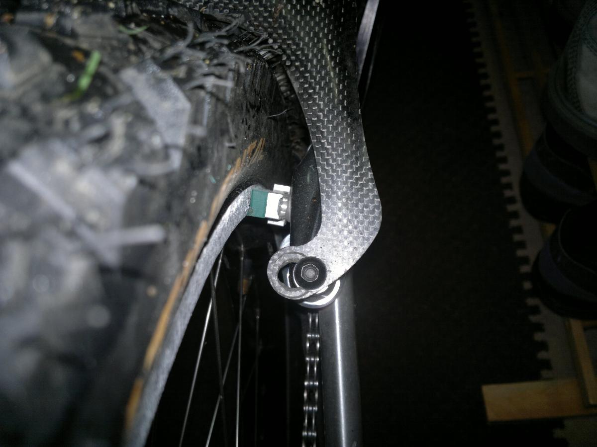

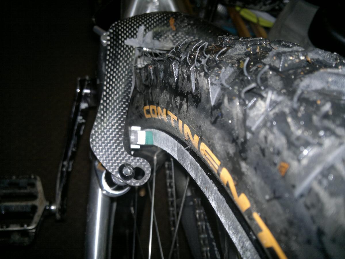

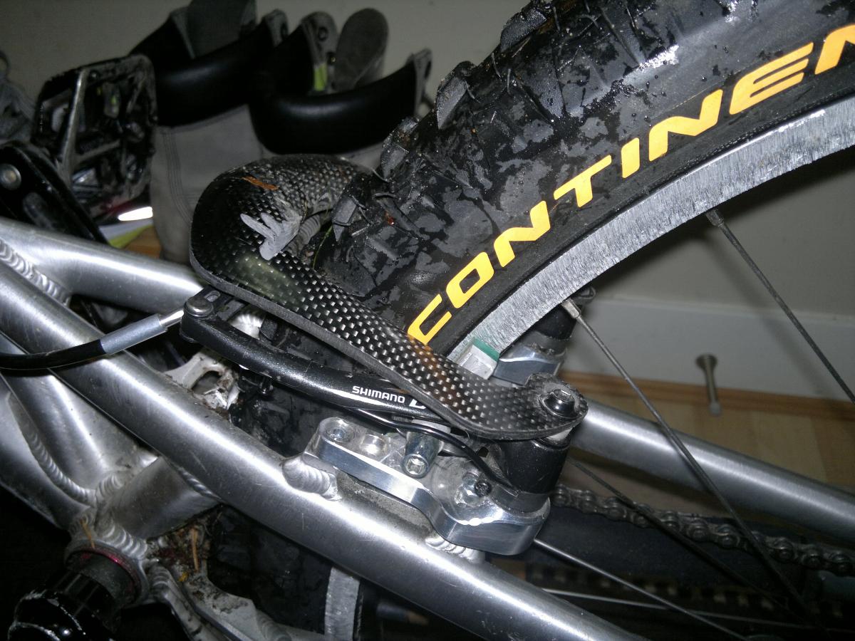

Sam Song Posted October 22, 2013 Report Share Posted October 22, 2013 (edited) I made a switch to rear v brake a few months ago from HS33 rear. I love the v brake's lack of maintenance and the fact that I do not have to worry about the lever when I bail, but I just cannot seem to do rolling moves such as pedal gaps and the full stroke pedal kick right before a sidehop. The v brake simply slips out, forcing me to jump off the pedals. However, I have no issues doing rear wheel sidehops and static gaps. Do I just accept this as a part of v brake characteristics? But I still like doing rolling moves! I do have a booster on there, although I had to grind it a bit to fit the tire, but do you think a new stiffer booster would help? The current carbon booster I have is quite flexy I have to say, but I am just not sure how much difference a different booster would make. My current v brake set up. - Shimano Deore M590 V brake arms - TNN LGV pads - Odyssey Race Linear Slic cables - Avid SD7 lever - $5 carbon booster. I have also attached pictures. I spent an entire morning trying to do the rolling pedal gap to sidehop move that I could do without any issues with my previous HS33 Edited October 22, 2013 by Sam Song Quote Link to comment Share on other sites More sharing options...

isitafox Posted October 22, 2013 Report Share Posted October 22, 2013 First thing I'd do is swap the weenie booster for a decent quality one and then see how you get on. For $5 you shouldn't really expect it to be that powerful, especially when they're designed for XC bikes. Quote Link to comment Share on other sites More sharing options...

jambo Posted October 25, 2013 Report Share Posted October 25, 2013 (edited) Does it display the same characteristics with a good clean and a grind or have you been running it for a while and worn them in? from the angle of the photo it also looks like your pads could perhaps be more central to the rim. Edited October 25, 2013 by jambo Quote Link to comment Share on other sites More sharing options...
