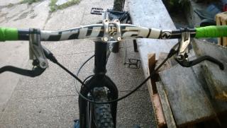

FamilyBiker Posted October 21, 2013 Report Share Posted October 21, 2013 What did you mean about the 'pivot bolt', by the way? for the non-quoted text:yeah,i shouldnt´ve been coming across that way,sorry.get what you mean. for the quote: thats a pic from the german trials forum,the guy told about the lever pivot loosening all the time,so he fixed it with a ziptie. got no other pics then that copied-and-pasted one here,but several stories of other people reached me per pm(i asked how they get on with their 14s,because i really was interested in them really being better now). seems to be a new common thing Quote Link to comment Share on other sites More sharing options...
