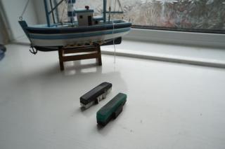

This is really starting to annoy me now, i grind my rim and pretty much 90% of the time in less than 2 weeks the brake is shit and it slips when i gap or anything and i nearly end up on back... ive tried ADMs LGMs Cousts Rockpads. Im using a Rockman singlewall rim and have tried using diamond cutting discs, stone and metal cutting discs (2.5mm). I notice when i take pads off their covered in this silvery stuff ? but even when i clean it off and put them back on the brake is pretty poor and needs a regrind even though grind feels adequate .

What did you clean the rim with ? Maybe it was oil based ?
Clean both with hot water and fairy. Other than that have you bleed your magura right ?
Clean the rim after you put your tyre on if you remove it to grind

May be your actual rim that just doesn't like rim brakes kinda like the issues with trialtech rims? Probably cheaper to replace the rim as it's not cheap to keep on buying new pads just to try and get a brake that works?
I got a rim you can have for postage if you want it? Presuming you need 26" :)
I've been doing that Dave and that's what ive been washing pads with too, and I always leave tyre on when I grind the wheel (:
You washed the rim with hot water and fairy ?
It's either rim or pads then, hard to tell without seeing it
Being a noob my thoughts might not be relavent due to lack of experience but ill offer them anyway :) have you tried a less course grind? I think that the peaks of the course grind are wearing off quickly or being rolled over. Try following the grain of the grind with a rotary wire brush on the next grind, that should remove the loosest material.
As an abrasive spins it will take material off but on ally it deposits some of what's on the disc in a friction way, which will come off under load but won't wash off.

Here's what I do: I attached a spray nozzle to a bottle of 90% alcohol (rubbing), and I simply spray the rim down and wipe off the dirt. Sometime I'll spray the pads too, modulate them whilst the wheel is spinning and wipe off the excess again. It's easy...if I'm riding natural, I'll just throw the bottle in my dufflebag.
It also looks like the pads may not be hitting the rim square--facing the mounts may help this. There's a TNN video somewhere on youtube that demonstrates this pretty well, if I am remembering correctly.
Lastly, perhaps try altering the angle you are grinding the rim at. I find a near 90 degree angle gives the best results.
Lastly (again), are the brakes properly bled?
