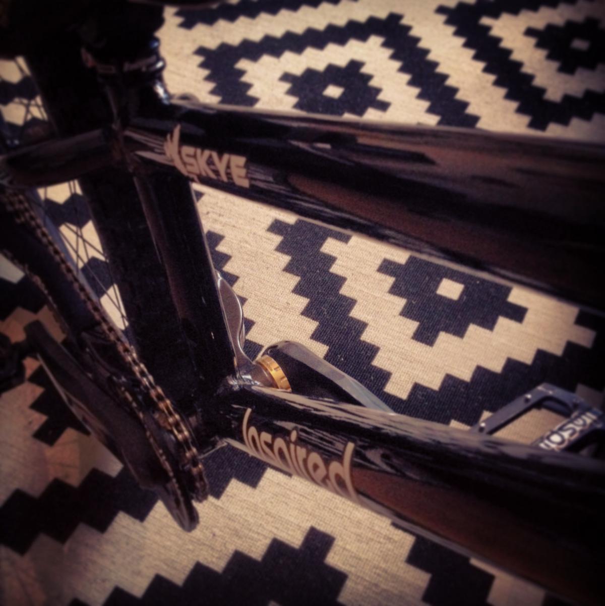

CalopS Posted October 31, 2013 Report Share Posted October 31, 2013 Quote Link to comment Share on other sites More sharing options...
nicolasp1405 Posted October 31, 2013 Author Report Share Posted October 31, 2013 yes we know its a very lovely ride! Quote Link to comment Share on other sites More sharing options...
