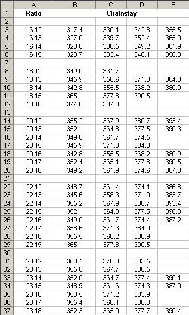

Mark W Posted November 22, 2013 Report Share Posted November 22, 2013 There's a chart Adam made that should shed some light on any ratio/CS length queries. Got no idea where it is, but rumour has it if you mention it, Isitafox will post it. Time to put that to the test... Quote Link to comment Share on other sites More sharing options...

FamilyBiker Posted November 22, 2013 Report Share Posted November 22, 2013 (edited) first! funny my cs turns out at 358 with 22:17 only with the tensioner i have,so the dropout angle should be blamed,or other factors and my chain isnt stretched yet Edited November 22, 2013 by FamilyBiker Quote Link to comment Share on other sites More sharing options...
Mark W Posted November 22, 2013 Report Share Posted November 22, 2013 In related gear ratio news, I think Ali's currently running 22:16 and that also fits with the wheel fully slammed in the dropouts. 1 Quote Link to comment Share on other sites More sharing options...

isitafox Posted November 22, 2013 Report Share Posted November 22, 2013 There's a chart Adam made that should shed some light on any ratio/CS length queries. Got no idea where it is, but rumour has it if you mention it, Isitafox will post it. Time to put that to the test... Funnily enough I was looking at that earlier! Quote Link to comment Share on other sites More sharing options...
