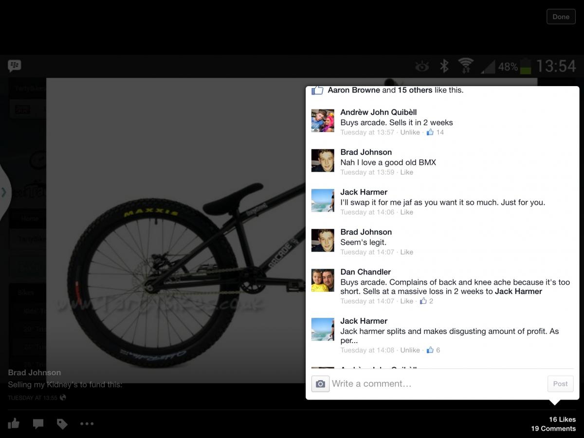

bing Posted November 21, 2013 Report Share Posted November 21, 2013 I find it interesting though how on here people are talking about how it has a 'long reach' (which relatively speaking I guess it does), yet I saw someone from TF saying about how an Arcade would give someone a bad back if they rode it because it's 'so short'. I said this to brad Johnson on Facebook, as he's been complaining about his knees hurting form riding a 'pure trials' rig. It was purely a wind up, is this what you've heard mark? Quote Link to comment Share on other sites More sharing options...
Mark W Posted November 21, 2013 Report Share Posted November 21, 2013 Fair enough. I'd seen a few people mention about how short the Arcade was both before it was released and after, so just took that at face value. My bad... Quote Link to comment Share on other sites More sharing options...
bing Posted November 21, 2013 Report Share Posted November 21, 2013 (edited) Dunna worry mate. It was more to do with the fact brad changes bikes more than he changes underwear, and buying one of these was part of it Edited November 21, 2013 by bing Quote Link to comment Share on other sites More sharing options...
