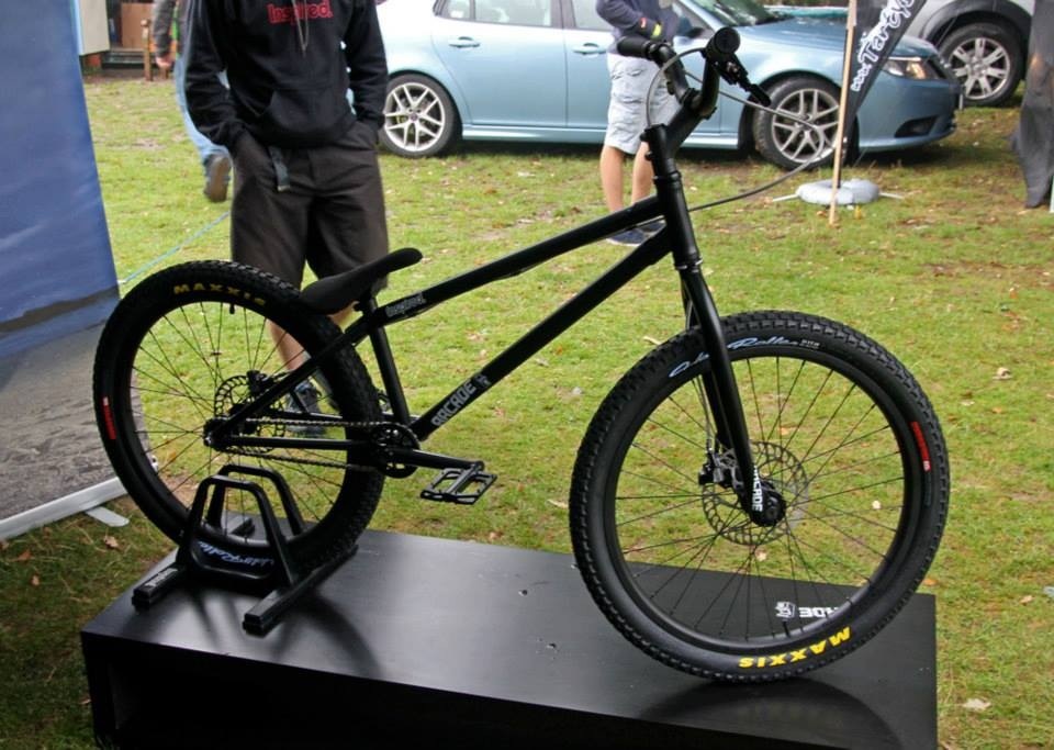

shercofray Posted October 9, 2013 Report Share Posted October 9, 2013 Having ridden both, I'd say the arcade feels more bmx orientated. The Skye I've ridden was standard so with the cut down fork steerer and hope stem, so i found the front end felt far too low. As the arcade is steel that also contributes massively to the bmx feel. Personally I'd go with the Arcade. Ali/Mark will be able to give a more detailed reply as they have more experience with the bikes. Quote Link to comment Share on other sites More sharing options...

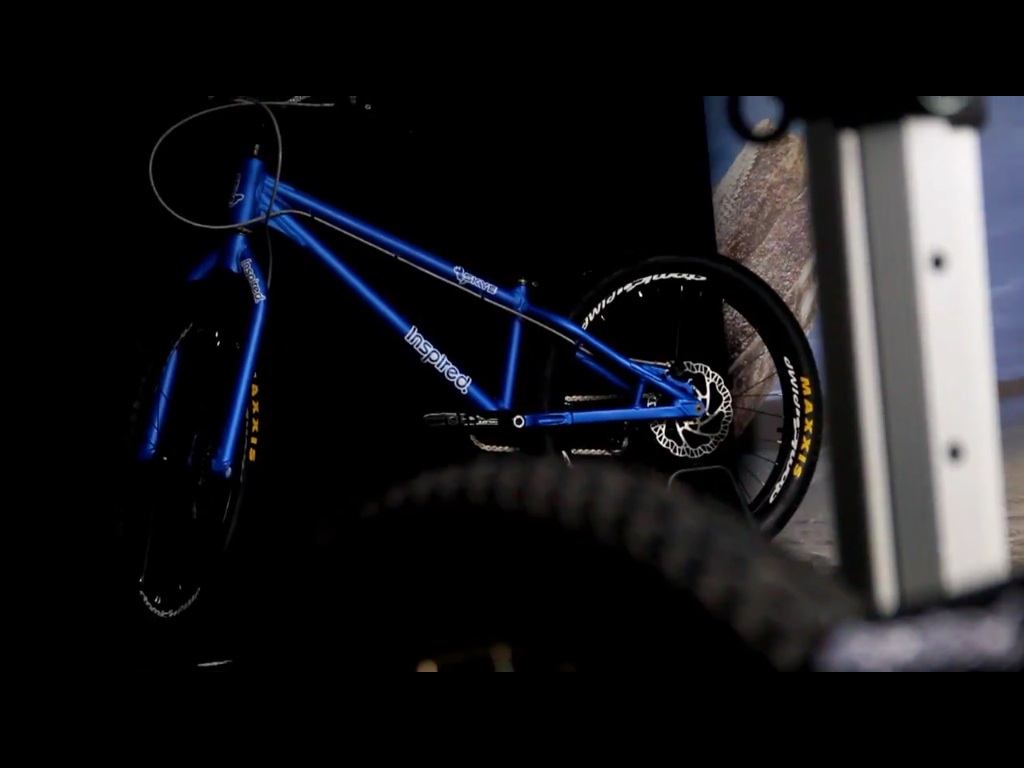

Ross McArthur Posted October 9, 2013 Report Share Posted October 9, 2013 Having had a wee go on both last night, it would be hard to choose! The Skye has a much shorter cockpit and a lower bb which felt ok but I prefer a longer reach and the feeling of being over the front axle more, which the Arcade delivers. I have to say though, the Skye blue is thee best paint job Ive seen! So in terms of looks, I’d go for the Skye. Quote Link to comment Share on other sites More sharing options...

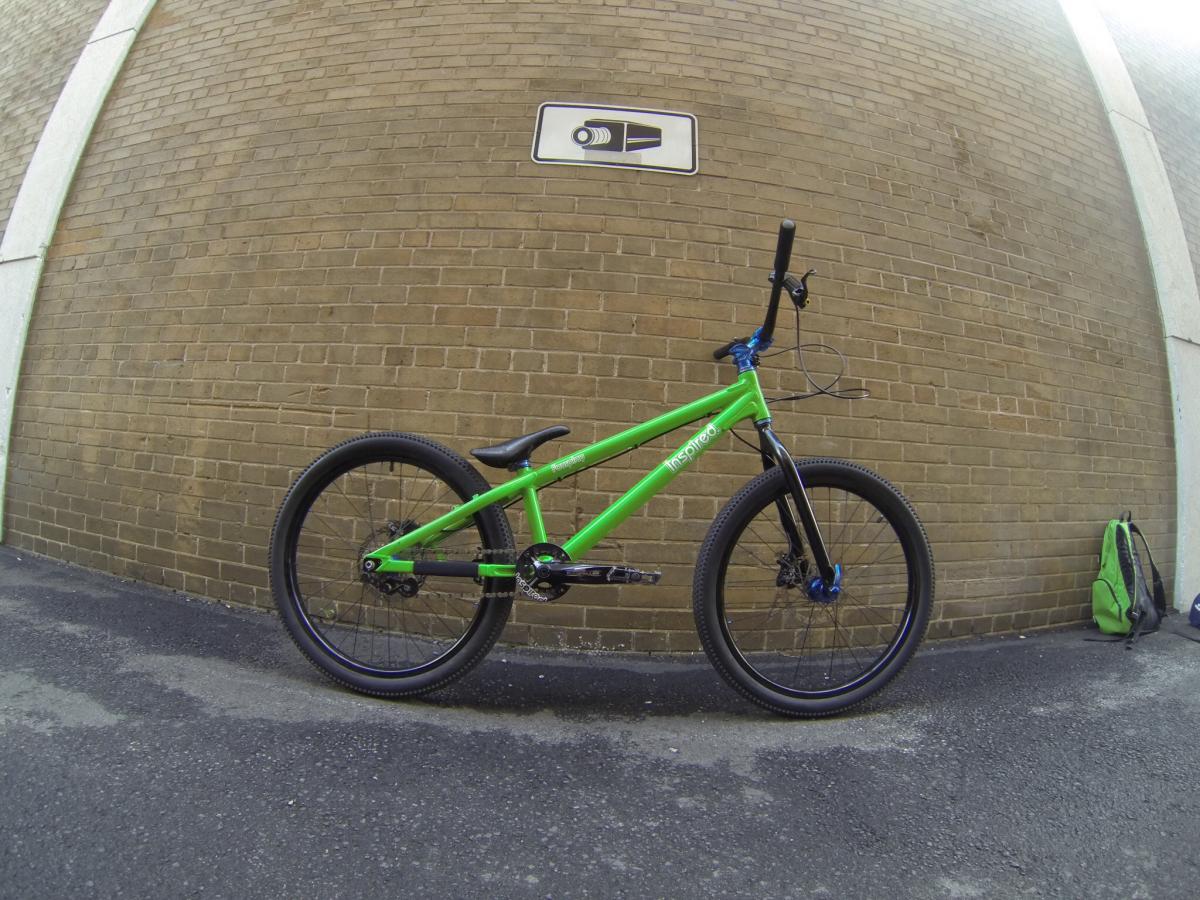

nicolasp1405 Posted October 9, 2013 Author Report Share Posted October 9, 2013 No i'm not able to 180 or manual with the fourplay, for the 180 it feels like i dont lift enough , i'm doing more like a 90 hop, the front doesnt lift.. but i have the money for the change. I wont buy a complet one tough, i'm ether buying the skye framekit or the arcade framekit.. And i mean would a bike with a smaller reach be better for a smaller rider? Quote Link to comment Share on other sites More sharing options...
Ash-Kennard Posted October 9, 2013 Report Share Posted October 9, 2013 (edited) what stem are you running? EDIT: dont worry hope, i saw your pic, maybe a higher front end would do it? get some 3" risers on there and get a short steep stem. if that doesnt work try the frameset but im certain this will help you Edited October 9, 2013 by Ash-Kennard Quote Link to comment Share on other sites More sharing options...
nicolasp1405 Posted October 9, 2013 Author Report Share Posted October 9, 2013 Witch frame set? Actually the picture is deformed by the gopro, i'm using a pretty small stem a 70/25 hope and a trialtech high riser... Quote Link to comment Share on other sites More sharing options...
Ash-Kennard Posted October 9, 2013 Report Share Posted October 9, 2013 i reckon the arcade, but thats because its been developed and approved by some riders i massively respect. look at the bar and stem on the arcade something like that would be good Quote Link to comment Share on other sites More sharing options...
Paperclip Posted October 9, 2013 Report Share Posted October 9, 2013 Swings and roundabouts as both bikes will ride nice you clearly aren't that bothered about geo (If you was bothered about the geo of a bike you would already have your answer) People comparing a factory standard Skye to a team riders personal setup bike is a little silly in my opinion. A factory build Arcade will probably come with a shorter front end and the factory Skye won't have the new shape handlebars (On the one at Tartydays) Personally I find the attention to detail Inspired have gone with on the Arcade from the dropouts all the way up to the headtube. I would say the only flaw against a Skye would be the weight, Agreeing with Ross on the reach of the frame being a big plus for me aswell as horizontal dropouts. Quote Link to comment Share on other sites More sharing options...

Ross McArthur Posted October 10, 2013 Report Share Posted October 10, 2013 I dont think anyone knows (who hasnt ridden Ali or Marks bike) just how f**king short these arcades are! Good luck hoping on the back wheel! Quote Link to comment Share on other sites More sharing options...
AdamR28 Posted October 10, 2013 Report Share Posted October 10, 2013 Well they are and they aren't. The wheelbase is short, but the cockpit is pretty long (steep head angle and short back end) - which is the important bit IMO, you don't hang onto your wheel axles when riding Quote Link to comment Share on other sites More sharing options...
Ross McArthur Posted October 10, 2013 Report Share Posted October 10, 2013 Who said anything about wheelbase? Quote Link to comment Share on other sites More sharing options...
AdamR28 Posted October 10, 2013 Report Share Posted October 10, 2013 Me Because most people immediately think 'wheelbase' when anyone uses the word 'long' or 'short' in the same sentence as 'bike'. From memory the BB to bars dimension on the Arcade is longer, but the wheelbase on the Skye is longer. So which bike is longer? 1 Quote Link to comment Share on other sites More sharing options...
Mark W Posted October 10, 2013 Report Share Posted October 10, 2013 I dont think anyone knows (who hasnt ridden Ali or Marks bike) just how f**king short these arcades are! Good luck hoping on the back wheel! Sure you're not just thinking of your Archive there bearing in mind 1) the Arcade has a steeper head angle so consequently a slightly longer reach (which is the important bit...) and 2) no-one who's ridden one has had a problem backhopping (or 'hoping' if you prefer) on it? 1 Quote Link to comment Share on other sites More sharing options...

LEON Posted October 10, 2013 Report Share Posted October 10, 2013 (edited) Well you've read about the old Skye, with the improvements on the new one it's gonna have a stiffer front end, pretty bombproof, and the back end is obviously down from 380mm, probably around 360mm. So call it a 970wb instead of the old 990 assuming the front end hasn't changed. The Arcade ain't gonna have a shorter wheelbase than that., and people are saying the reach is longer too. Being pretty short so you might find a Skye front end more manageable. That's all on paper obviously, I'd love to ride both. Edited October 10, 2013 by LEON Quote Link to comment Share on other sites More sharing options...
