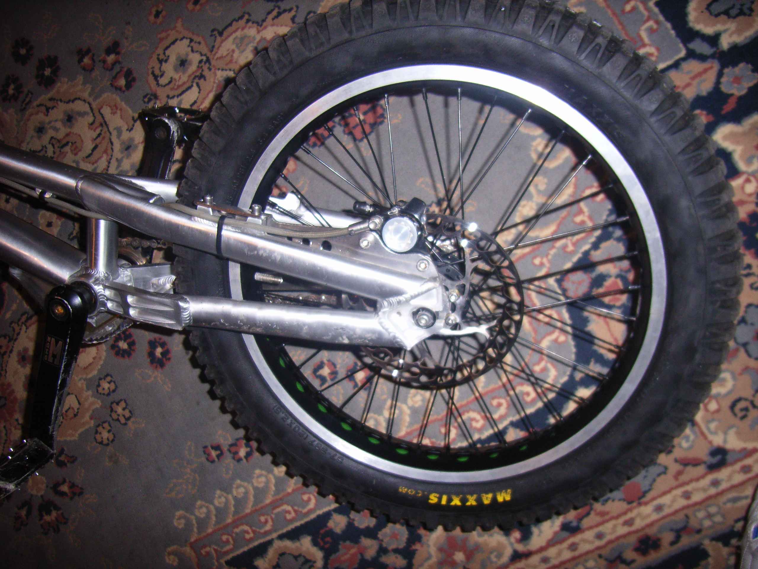

just for your information there are ways of creating disc tabs on a 20" maggie frame
LINK
and here the picture. i hope you appreciate this it took agessssssssssss to find this picture
I appreciate any help bud, especially if youve had to go out of your way to give it :)
Im a fabricator, the idea had struck me too.. but ive been told by those in the know that rear disk isnt all that good on a stock so i abandoned the thought and went the traditional route. (Well unlike me)
