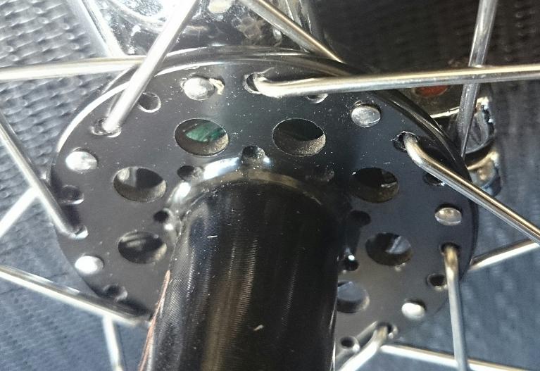

isitafox Posted April 13, 2014 Author Report Share Posted April 13, 2014 Fianally got around to doing this, used an Echo TR rim which the ERD was only a few mm different on and has worked perfectly. Ended up so I fitted a spoke head in, head out, gap, head in, head out, gap, head in, head out, gap, etc.... Shouldn't really be any weaker than a standard build as I'm utilising all the holes in the rim and the spokes are all tensioned up, will see how it goes! 3 Quote Link to comment Share on other sites More sharing options...
