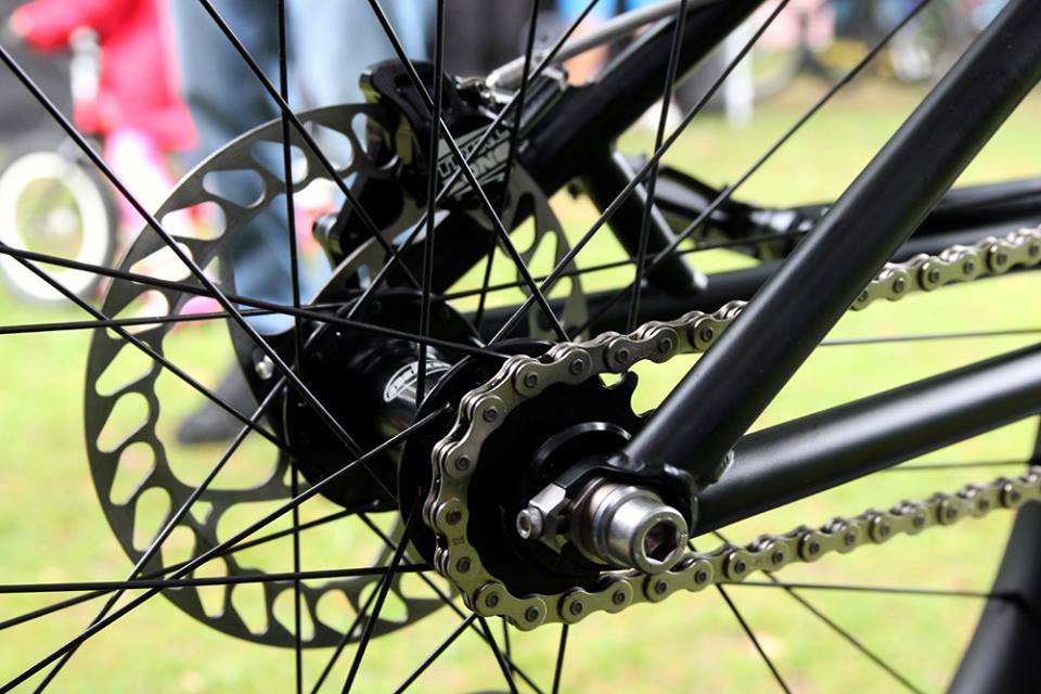

FamilyBiker Posted September 4, 2013 Report Share Posted September 4, 2013 (edited) ah,marino dropouts(pic) you´d know if you tried that a chainwheel wears unevenly due to the fact youre pedal kicking only with one quarter of it,leading to loose and tight spots when the chain runs.the tensioner solution is to avoid that slack points,or at least you dont have to readjust tension every other ride.or youre just aiming for a certain chainstay length,your chain would be loose in most cases thats why i see bikes with snailcams always have a slack chain in "good foot forwards" position Edited September 4, 2013 by FamilyBiker Quote Link to comment Share on other sites More sharing options...

stirlingpowers Posted September 4, 2013 Report Share Posted September 4, 2013 How is the axle kept in place with the new type of vertical adjustment system (like on the new Arcade, the Marino, Ozonys, Zoot Pro and others)? Mostly, there is just one screw. Ozonys have another one perpendicular to the chain direction to press the slider onto the frame to prevent it from moving forwards under chain load, so do the others also rely on this principle, but just use the axle screw for this instead? Or in other words: Does it work properly, i.e. better than the annoying snail cams? Quote Link to comment Share on other sites More sharing options...
isitafox Posted September 4, 2013 Report Share Posted September 4, 2013 Frames like the Zoot Pro and the Marino pictured at the top use a screw to push the axle back to achieve the correct chain tension whereas frames like the new Arcade, standard Zoot and many others use chain tugs like on a BMX which pulls the axle back to achieve the correct chain tension. I personally would say it's only better than snail cams as you don't need to modify the spacers on a 135mm hub or squeeze them in between the dropouts, some chain tugs tend to get bent and snap with heavy use and with the bolt tensioners if you're not careful vibrations over time will run them loose till they drop out of the frame. There's pros and cons to all the different tensioner methods! 1 Quote Link to comment Share on other sites More sharing options...
Mark W Posted September 4, 2013 Report Share Posted September 4, 2013 How is the axle kept in place with the new type of vertical adjustment system (like on the new Arcade, the Marino, Ozonys, Zoot Pro and others)? It's horizontal adjustment, not vertical. Most frames use a variation on a system designed to feed a bolt through the front of the dropout to push the axle rearward to tension the chain. With the Arcade it uses a more traditional chain tug setup. Both systems seem to work well really, haven't really heard complaints from anyone about them. From my own experience, I've been running the V1 Arcade tugs for over a year and a half and my wheel hasn't slipped once. Quote Link to comment Share on other sites More sharing options...
Ali C Posted September 4, 2013 Report Share Posted September 4, 2013 I've been on an Arcade for just under two years now and I've never had it slip or bend or do anything other than tension the chain........winner Quote Link to comment Share on other sites More sharing options...

JD™ Posted September 4, 2013 Report Share Posted September 4, 2013 The Marino tensioners I've got (simple bolt through the front of the dropout as Mark described) is totally fine too. I do have to make sure I re-nip up that bolt after doing up the axle bolt, just to be sure - as long as I do that the wheel doesn't move at all. Quote Link to comment Share on other sites More sharing options...
stirlingpowers Posted September 4, 2013 Report Share Posted September 4, 2013 Horizontal, yes, my bad. So magic friction it is, as I understand from your comments. Quote Link to comment Share on other sites More sharing options...
Sam Nichols Posted September 4, 2013 Report Share Posted September 4, 2013 Not really anything magical about it, it has a screw thread stopping the wheel from moving forward, the only way it can possibly move is by turning the bolt or stripping the threads/shearing the head off. Quote Link to comment Share on other sites More sharing options...
manuel Posted September 4, 2013 Report Share Posted September 4, 2013 Biggest plus - whatever gearing I have (including gears) the geometry stays the same. 1 Quote Link to comment Share on other sites More sharing options...
Ali C Posted September 4, 2013 Report Share Posted September 4, 2013 Horizontal, yes, my bad. So magic friction it is, as I understand from your comments. no, there is a physical bit of metal in the way. 1 Quote Link to comment Share on other sites More sharing options...
FamilyBiker Posted September 4, 2013 Report Share Posted September 4, 2013 (edited) but thats been held in place by friction in the thread btw what i first wanted to say is,on marino (for example)dropouts you can put a 4mm allen key screw with a nut put first on it in the thread to counter it,win. Edited September 4, 2013 by FamilyBiker Quote Link to comment Share on other sites More sharing options...
