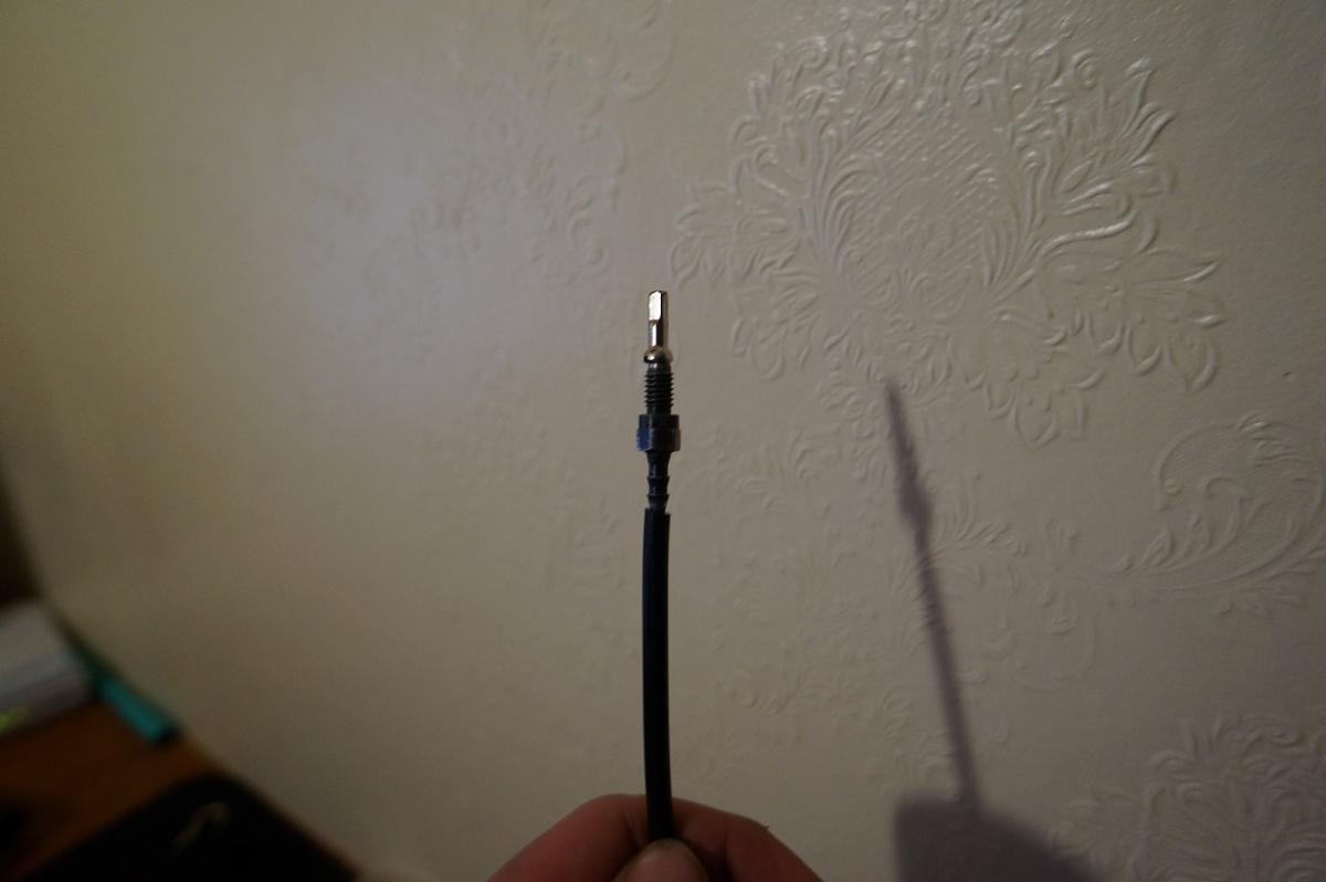

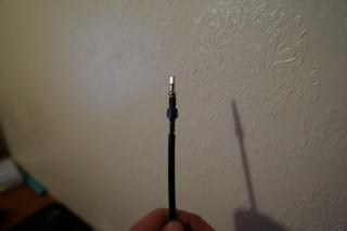

So the title sounds misleading but here is my question.
just bought a bike and the rear mag had a split on the tube on the slave cylingers and i tryed to cut it off than put it back on but the hose did feel like its too hard to put back together. is it normal that the mag hose so hard or it might got old as rubber/plastic and stiffened up? should i replace the whole hose on the mag?
sorry if i misspell something as im hungarian but i do live in colchester and looking for rider mates aswell so if you know some1 let me know too ok? :D
the polyamid used for magura hoses can get brittle from uv radiation,but that effect shows up only after 10+years with bikes that are standing outdoors all the time,so i wouldnt worry.
do you have that "hose clamping thingy" to clamp it in a vice or are you trying to freestyle hammer it in?
