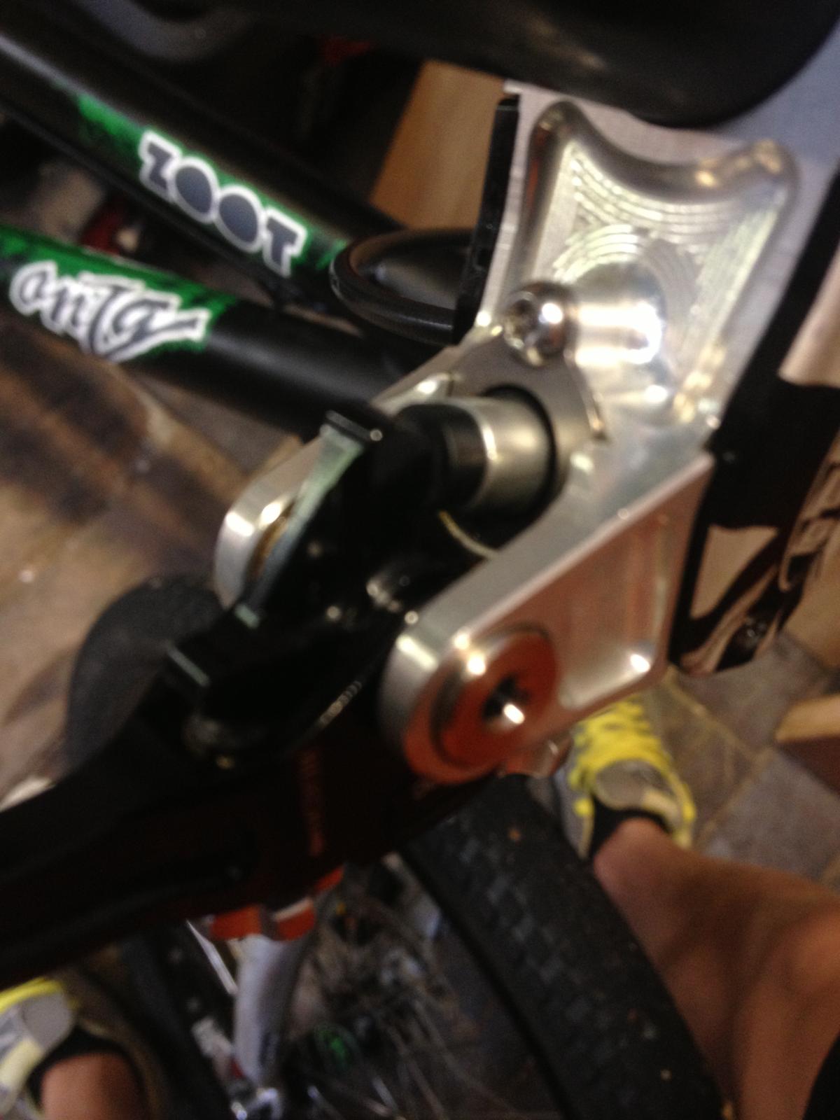

deivijs12 Posted August 16, 2013 Report Share Posted August 16, 2013 Hi i have a problem with my v2's. There is practically no bite in them and allot of movement when pressing the lever before it slowly stops the bike. The brakes have been fully re-bled with 5.1 DOT fluid following the hope help video. Quote Link to comment Share on other sites More sharing options...
Luke Rainbird Posted August 16, 2013 Report Share Posted August 16, 2013 If you're tried the adjustment on the lever and it's still pulling back to the bar (or at least more than it should) then it's likely a poor bleed. Give it another fresh bleed and ensure that there's no air in there and see if that makes any difference Quote Link to comment Share on other sites More sharing options...
deivijs12 Posted August 16, 2013 Author Report Share Posted August 16, 2013 Just re bled them and still the same thing. Is there any chance that the piston assembly on the lever itself could be faulty? There are no signs of leaks or anythting like that. Quote Link to comment Share on other sites More sharing options...
Luke Rainbird Posted August 16, 2013 Report Share Posted August 16, 2013 It's possible but unlikely. Can you post some (decent) pictures of the setup so we can see what's going on? Quote Link to comment Share on other sites More sharing options...
deivijs12 Posted August 16, 2013 Author Report Share Posted August 16, 2013 The file is too big, i took the picture with my phone i have no other way of taking them. Quote Link to comment Share on other sites More sharing options...
deivijs12 Posted August 16, 2013 Author Report Share Posted August 16, 2013 This was the only picture small enough its not great but hope it helps. Quote Link to comment Share on other sites More sharing options...

deivijs12 Posted August 16, 2013 Author Report Share Posted August 16, 2013 I have rebled the brake again. the lever still feels spongy but now stops better is it just supposed to be like that? Quote Link to comment Share on other sites More sharing options...
AkuskaUK Posted August 17, 2013 Report Share Posted August 17, 2013 Mine feels solid and "snappy", send it to Hope and ask them nicely to service it? it could be a sticky piston and/or master cylinder. Quote Link to comment Share on other sites More sharing options...
tom@eastcoasttrials Posted August 17, 2013 Report Share Posted August 17, 2013 get yourself a avid bb7 good cable and a sd7 lever problem sorted Quote Link to comment Share on other sites More sharing options...
UK_SPAWN Posted August 24, 2013 Report Share Posted August 24, 2013 Sounds like u need to rebleed again if its squidgy. .. if your sure its blead correctly it muat be a bent disk or slifhtly out of shape. This makes it feel spongey too. Quote Link to comment Share on other sites More sharing options...
