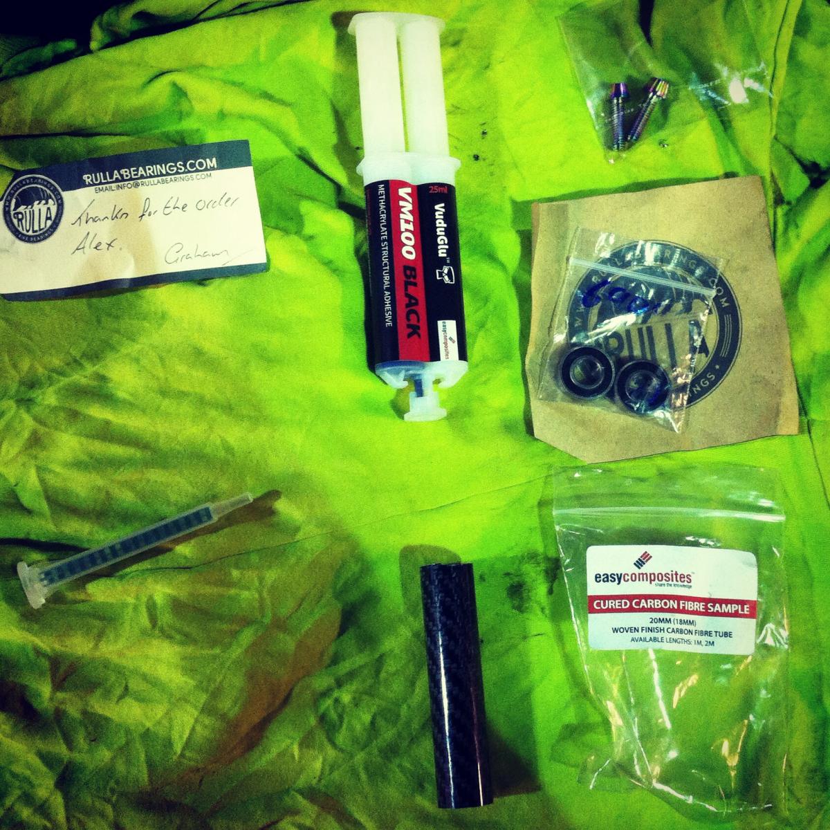

Alex Dark Posted January 17, 2015 Author Report Share Posted January 17, 2015 Packages came , woo! Ti bolts, carbon tube and resin. Bit tight on material haha, just managed to eek out the last of my 7075. Both flanges machined an drilled , axle and spacers and new rim from tarty and I'll have a bike again! 1 Quote Link to comment Share on other sites More sharing options...
SamKidney Posted January 17, 2015 Report Share Posted January 17, 2015 What do you use to bond the Carbon to the alloy flanges? Quote Link to comment Share on other sites More sharing options...
King C Posted January 17, 2015 Report Share Posted January 17, 2015 Click the first photo and once zoomed in, you can see the name of the 2 part resin on the applicator Quote Link to comment Share on other sites More sharing options...
Alex Dark Posted January 17, 2015 Author Report Share Posted January 17, 2015 http://www.easycomposites.co.uk/products/structural-adhesives/vm100-black-methyl-methacrylate-adhesive.aspx Quote Link to comment Share on other sites More sharing options...

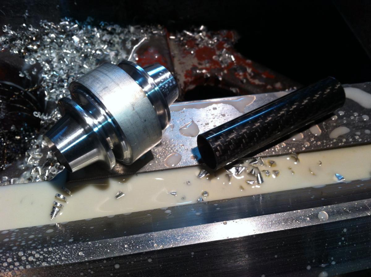

Alex Dark Posted August 1, 2015 Author Report Share Posted August 1, 2015 Soooo, front hub mk2 has been pretty well beaten and still very much in one piece so cue rear hub mk1! Widest flange spacing I could reasonably get away with ( whilst being symmetrical ) M10 ti fun bolts 7075 for shell and axle and spacers 28/30 carbon fibre shell Vudu glu to stick it all together 1 Quote Link to comment Share on other sites More sharing options...
Alex Dark Posted August 1, 2015 Author Report Share Posted August 1, 2015 Keeping things in line after bonding All assembled looking pretty Finished weight 184gr including bolts , which makes it the 3rd lightest Hub on tarty 3 Quote Link to comment Share on other sites More sharing options...

Alex Dark Posted August 2, 2015 Author Report Share Posted August 2, 2015 In reply to jeff, exactly what mark said haha Cheers dman Built it and give it a pasting yesterday and seems all gravy. Loads stiffer than the tr it replaces which is always nice, and far better chain line Quote Link to comment Share on other sites More sharing options...
