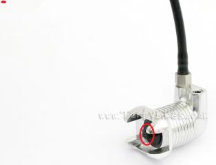

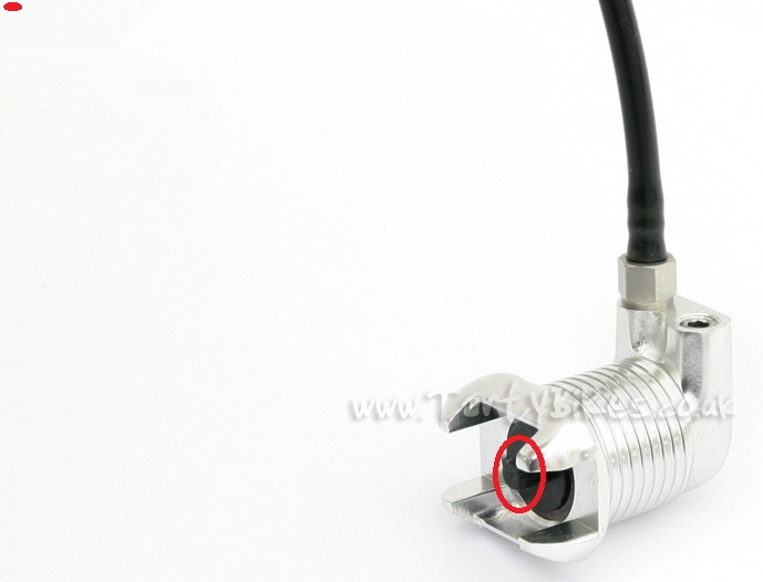

So, decided to swap my 2011 magura for a 05' magura (Not a good decision). Set the brake up and rode it for like 3 minutes and then my brake pad started rubbing. Turned out that the thing that the brake pads sits onto had snapped.
Which left the whole plastic 'nipple' inside my brake pad backing. How the hell do I get it out from the backing?
The "nipple" that I'm talking about is the piece that I've drawn a circle around.
post-30858-0-93806800-1374437578_thumb.j
Melt the plastic with a lighter? You'll need a new o ring and it might discolour the anodising but it'll get rid.
Edit: You can probably pick out the o ring first.
I tried that and the plastic didn't even get soft... I held the lighter there for like 2 minutes aswell..
Gonna try it again now though.
Ok so came up with a better idea!
I took a small and sharp flathead screwdriver and hammered that through the middle of the plastic bit. Which made it crack. So I just took up the bits from the hole and it works perfect now!
