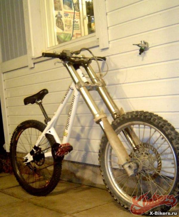

mjewl Posted July 10, 2013 Report Share Posted July 10, 2013 (edited) yeah, so i've just put my new fork on but i need some kind of adaptor for my front brake? which one? this is how it looks now: think i'll should go for another stem now since it is kinda high in the front? Edited July 10, 2013 by mjewl 1 Quote Link to comment Share on other sites More sharing options...

LordMersey Posted July 10, 2013 Report Share Posted July 10, 2013 Interesting set up. But im guessing because its a downhill fork that you will need a 200m, disk? I could be wrong however. Quote Link to comment Share on other sites More sharing options...

dezmtber Posted July 10, 2013 Report Share Posted July 10, 2013 You need a hope post to is adaptor. To fit to that mad mad creation. Please tell me what do you intend riding on it too? I hope you read the setup guide for those forks, there is only meant to be 8" between the seals and the 1st crown. Quote Link to comment Share on other sites More sharing options...
krazykid009 Posted July 10, 2013 Report Share Posted July 10, 2013 It wont run. A boxxer uses it's own special mount that isn't IS anyway, and so a Boxxer to IS adapter just isn't available. On another note.... http://www.youtube.com/watch?v=8TBQywGmMjQ 1 Quote Link to comment Share on other sites More sharing options...
mjewl Posted July 10, 2013 Author Report Share Posted July 10, 2013 (edited) You need a hope post to is adaptor. To fit to that mad mad creation. Please tell me what do you intend riding on it too? strictly street/trials, so damn tired of hurting my wrists while doing drops so i thought i go for a little more plush front... EDIT: haha, jokes aside, i was just bored and had a boxxer lying around... 100% sure that it would work if i just put a 203mm disc up front (source, IS M4 on another boxxer i had) now that it's back to normal i almost regret i didn't fit the fork properly and took it for a spin though. Edited July 10, 2013 by mjewl Quote Link to comment Share on other sites More sharing options...
dezmtber Posted July 10, 2013 Report Share Posted July 10, 2013 Boxxer post mount is the standard post mount. Boxxer is mount is different and does need special boxxer only 8" mounts A hope post to is mount will fit 1 Quote Link to comment Share on other sites More sharing options...
dezmtber Posted July 10, 2013 Report Share Posted July 10, 2013 http://www.chainreactioncycles.com/Mobile/MobileModels.aspx?ModelID=13735 This one. It will make your boxxers into a +20 is same as some trial bike forks. I think your is hope caliper is +20 also so it will need a 203 rotor with this mount. Quote Link to comment Share on other sites More sharing options...
mjewl Posted July 10, 2013 Author Report Share Posted July 10, 2013 http://www.chainreactioncycles.com/Mobile/MobileModels.aspx?ModelID=13735 This one. It will make your boxxers into a +20 is same as some trial bike forks. I think your is hope caliper is +20 also so it will need a 203 rotor with this mount. heh, tanks for the help, but i was merely pulling your leg :/ Quote Link to comment Share on other sites More sharing options...

Blake Posted July 11, 2013 Report Share Posted July 11, 2013 goodbye headtube Quote Link to comment Share on other sites More sharing options...
