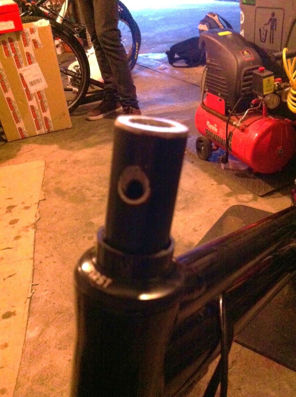

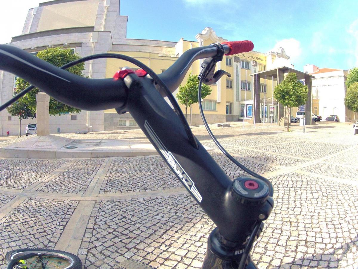

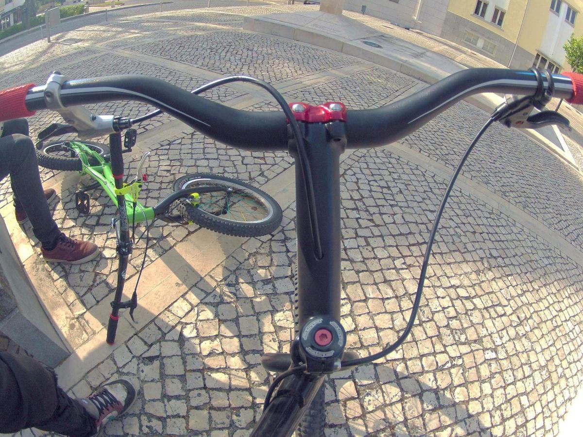

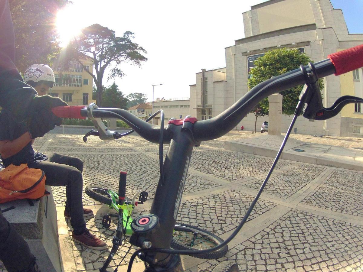

Perez Posted July 3, 2013 Report Share Posted July 3, 2013 (edited) This system is beeing tested for the last year and a half on one of my mates bike, i did this job, as well making a hole on the fork, so the cable pass inside. A year and a half of some bashing-a-lot and street stuff, and no problems yet. The fork is a Echo Urban. It is different from the rest but i really like the final result. Edited July 3, 2013 by Perez Quote Link to comment Share on other sites More sharing options...
Skorp Posted July 3, 2013 Report Share Posted July 3, 2013 Nope. - A guy who have broken forks and stems Quote Link to comment Share on other sites More sharing options...
Martin Reynolds Posted July 3, 2013 Report Share Posted July 3, 2013 This. And for how easy it is to run cables through the steer tube, it'll be a million times safer. Quote Link to comment Share on other sites More sharing options...
BradJohnson Posted July 3, 2013 Report Share Posted July 3, 2013 Oh sweet Jesus. *facepalm* Quote Link to comment Share on other sites More sharing options...

aener Posted July 3, 2013 Report Share Posted July 3, 2013 Cool! That looks sweet. What about running the cable through the bars? There's already a big hole in the stem clamp, and no stress going through that part of the bars anyway... just drill a hole through the bars and run it straight through the stem. It'd tidy up your cable routing a little too, which is never a bad thing with cable brakes. 1 Quote Link to comment Share on other sites More sharing options...
Perez Posted July 3, 2013 Author Report Share Posted July 3, 2013 Like i said, its going strong after a year and a half. If it brokes, i'll post the video or photo, would be fun anyway, ahaha!Cool! That looks sweet. What about running the cable through the bars? There's already a big hole in the stem clamp, and no stress going through that part of the bars anyway... just drill a hole through the bars and run it straight through the stem. It'd tidy up your cable routing a little too, which is never a bad thing with cable brakes. Never thought about that, but the angle of the cable seems to be better on the stem. Maybe someone try that after seeing this thread Quote Link to comment Share on other sites More sharing options...
dann2707 Posted July 3, 2013 Report Share Posted July 3, 2013 That's pretty cool however is it affecting the brakes performance with it being bent around the bars etc? I noticed that my front cable vee worked much better when the cable was as short as possible and with barely any kinks in it from the lever to the arms. (must be the same with a cable disc too, not sure what you have) 1 Quote Link to comment Share on other sites More sharing options...
Perez Posted July 3, 2013 Author Report Share Posted July 3, 2013 The brake works very good, i use a linear bmx cable and there is no friction at all. What is very important is the angle of the holes, so they can run the cables smothly. Quote Link to comment Share on other sites More sharing options...
Canardweb Posted July 3, 2013 Report Share Posted July 3, 2013 Good idea! I wouldn't do it though Quote Link to comment Share on other sites More sharing options...
Blake Posted July 3, 2013 Report Share Posted July 3, 2013 I'm okay with just running my cable in the air Quote Link to comment Share on other sites More sharing options...
dave33 Posted July 4, 2013 Report Share Posted July 4, 2013 Where he's drilled the holes are areas which are under hardly any load. Nice job 1 Quote Link to comment Share on other sites More sharing options...
Perez Posted July 4, 2013 Author Report Share Posted July 4, 2013 Where he's drilled the holes are areas which are under hardly any load. Nice job Yes it is Quote Link to comment Share on other sites More sharing options...
