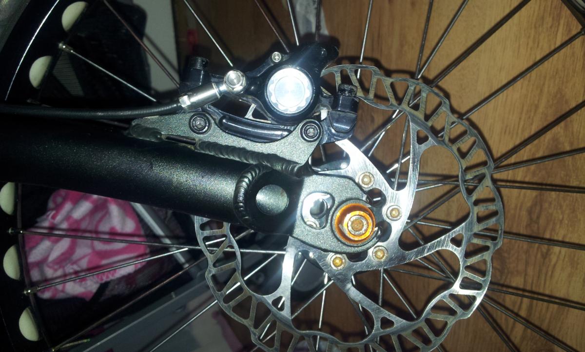

UK_SPAWN Posted June 22, 2013 Report Share Posted June 22, 2013 Hi all, yes its me again I'm going to upgrade the front rotor to 180mm hope saw on my Trial Zone (currently 160mm). Put all the bits together in tarty basket and then went to check the bike and just make sure I'm ordering the correct adapter (adapter F) (on tartybikes it says adapter F is for 180mm front 160 rear) So I look on my bike and see this... "F" How come im running a 160 on an adapter thats application is for 180?? Has it been installed upside down maybe? Here is a picture... (1sec) Quote Link to comment Share on other sites More sharing options...

UK_SPAWN Posted June 22, 2013 Author Report Share Posted June 22, 2013 This is what I have. And it states 160mm on the internet and marked F. I think I have figured out what the problem is. Different manufacturers do not standardise adapter markings, so F from brand X is different to adapter F from hope.. How confusing! Quote Link to comment Share on other sites More sharing options...

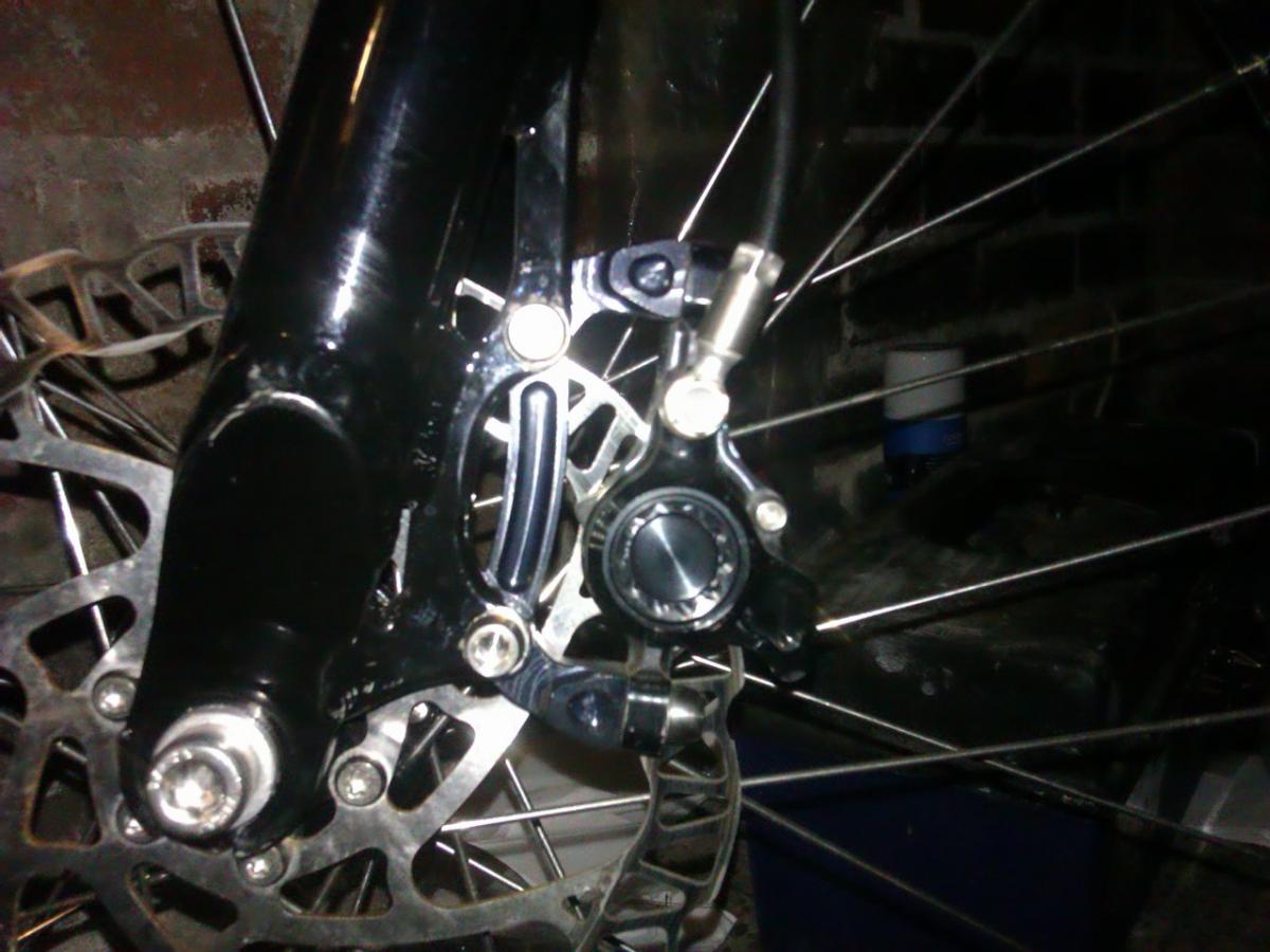

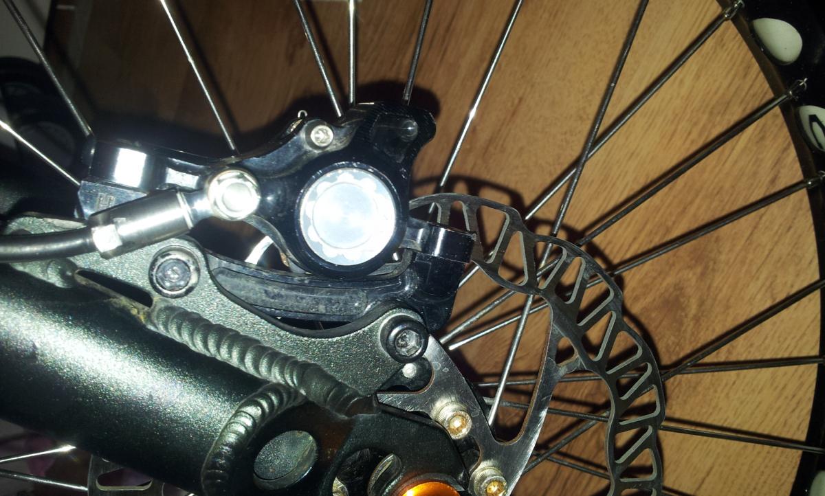

UK_SPAWN Posted June 23, 2013 Author Report Share Posted June 23, 2013 Normal (160mm) how it came: Reversing the adapter provides more space. You may be correct krazykid. Does this look like enough room for 180? Im looking at my rear 180 and it looks like it may just fit... Cheers for the help. Quote Link to comment Share on other sites More sharing options...

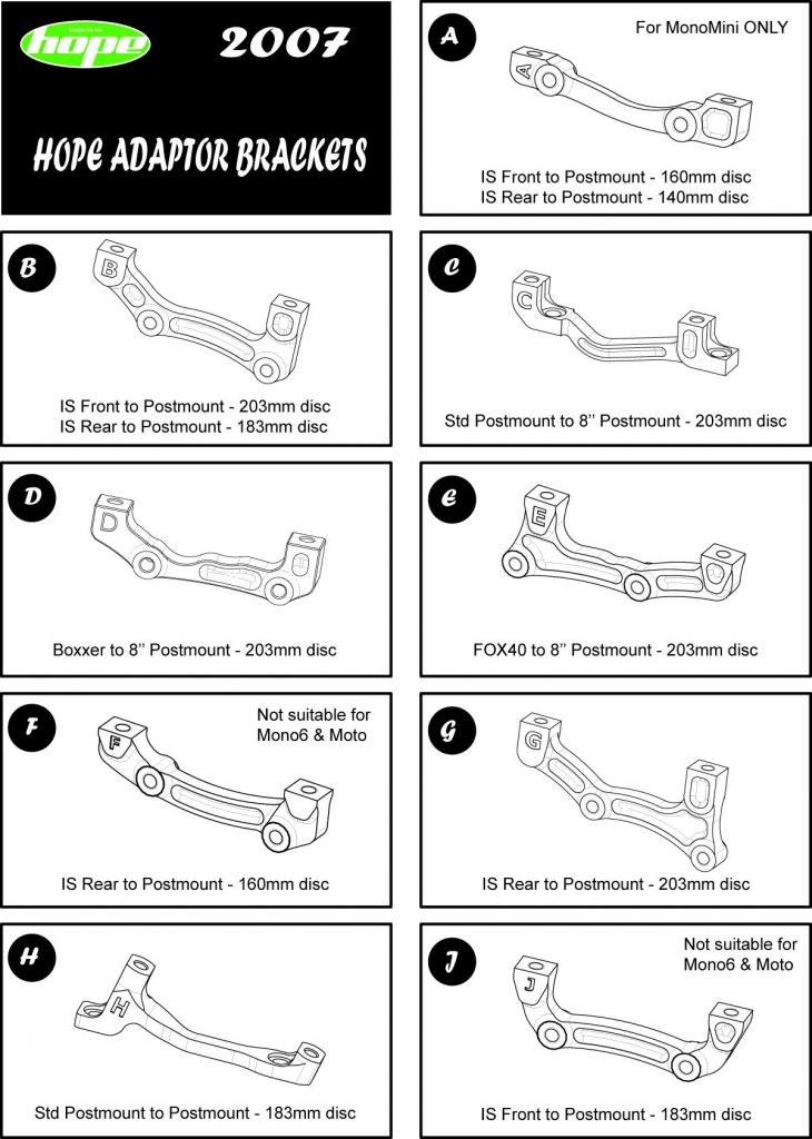

UK_SPAWN Posted June 23, 2013 Author Report Share Posted June 23, 2013 So upside down adapters cancel out the increase in size? So a 200mm adapter used upside down would yield 180mm? I found this chart... I definitly have adapter F, and there it says rear 160? It dosent state any for front 180mm? Quote Link to comment Share on other sites More sharing options...

dezmtber Posted June 23, 2013 Report Share Posted June 23, 2013 If you use the hope 180 trial or trial zone rotor You need the j adaptor for 183mm Quote Link to comment Share on other sites More sharing options...
UK_SPAWN Posted June 23, 2013 Author Report Share Posted June 23, 2013 Yeah I wanted a hope saw but I may just get a 180 trial zone as its designed for trials. Cheers I was just baffled that up side down works because its the first thing I thought but instantly dismissed it as "a silly idea and it would be same other way" I even took it off and quickly lined it up... wasnt untill I bolted it in with the F mark at the top and guesstimated based on my rear rotor that I saw that maybe I DO have the correct adapter, and just by fluke it happens to work on a 160 if used upside down... Seems to be the case. Quote Link to comment Share on other sites More sharing options...
