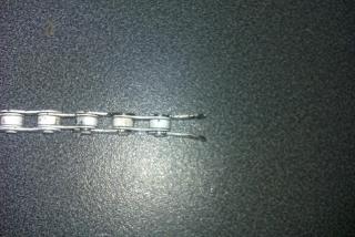

Semaj Posted June 16, 2013 Report Share Posted June 16, 2013 (edited) I was having a wee mess about on the onza rip today and the chain broke..... The only thing i can fathom is it wasn't fitted so well by the previous owner as its fairly new...... What size chain do I need and what's a decent one to buy? Cheers...... Edited June 16, 2013 by Semaj Quote Link to comment Share on other sites More sharing options...

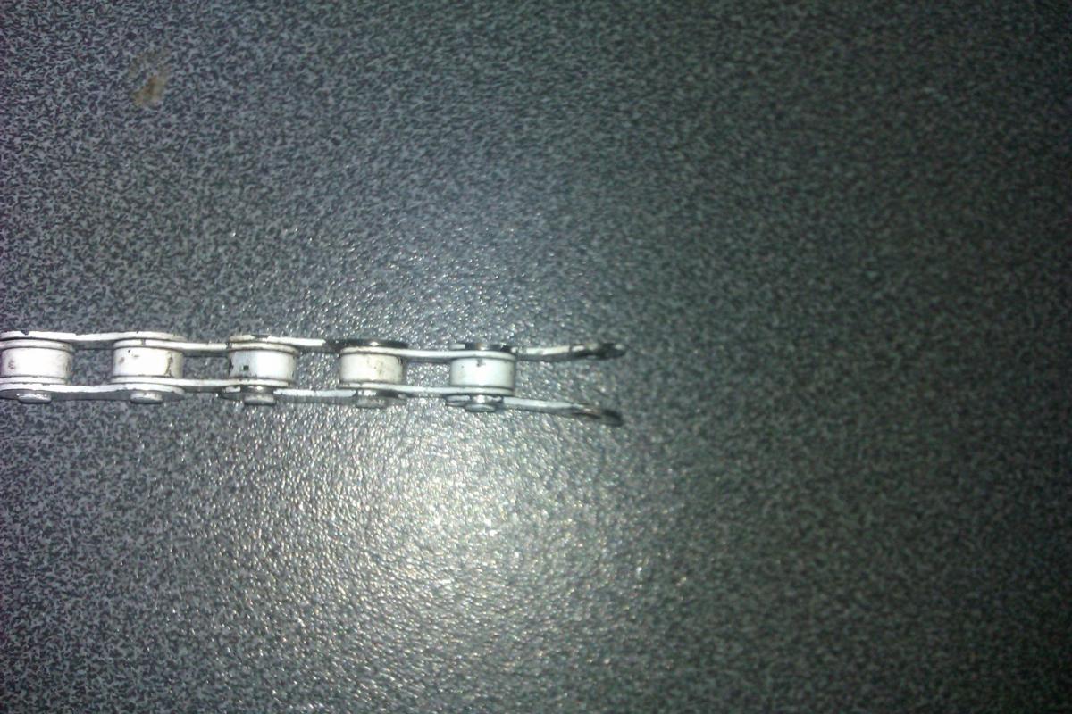

Semaj Posted June 16, 2013 Author Report Share Posted June 16, 2013 (edited) I just watched a video on YouTube of a guy fitting a new chain and all he did was using the tool push the pin in place and that was it.... Is that right?i would have thought it would need riveted at least. I'm still wondering why the hell mine broke,I'll get a pic up later of it as the side plate has bent outward.......this is suppose to be a recently fitted chain . I'm convinced this chain is 1/8th Edited June 16, 2013 by Semaj Quote Link to comment Share on other sites More sharing options...
isitafox Posted June 16, 2013 Report Share Posted June 16, 2013 They don't need riveting, just rejoining with a split link. The ones they come with aren't brilliant so tarty recommend getting one of these http://www.tartybikes.co.uk/chains/kmc_split_link/c7p11014.html instead though they're currently out of stock. Should be able to pick one up from Halfords though. Does that chain have a split link fitted? If not it could have been rejoined and not had the ends of the pin splayed over which would explain it pulling out and bending the plates like it has. As a word of warning if you ride regularly it's advised you get a new chain at least twice a year as they do take some hammer! Quote Link to comment Share on other sites More sharing options...
Semaj Posted June 16, 2013 Author Report Share Posted June 16, 2013 (edited) The chan definitely didn't have a split link fitted so I'm guessing its as you say.....they hadn't been splayed over and has worked it's way out. I've ordered that one you gave me the link to so that will work a treat and at least I know for sure that it's got a brand new one fitted. I can't attempt any tricks just now because of my wrist so there's no rush...... I've just noticed on the link you gave for the split link that someone has asked what size link to buy for a std onza chain and they recommend the 1/8th so I'm confused as that's the size of the chain that broke (I think) The one I've just bought is the 3/32 Edited June 16, 2013 by Semaj Quote Link to comment Share on other sites More sharing options...

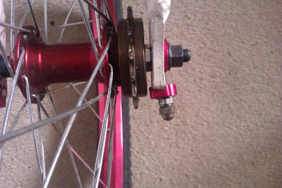

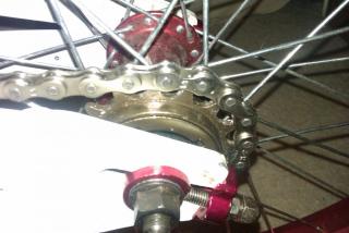

Semaj Posted June 18, 2013 Author Report Share Posted June 18, 2013 (edited) Is this anything to worry about,is it normal for this to bent out like this? The rear sprocket does appear to be straight inline and the rear wheel matches the front Looking at this pic it makes the rear wheel look well out of line but it isn't as bad when you compare it to the front......doesn't look right though does it? I think I'll loosen it off and adjust it equally on both sides and see if that I'm Oves the way it looks.... Edited June 18, 2013 by Semaj Quote Link to comment Share on other sites More sharing options...
isitafox Posted June 18, 2013 Report Share Posted June 18, 2013 Yeah I wouldn't worry too much about that. If they get worse just swap for some Gusset chaintugs which are a bit stronger Quote Link to comment Share on other sites More sharing options...
