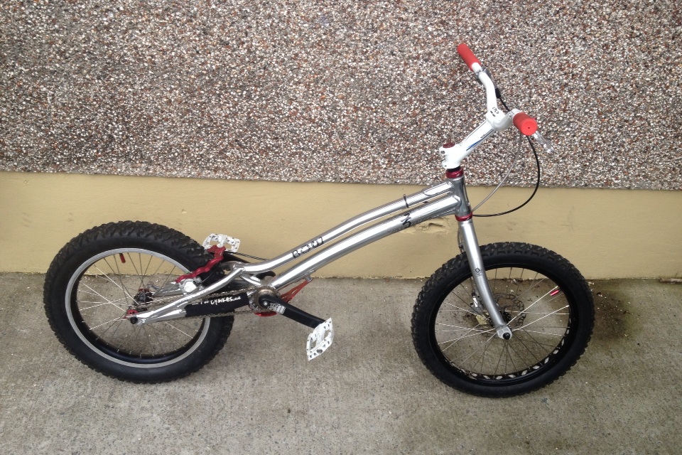

Lrn2Trial Posted June 13, 2013 Report Share Posted June 13, 2013 Can everyone! Who reads this post upload a picture of the angle and tilt of the bars they ride with please I'm new to trials, my trial bike when I bought it had the handle bars already set up, I've started learning the basics but the other day I put the handle bars forward and I felt like i had more control when I was doing a pedal kick for example, But what I don't know is if I'm putting them too far forward, if that's going to stop me from learning new tricks in the future and I won't even realise that them being too far forward is limiting how I can move the bike. This is how they are now Any comments on how my handle bars are now ? Quote Link to comment Share on other sites More sharing options...

Lrn2Trial Posted June 13, 2013 Author Report Share Posted June 13, 2013 Having them more forward does feel comfortable but what I'm trying to get an idea about is, If I never knew how to pedal kick and I had my handle bars really far forward how will I know if its the handlebars or not knowing how to pedal kick is the reason behind it. So if someone else set my handle bars up for me and did a demonstration of the trick showing that its actually possible to do it is then I'd know to keep them like they are and get used to it so any pictures of the way other people have their handle bars would help because I can try and copy there's because it's obviously possible with the angle they are using because they can do the tricks Do you get what I mean ? Quote Link to comment Share on other sites More sharing options...
