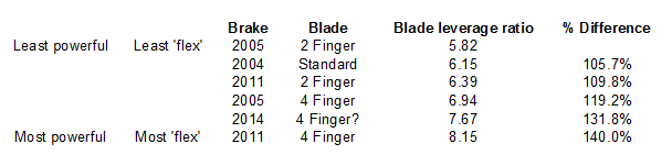

AdamR28 Posted July 18, 2013 Report Share Posted July 18, 2013 I got bored with people slagging off the 'plastic' levers, so here's the reason for the 2011 brakes being 'flexy': 2 Quote Link to comment Share on other sites More sharing options...

dann2707 Posted July 19, 2013 Report Share Posted July 19, 2013 I got bored with people slagging off the 'plastic' levers, so here's the reason for the 2011 brakes being 'flexy': Surely it's not all down to lever length though, the design of the product must depict it's ability to flex more too? Quote Link to comment Share on other sites More sharing options...
AdamR28 Posted July 22, 2013 Report Share Posted July 22, 2013 It's not, but the bodies on the '11 brakes aren't flexy despite being made from 'plastic'. Quote Link to comment Share on other sites More sharing options...

AdamR28 Posted July 22, 2013 Report Share Posted July 22, 2013 Hmm. Probably a 2014 one actually. Of the 'known' brakes I'd go with '05 with 4 finger blade though. Simply because I prefer the lever travel arc with the radial mounted cylinder design. In terms of returns and breakages we've had far far less with the 'plastic' levers, and they do feel good when set up correctly. 1 Quote Link to comment Share on other sites More sharing options...
