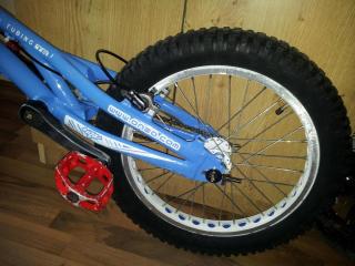

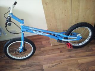

Yeah I'm happy with it. I think everything is standard except the brakes - rear hs33 ('09/'10 i think) and deore disc front. Needed a clean and service but all works fine now. Had to blow out the magura lever piston and rebleed but got it sorted i think. Not much experience with these brakes.
Heres some pictures. I know, too much blue.. thinking some silver bars, stem and fork would look better. Thought about polishing the frame but I don't have the time. Are the standard onza stem and forks steel? if aluminium I'd polish them and save some money. Also might polish the cranks and respray magura calipers.

Thanks fox makes me feel a lot better! I was waiting to get slammed for buying a piece of shit..maybe they are yet to reply.
