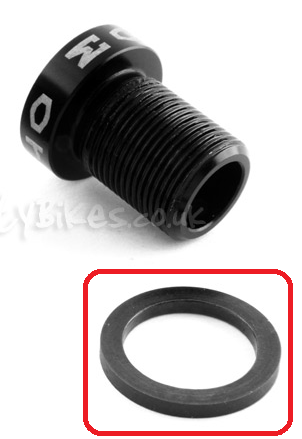

Scoox Posted June 7, 2013 Report Share Posted June 7, 2013 (edited) Yesterday I went ahead and tried to remove my cranks from my old bike to be installed on my new bike. I removed the crank bolts and attempted to remove one side with a crank removal tool. I started turning the tool but it got jammed. Unscrewed the tool off and tried the other crank, exerting as much force as possible. No joy AND I partially stripped the threads on the crank. I took off the crank removal tool once more and looked closer. Then I noticed that the crank bolt washers hadn't come out with the bolt because they had become firmly attached to the cranks after one year of riding. Funny because I had applied ParkTool anti-seize compound. I tried prying the washers out with a screw driver but it wouldn't budge. Surely I am not the first one, so is there a way to get these suckers out? Edited July 22, 2019 by Scoox Quote Link to comment Share on other sites More sharing options...

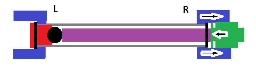

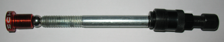

Scoox Posted June 19, 2013 Author Report Share Posted June 19, 2013 (edited) Eventually I used a 105x12mm rod and a 10mm steel ball, along with a crank removal tool. I plugged one end of the crank axle with a crank bolt, inserted the steel ball from the other side, then the rod. The rod was long enough so that it would stick out about 3-4mm past the stuck washer, this way the crank removal tool has something to push on. The diagram below shows the whole thing at work for removing the right-side crank. The green bit is the crank removal tool, the blue bits are the cranks. The black lines are the stuck washers, which are attached to the cranks. The washers may or may not come off. Once the crank is off it's easy to knock 'em out from the inside of the crank using a screw driver. Edited July 22, 2019 by Scoox 1 Quote Link to comment Share on other sites More sharing options...

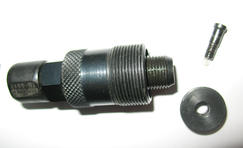

Scoox Posted June 19, 2013 Author Report Share Posted June 19, 2013 (edited) Also, on the crank removal tool, the bit that pushes onto the crank axle is usually held in place by a small screw so it's easy to remove (as shown below). This bit is only needed when pushing directly onto a hollow crank axle, i.e. with the steel rod inside the axle you don't need it, and then there's no chance of pushing against the stuck washer. Edited July 22, 2019 by Scoox Quote Link to comment Share on other sites More sharing options...
AdamR28 Posted June 19, 2013 Report Share Posted June 19, 2013 Good solution Lesson learned though, always check inside the cranks before using the crank puller tool! The washers get held in place by surface tension of the grease, then when you use the crank puller it deforms the washer and it sticks in the crank... It will come out with some careful tapping, though. Quote Link to comment Share on other sites More sharing options...
