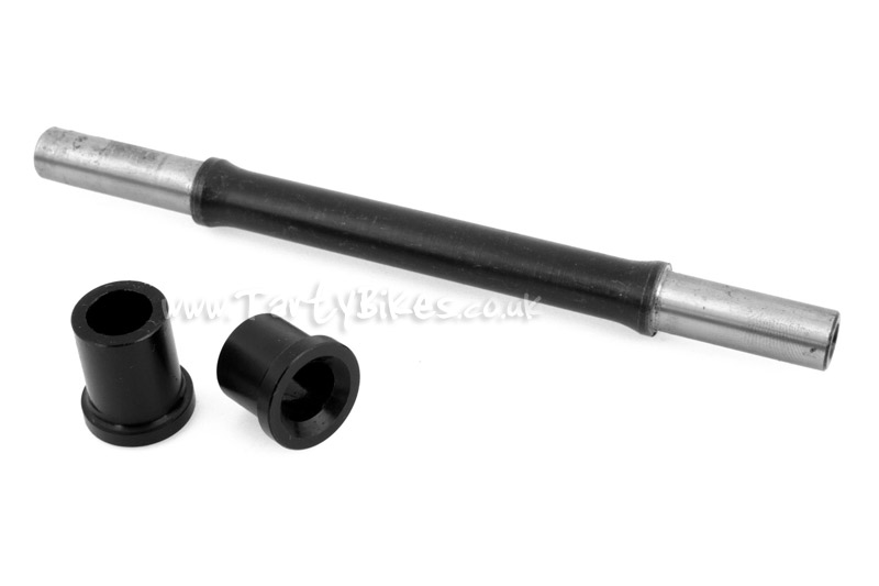

UK_SPAWN Posted May 28, 2013 Report Share Posted May 28, 2013 Are you running spacers/washers on drive side to improve chain clerance? Quote Link to comment Share on other sites More sharing options...
ashleys sugden Posted May 28, 2013 Author Report Share Posted May 28, 2013 yeah, there is a wider one on the non drive side, but shorter on the drive side. these spacers here! Quote Link to comment Share on other sites More sharing options...
UK_SPAWN Posted May 28, 2013 Report Share Posted May 28, 2013 No I mean any additional spacers... if not then its not that Quote Link to comment Share on other sites More sharing options...
ashleys sugden Posted May 28, 2013 Author Report Share Posted May 28, 2013 i did just to try and see if it was better. but i took them out again. Quote Link to comment Share on other sites More sharing options...
Muel Posted May 28, 2013 Report Share Posted May 28, 2013 Do those spacers have any knurling to help them grip the dropout? If not you could try using some knurled washers in there, like these: http://modelenginenews.org/gallery/images/knurl_samples.jpg 1 Quote Link to comment Share on other sites More sharing options...
ashleys sugden Posted May 28, 2013 Author Report Share Posted May 28, 2013 not the spacers are not like that. should i cut some grips in them? Quote Link to comment Share on other sites More sharing options...
Blake Posted May 28, 2013 Report Share Posted May 28, 2013 not the spacers are not like that. should i cut some grips in them? will help a lot as it digs into the frame and grips a lot harder. 1 Quote Link to comment Share on other sites More sharing options...
Muel Posted May 28, 2013 Report Share Posted May 28, 2013 Probably won't help, as the spacers are aluminium and so are the dropouts, I'd order some of these if I were you. In fact I once had some in the shed and I think I used them to solve this problem, but it will have been about 5-7 years ago so my memory is a bit hazy haha. Either these: http://www.ebay.co.uk/itm/170852007642 Or these (but they may be too aggressive): http://www.ebay.co.uk/itm/370820758607 If you put them in between the dropout and the hub, and on the outside between the dropout and the hub bolt and lamp them up tight, it should sort it. Quote Link to comment Share on other sites More sharing options...
