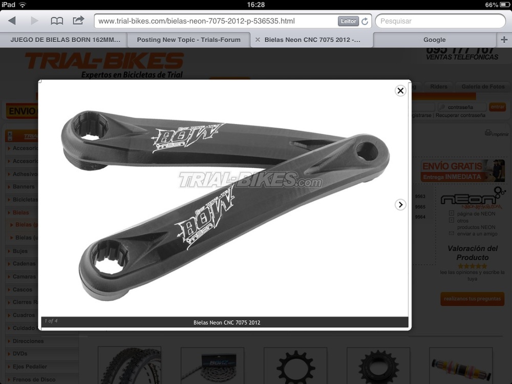

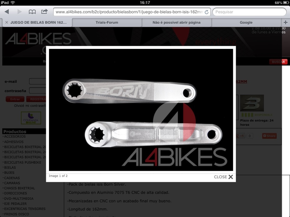

Perez Posted May 24, 2013 Report Share Posted May 24, 2013 Just changed the frame recently, and my Rockmans cant take the ring protector at the 165mm size. Both Neon and Born are 162mm long, does anyone use them with a ring, or have any ideia if they can take them? I cant find any info about this. Thanks in advance. Quote Link to comment Share on other sites More sharing options...

JamieWilliams Posted May 24, 2013 Report Share Posted May 24, 2013 (edited) I could be wrong but I think it was Jamie Williams who I remember had/has a pair of those. Might be worth trying to contact him. Not sure though Yeah i have the top ones, They don't work with 5mm bashrings but the try all http://www.tartybikes.co.uk/bash_rings/tryall_symetrik_2012_drilled/c1p11911.html works as it's 3mm I made my Trial Tech one a bit thinner and had plenty of threads then but these crank feel really flexy i wouldn't recommend then Your Best bet would be these http://www.tartybikes.co.uk/cranks_pair/trialtech_sl_forged_isis/c514p12111.html hope this helps Jamie Edited May 24, 2013 by JamieWilliams 1 Quote Link to comment Share on other sites More sharing options...

Maxx Posted May 25, 2013 Report Share Posted May 25, 2013 these crank feel really flexy in which way? I'm going to build a very light bike and I was looking at these cranks but the weight afraid me a bit (compared to others light cranks) Basically I was looking between these cranks and the new echo sl. (in 172mm and 170 or 175mm) Quote Link to comment Share on other sites More sharing options...
Thehiphopsolidier Posted May 25, 2013 Report Share Posted May 25, 2013 It flexes sideways alot, go for SL. Quote Link to comment Share on other sites More sharing options...
Maxx Posted May 25, 2013 Report Share Posted May 25, 2013 Thanks ! And is it very flexy compared to Try-all cranks ? I don't know if you ever rode with them but these are the only cranks I've ever used. Quote Link to comment Share on other sites More sharing options...
