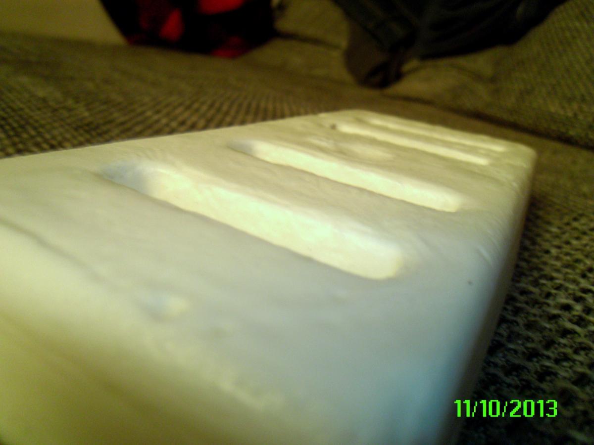

has anyone made his own pad refills?

you should wait for the next batch i ordered the resin for yesterday,as i said all the pads turned out to be best on a smooth rim.
the super hard ones work on a harsh grind,but you dont wanna clean your rim every few hours riding,the aluminium hydroxide filler makes fills the grind up.shame,they hold great.
and you´ll end up with a white rim and a bad bite...
could be different for different rims though,i only had mine to test,an atomlab GI
i said it several times,the pads are still in their baby shoes,but i will keep doing this over the winter and later models will be better in terms of performance.

update:90a resin turned up today.
as i speak the first set is curing,so curious of the outcome!
in the meantime i thought about evacuating the resin while in the mould,with a vacuum pump(in a glass exsicator).
would make the stuff even tougher not to have microscopic bubbles in it.

i know about the problems with evacuating resins,they literally begin to boil below 760mm hg.
just found out,while watching my mould a few times,that the new resin takes longer to cure and is liquid like water,so it could be possible for me to not having to evacuate,cool!
the first batch of pads(from which i have a few sets left btw ;))was pretty compact and most of them bubble-free,so atm i´m looking forward to it to work as desired :)

right now i got a new problem:90a seems to be "plastic hard",weird,anyone got some tnn lgm and can tell me about the consistency of th rubber?

echo snowies are softer than the new ones i made,need to test them now.
kind of confused now,the 90a mix seems to be so hard that it literally polishes the rim,and no power at all.
now i´m stuck until the softening agent arrives,then i can find my way down to the right shore hardness.
theres definitely a line,when you cross it all advantages of the pads are gone...

it didnt.the only way to solve cured polyurethane is to re-cure it with isocyanate.so i took pads from the old batch which broke while demoulding and were to soft.and powdered them,thought i could soften up the compound with mixing that powder in.
i have the vague suspicion i need an urethan rubber,echo cnc refills seem to be made from something like that.but first i´ll try a softener to not having to bin my whole resin,have 80% of that stuff left lol
