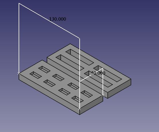

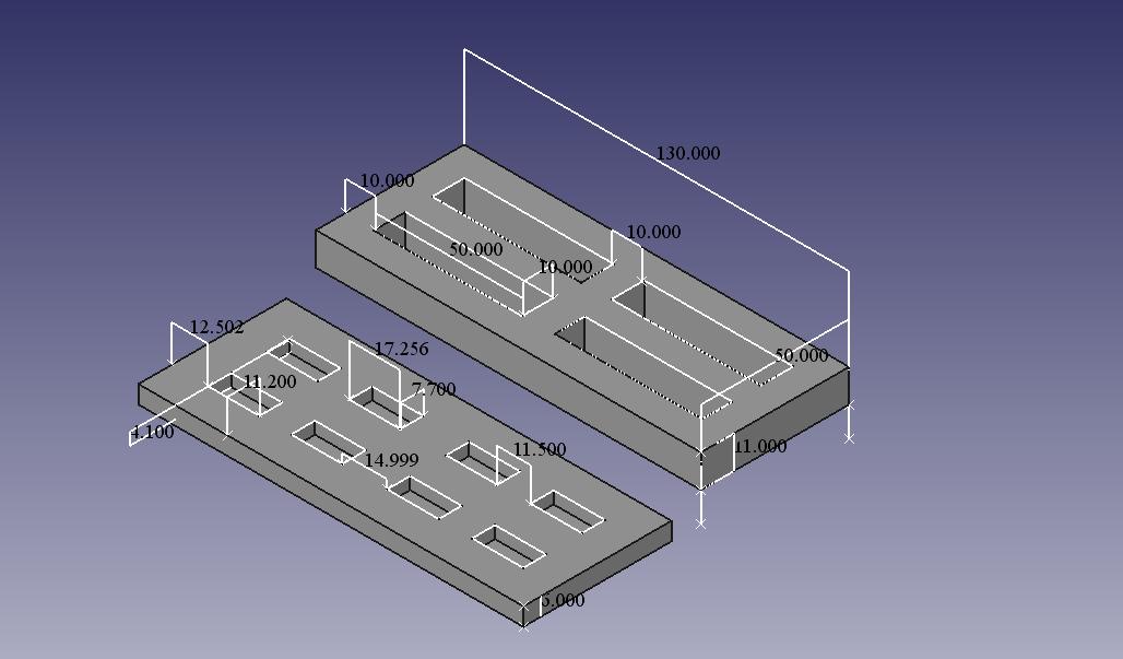

FamilyBiker Posted September 5, 2013 Author Report Share Posted September 5, 2013 (edited) thats the mould i hopefully will get. its 2-piece,i just didnt put the bolting holes in the cad file. the 2 blocks bolted together give the shape of a big echo refill(can be cut to every other backing)after the curing process you´d just unbolt it and pop the pads out like icecubes.tadaaa! edit: for those who want the measurements Edited September 6, 2013 by FamilyBiker Quote Link to comment Share on other sites More sharing options...
