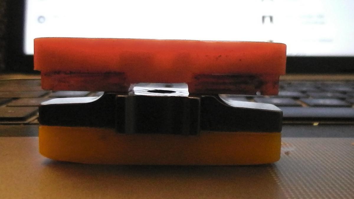

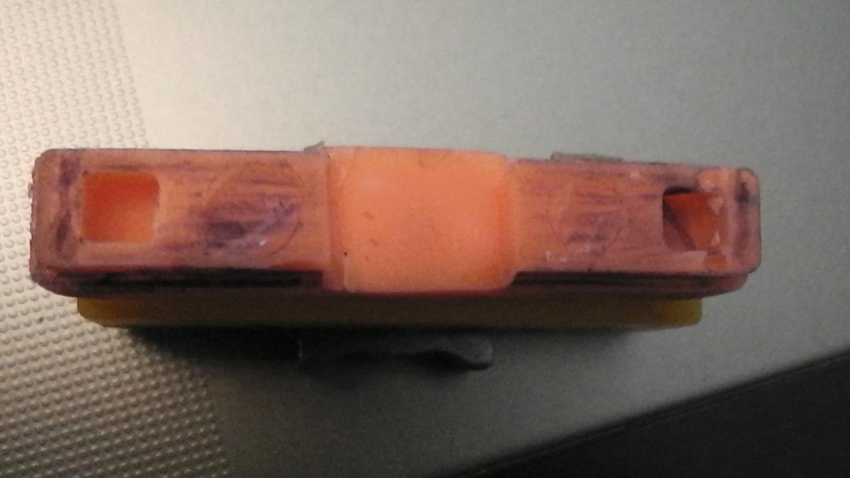

bee's wax worked a treat :D rigged a quick mould (type thing) together with some g clamps and some cut up laminate floor (leftovers), just so i knew what the 70a compound was going to be like...the wait for me to get a proper mould together was going to be too long with me being an impatient twat.
frankly i could have done a much better job, but this was more about 'knowing' than anything else.
performance is bang-on other than the squishiness of the pad it's self, i'm aiming towards a pad for a smooth rim rather than a ground one (grind in the pic is dead) but they won't last overly long on a grind, that said for how much the mix cost vs how many pads it makes its viable to run a grind too from a cost perspective.
anyhoo...any PU gurus on here? are there and additives i can add to the mixture before moulding to reduce the amount of compression the end product has?
abuse opinions are welcome on my piss-poor effort :)
