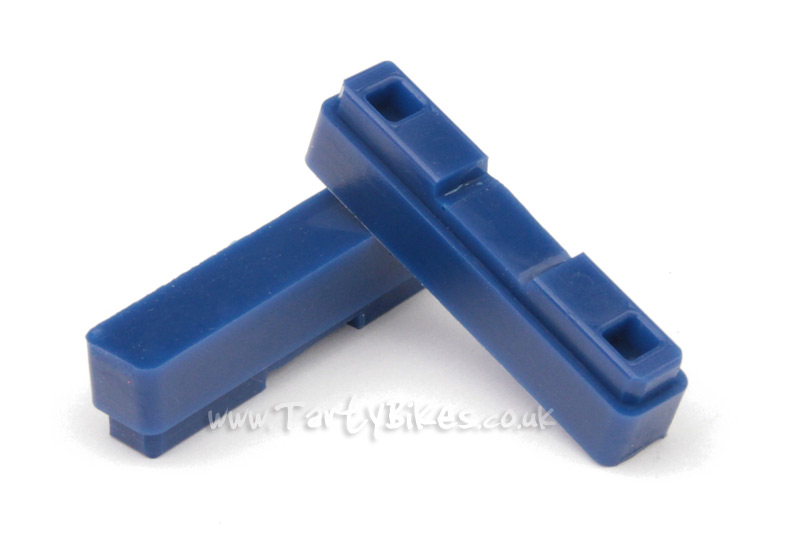

Perez Posted May 28, 2013 Report Share Posted May 28, 2013 Maybe a little of topic, but i know from a trusty source that Samuel aka Rockman put the pads on the microwave until they get the hardness he was searching for. Weird, but kinda workout, because the blue Rockpads are damn good! Quote Link to comment Share on other sites More sharing options...

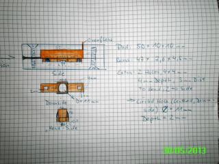

FamilyBiker Posted May 30, 2013 Author Report Share Posted May 30, 2013 (edited) bit of an update here,taken measurement of a viz pad i removed from the plastic backing with the oven method. if anyone needs the measurements: dont know if its worth the money,but to get the mould 3d-printed would cost me 60euros,very tempted... would be cool if someone could do a solidworks or freecad file for that,i´m too stupid for using that software lol edited for spelling correction Edited May 30, 2013 by FamilyBiker Quote Link to comment Share on other sites More sharing options...

FamilyBiker Posted May 31, 2013 Author Report Share Posted May 31, 2013 (edited) very cool,thanks! would it be too much to ask for a negative of the shape,too? with that a 3d printer could print the mould.i´d like to make a mould that has holes in that shape with the funktion of that icecube maker things,to fill it up with resin. it wouldnt need the circle hole on the underside,just a straight 11mm wide distance like heatsink pads have would do the job... Edited May 31, 2013 by FamilyBiker Quote Link to comment Share on other sites More sharing options...

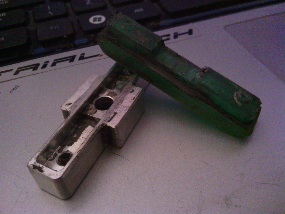

trials hoe Posted June 2, 2013 Report Share Posted June 2, 2013 snip have you measured all the recess area of the backing/pad? i'm looking into getting some of the 2 part mix stuff, making a mould but i measured my pads/backing at 7mm (internal with of recess of backing and external of the pad) then looked on tarty and they say 8mm. i don't have any other backings to measure for reference and don't want to make pads that'll only fit my backings, just unsure if i have odd pads and backings (unsure what they are got them from the f/s on here, will attach a pic if someone could identify them for definite that would be cool ) also i worked out the area:weight of my pad and the 250g (x2) mix i'm going to get about 70 pads from the lot with 10mm of material (by my maths*, so it'll probably be way off ) don't want to make X amount of pads the wrong size so if anyone can clear up the size (width) flap i've found my self in, that'd be cool...then i can crack on making a mould Quote Link to comment Share on other sites More sharing options...
FamilyBiker Posted June 2, 2013 Author Report Share Posted June 2, 2013 if we make them,say 48 x 8 x 4,7mm it´d fit any backing with sanding material off,always better than a pad thats too small lol the middle cutout is 11mm,if we make it 10 its cuttable to 11(power pad backings)and fitting to echo,tnn and so on. i played mindgames of getting some modelling clay and press the refill into it to make a negative,then bake it to harden it. the 3d printed version would be more pimped though... Quote Link to comment Share on other sites More sharing options...
trials hoe Posted June 2, 2013 Report Share Posted June 2, 2013 yeah, make them for the biggest fit backings, then cut them down for others sounds like the right approach i've measured everything up, i plan on making a negative out of wood, then make a mould from that with some of the 2 part mix stuff, then use that as the mould and will still have an original negative to make another from if i ruin it...which probably will haha not sure if i should go for a harder or softer compound mix than the pad material for the mould it's self yet though. Quote Link to comment Share on other sites More sharing options...
FamilyBiker Posted June 2, 2013 Author Report Share Posted June 2, 2013 (edited) i think harder is better,try epoxy resin for the mould.if its the same material the hardener will probably remelt the surface of your mould. other thing i thought of was tempering the finished pads for 4 hours at 80°C in an oven,big companies do that in cases where abrasion applies.(thats probably that microwave process mentioned earlier) if they shrink a few 10th of a mm during that its better they were too big before lol Edited June 2, 2013 by FamilyBiker Quote Link to comment Share on other sites More sharing options...
