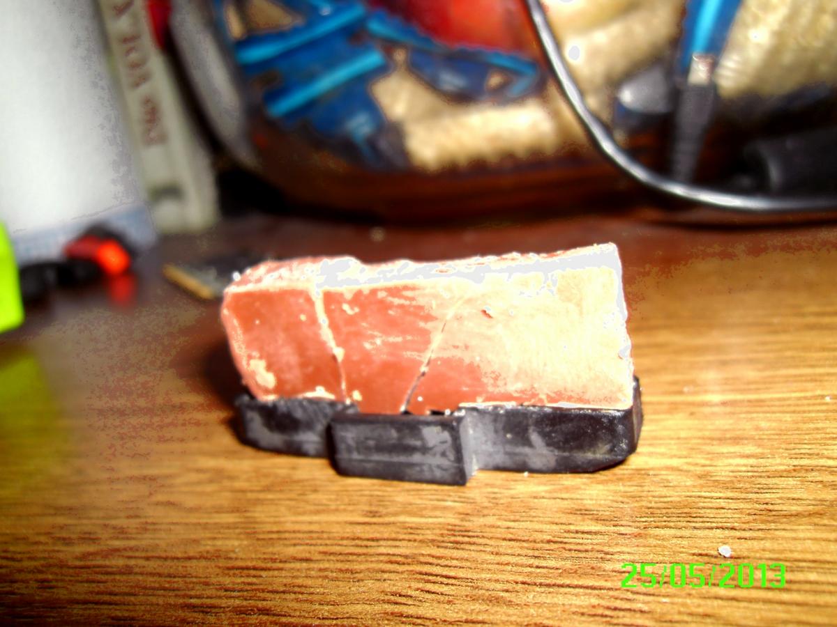

so far i only experimented with the chocolate compound shown here:
post-30389-0-40845300-1369493185_thumb.j
the problem was,this stuff tasted so good that i ate it all,before my rim had the chance to...
:wink2:
