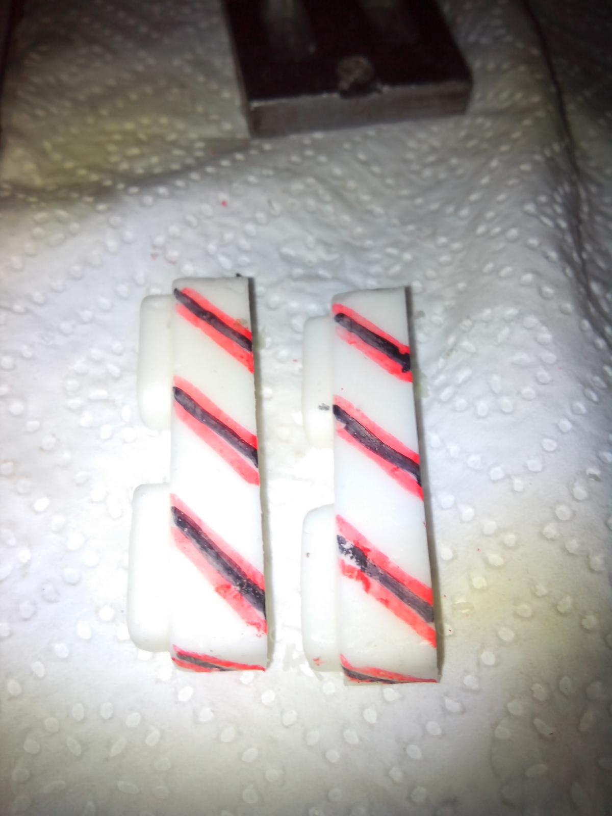

first,has anyone had some success with his pads yet?
second,i proudly present the first crash test dummies of my new batch.
they are great consistency-wise,exactly like my viz pads.
just need some test backings and a test ride

The 70a ones i made work rather well (smooth rim) imo sure i posted a couple of pairs out some where maybe, getting all the air out is a pain! also still need a mould too :( just been making blocks and cutting it in a bodge of straight edges and g-clamps and trying not to slice myself open haha. Anyone's welcome to a set of my offerings should they want some (Y)
  • Like 1
Blackpool rock pads?
not really,i just wanted to give em this "crash test" look and had no yellow marker haha
if anyone has some old metal backings laying around i´d more than apprechiate them :)
for the mould i´ll probably get someone to 3d laserprint me one
