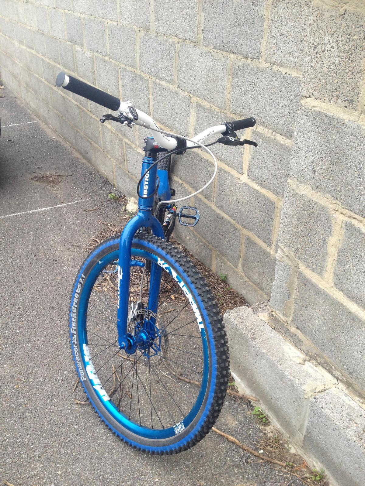

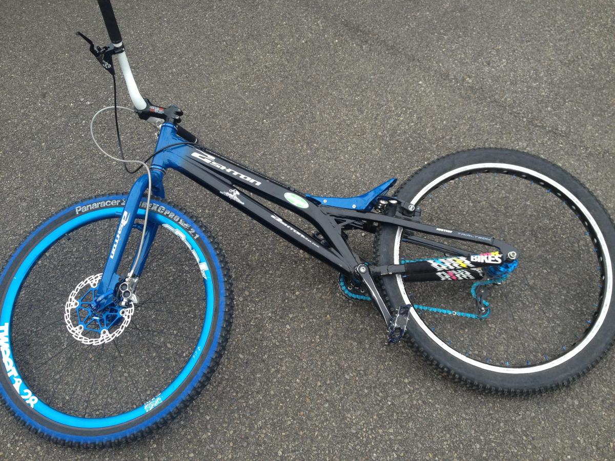

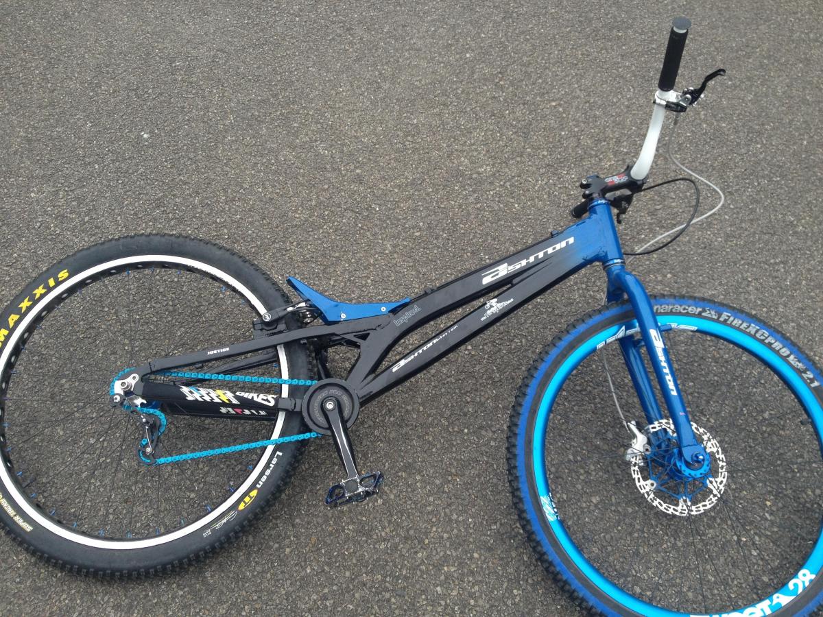

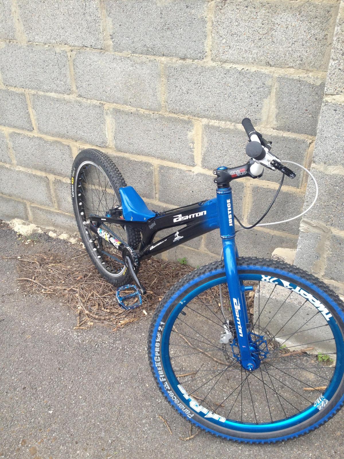

Well, my first post in a while - my last was many years ago asking people to keep an eye out for my stolen Ashton Justice...fast forward to a few weeks ago and a friend and I decided to give the old trials another shot! An Ashton frame on eBay, a helping hand from Tartybikes, a couple of tins of spray paint and voilá...this old guys trials passion is reborn!
The Spec:
Frame Set
Ashton, Black framed edition, resprayed Black / Blue, stickers printed and re-applied.
Ashton Forks, red, re-sprayed blue.
Wheel Set
Front and Rear Hope Pro2 hubs,
Front laced to a Spank Tweet rim, Rear laced to a black Inspired rim - anodized rim was very schlippy in the wet, so light grind applied.
Front Panaracer tyre - purely aesthetic....rear Maxxis Larsen TT.
Trialtech long tensioner.
Brake Set
Front - Hope Tech Evo M4 braided hose with Saw Rotor
Rear - Magura Trials Edition HS33 with Echo booster.
Drivetrain
Middleburn RS7, 175 length
Rear gusset 18t Sprocket.
Spank candy blue DH chain.
DMR V8 "sick edition" pedals.
Twin DMR chainstay protectors...
Steering
Hope headset, with Hope head doctor.
One23 stem.
Trialtech Handlebars & Foam Grips

Ha yes, it does need shortening, its not a simple chain however, the links are alien to me, so rather than get mad, i just ride, it currently works well so until she snaps or i bend the mech hanger i shall just keep it like that :).
Was good meeting you too Ross - no problem at all!
Hi, nice bike had an Ashton myself although the newer effect. You've got a half link chain on there, break it/rejoin it the same as a regular chain. :)
P.S: The chain is, as far as I can see, is on upside down and back to front.
