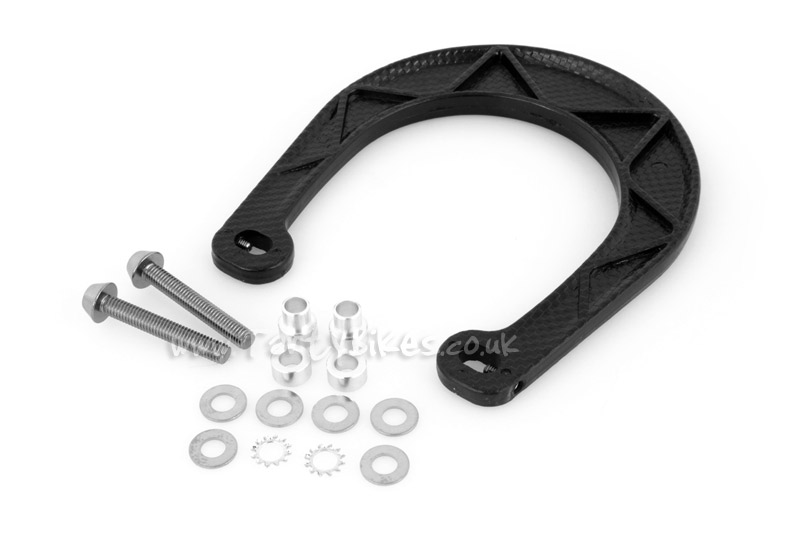

Sam Song Posted April 14, 2013 Report Share Posted April 14, 2013 Well, my Magura finally died yesterday. In my four years of riding, I don't think I was ever completely satisfied with Magura rim brakes to be honest. I always had to bleed, move the calipers in, it was just such a pain in the ass. So I decided to try the V Brake in the rear. It is to be used on a 2009 Zoo Piranha Long, and I'm just deciding on which parts to get. Lever: Avid Speed Dial SL Cable: Odyssey Linear Slic Race cable (loved this cable with bb7) Arms: Avid SD7? Adaptor: Heatsink? Onza? Not too sure what to get Booster: http://www.tartybikes.co.uk/images/custom/brakes/large_brandxbooster.jpg The only v booster on Tarty. Since I don't have any experience with V Brakes, I just have a few concerns: - How easy is it to set the v pads square to the rim? It's not like Maguras with Echo TR clamps which do that for you. - Do V arms matter at all? I can get used a used Shimano Deore V locally: http://www.pinkbike.com/photo/8517553/ or an SD7 arm from Ebay. - How much weight gain usually by going v brake? - V brakes have less bite and how much less is it? I've always used the mineral oil in Magura HS33s, so it's not like I'm coming from the superlight water bleed maguras. - I hated bleeding my Magura every 2-3 months, is there any maintenance work involved with V brakes? I know it's a lot of questions, but I have no experience with the v brakes whatsoever. Although I do love my bb7 brakes. I do see Mr. Stan Shaw using SD7 arms! http://www.trials-forum.co.uk/topic/148109-rockman-slate-2/ Quote Link to comment Share on other sites More sharing options...
ghostrider88 Posted April 14, 2013 Report Share Posted April 14, 2013 Shimano arms are better in general, setting them is easier than setting magura and they have a lot better hold. heatsink or neon adaptors, rest of those parts is ok. All you need to know. Quote Link to comment Share on other sites More sharing options...
Blake Posted April 14, 2013 Report Share Posted April 14, 2013 yeah people who use avid arms say they developed play. I ran deore arms on the front for the short time I was front V, I thought they were very good. Quote Link to comment Share on other sites More sharing options...
Sam Song Posted April 15, 2013 Author Report Share Posted April 15, 2013 Okay which Shimano arms do you recommend? LX version? XT? Alivio? Quote Link to comment Share on other sites More sharing options...
ghostrider88 Posted April 15, 2013 Report Share Posted April 15, 2013 You say you can get deore, so get it. Higher models are only a bit lighter not better in terms of braking. Quote Link to comment Share on other sites More sharing options...
