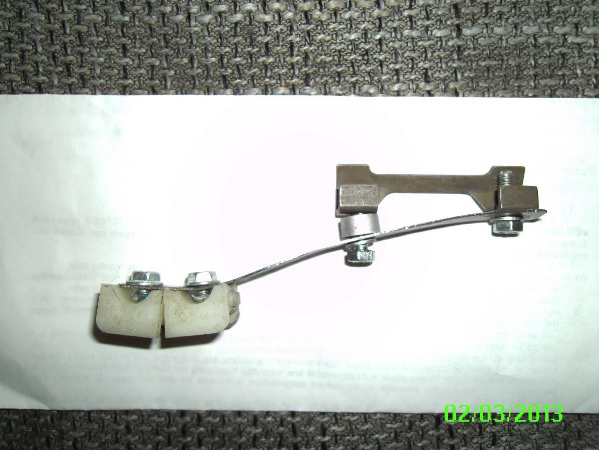

dcd didnt work as good haha.
basically i took an old sawblade an some random plastic.drilled the sawblade,cut it to the lenght required,then filed the plastic thingy to hold the chain sidewards(right term?),then bolted it to the sawblade,which i heated and bent before to have the tension i wanted.
you´d just have to ziptie it to the chainstay as you havent got a mount for it.

Home made here, a little more involved than a 74K design though, works perfectly though, cannot be hit and weighs very little :)
Never had any joy with spoke tensioners, my cs length and gear ratio just don't work out well enough.
  • Like 3

I love the look of this, might have to try that if my 74kings breaks :D
