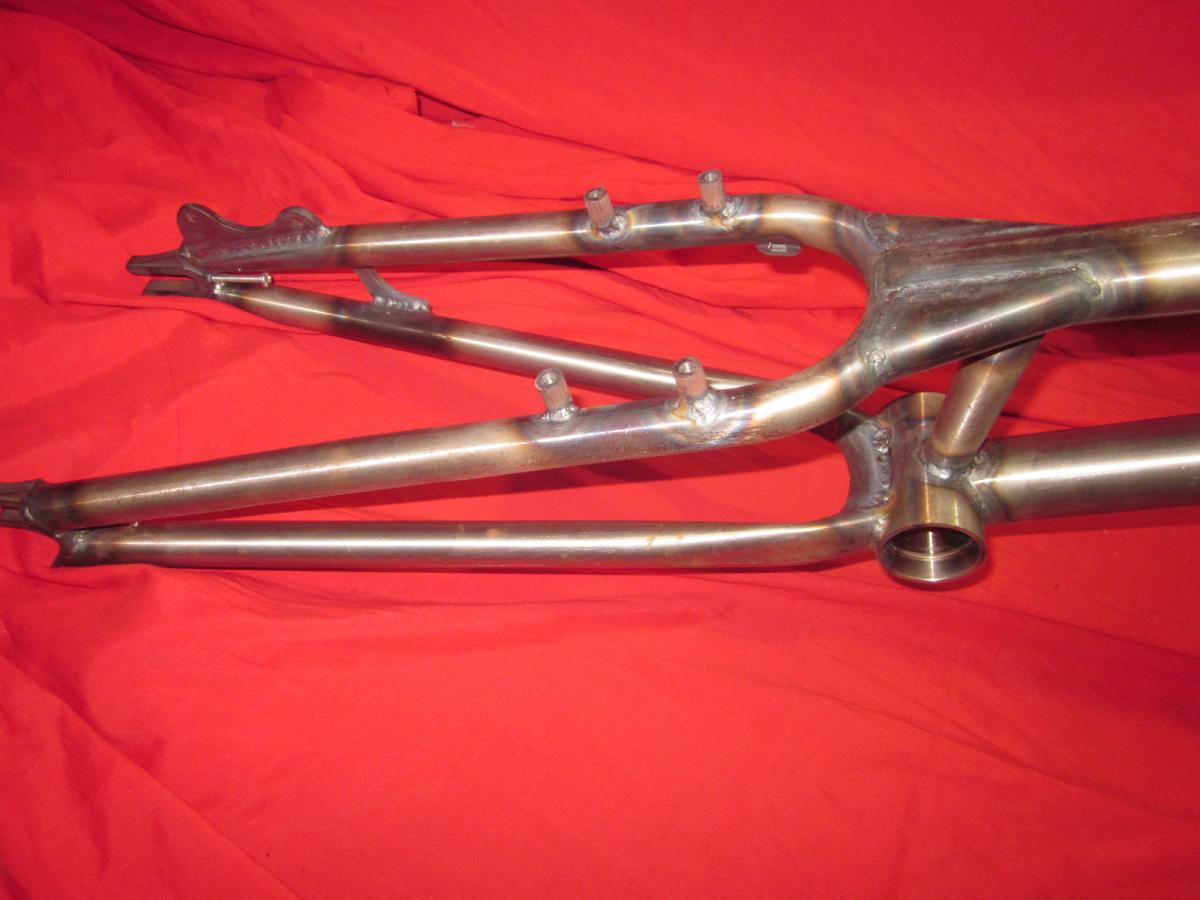

as marino said it in a simple way,it makes it stronger,and especially more durable.
josh,noone didnt mention the treatment procedure thats used,its normalization,then tempering.in germany we have the DIN 8580 norm for welded steel constructions,it says that the tensile strength goes down aprox 10% near the haz,with normalization this negative effects are gone.
in every welded construction are haz-related weak points.
the idea came with the need to treat fork legs with the new alloy,he had to glow them smooth(right term?)to bend them,as a result he and me tried it on a frame.
youre a welder,too,you surely know about whats likely to happen if you dont have those holes:
"cold" surrounding air,hot(500+C°) air inside the tube,expanding to twice the volume.
i´ve seen tubes making "plop" and having a crack over half the lenght after that.
no offence,but i thought welders have to know that stuff.
you didnt answer my question about the colour isitafox,will it change?

all BMX frames use Heat treatment, aluminum use heat treatment koxx, monty, DH INTENSE and more..
is more strong, im use CR-MO 4130 doble butted,
the welding heat affected part, the treatment all uniformly homogenized.
to a certain hardness in HRC.

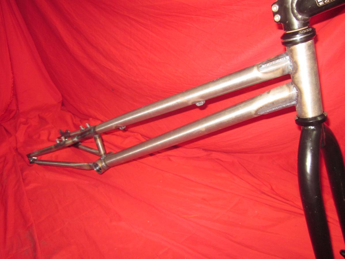

Thanks for viewing my work, I am freer to resume my orders, full custom.

Some Bmx companies do go down the route of heat treatment, yes, but not all as Ali has shown. All aluminium frames have to be treated due to there post-fabrication properties and that's a fact (trust me, I've tested it out before).
I don't disagree that it has it's advantages, but I feel that it's only an advantage if used for the correct aplication. Yes, drag/funny cars may need them, but have you ever seen a trials rider doing 300+mph with a jet engine on their back? Little bit more force going through their frame work.
I have no quarrel with you supplying it as an option, but when you're pushing it as neccessary to people that are close to me socially and then taking over 4 months to produce something that should take a matter of days because of it seems wrong to me.

Ok, it sounds more than acceptable with the forks if you're having to anneal them before fabricating begins, but keep it with the forks. He's been making cro-mo frames for a few years now and has had very little problems with them un-treated.
Fair enough, I've never had this problem with such a small interior volume (in fact, I've never had this problem whilst I've been fabricating).
I understand what that link talks about but they're basing it on steel frames being built for race cars, dragsters and motorcycles.
This.

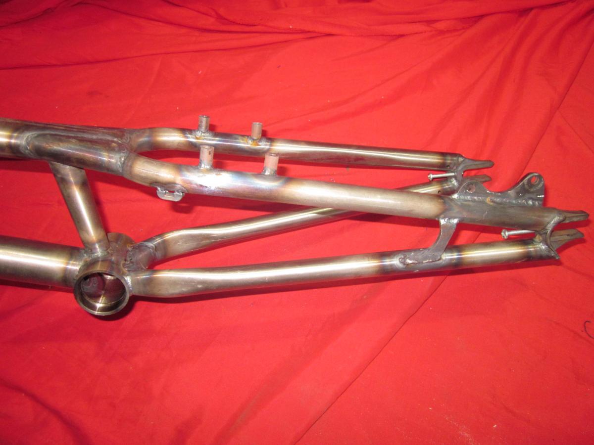

Also, I think that the quality looks rather poor. The disc tab that has been rather shodily made by hand, the brake mounts that look like they've been chewed out by a beaver and just the welding in general looks pretty highly un-uniformed and rushed. Pretty shocking in my eyes, but probably worth the small amount you pay for it.
