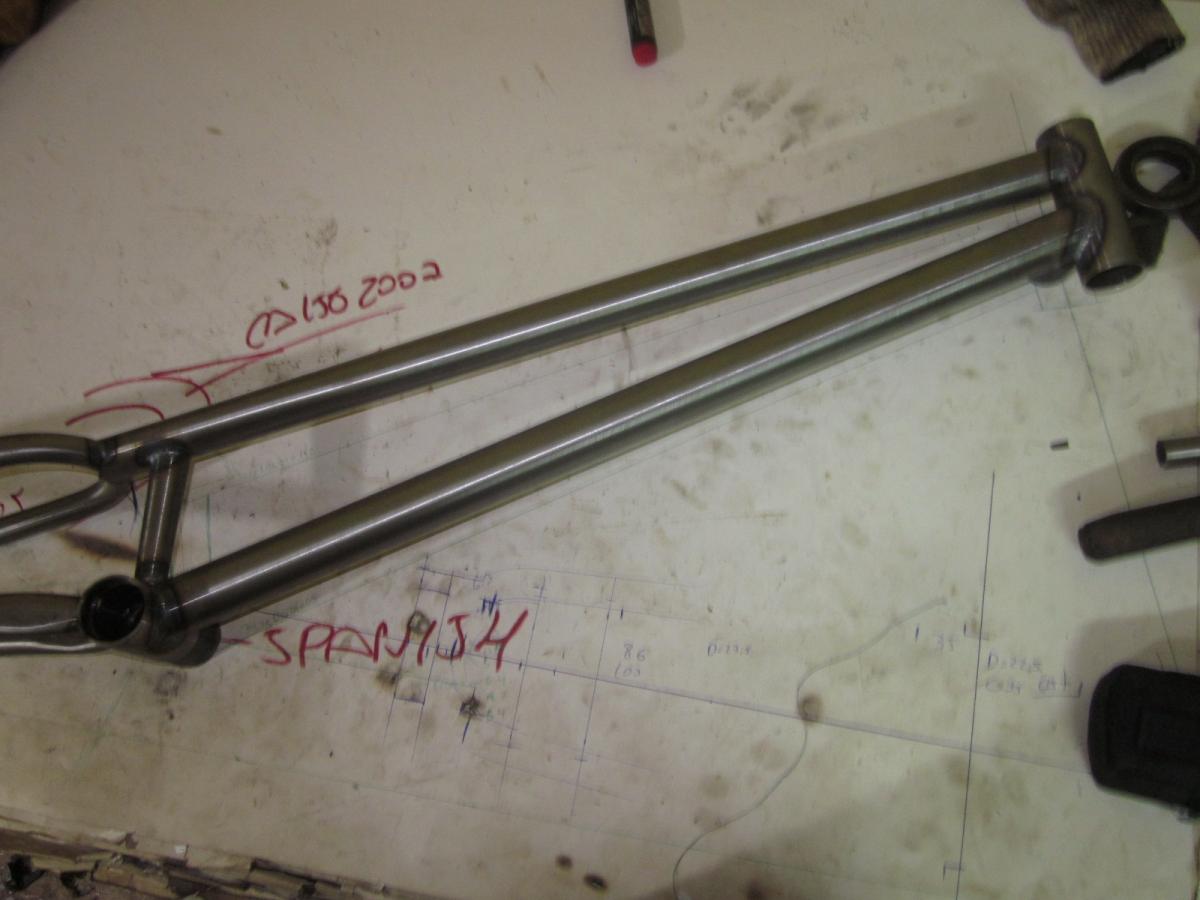

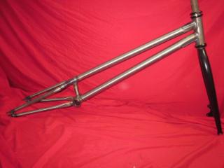

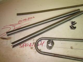

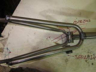

isitafox Posted March 16, 2013 Report Share Posted March 16, 2013 Well Marino is underway with my replacement frame and all I can say is that if the whole process had taken place like this originally I would have been an extremely happy customer. He confirmed with me last week that he had a few jobs to finish and would be starting my frame this week, last night I received another email to let me know he'd started the frame and then I received a further 2 emails in the night to confirm a measurement (sadly I was asleep when this came) and another with some progress pics of the build. Like I said I wasn't awake to reply to the confirmation regarding chainstay length but he carried on regardless so I assume (pray) that he checked what had been discussed previously and got the measurement from there as the frame is pinned together complete and just needs the welds and gussets finishing. Anyway, here's the pics he sent me so far. Gone for a slightly different rear end this time to get around the tight chainstays! Pieces ready to start Front end Rear end Spanish BB (hooray!) Complete view He said he was gonna finish it today so I've just got my fingers crossed that all the numbers are correct as I'm happy with how it looks, will update as soon as I hear anything! 2 Quote Link to comment Share on other sites More sharing options...

isitafox Posted March 16, 2013 Author Report Share Posted March 16, 2013 Had more emails from him today, the latest showing him welding the gussets on the seatstays. If only I could have it left raw, that would be perfect! 3 Quote Link to comment Share on other sites More sharing options...

isitafox Posted March 16, 2013 Author Report Share Posted March 16, 2013 More pics, just needs brake mounts 1 Quote Link to comment Share on other sites More sharing options...
