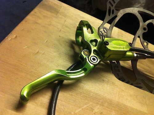

Yeah it still works fine just the lever pops out to far
You need that link I just posted, I hit my lever and it popped through the washer. It's just to save the brake from getting badly damaged if you hit the lever. Same idea as the stop plates on the Trial Zones
http://www.tartybikes.co.uk/disc_brake_spares/hope_lever_piston_circlip/c110p11214.html
Get the clip as well.
You will need a 2mm Allen key to remove the push rod from the lever. And some small circlip pliers to fit the new washer and circlip.
Problem solved
If you aren't sure how to do the repair all you need is here
