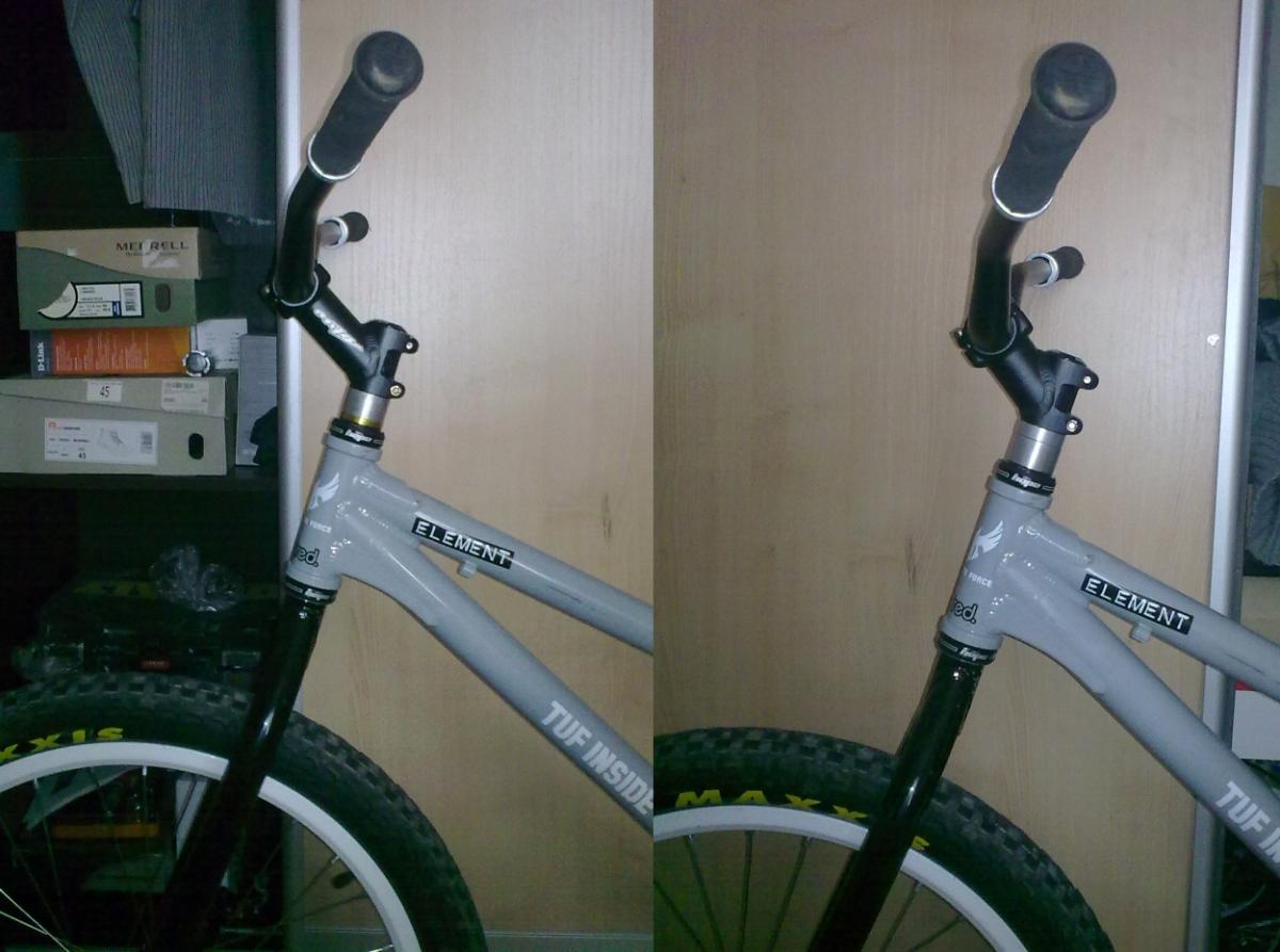

clerictgm Posted March 8, 2013 Report Share Posted March 8, 2013 After setting up TT 70-35 stem instead of onza 100x30 I hated riding! TT stem was setted up with 30mm of stackers, onza with 25(maximum possible amount of stackers). With TT stem on rear wheel bike feels terrible, not only on rear, in common bike feels terrible, also it feels too low (13mm lower and 26mm less reach than with onza). So, many people on TF says that short and high front is awesome. So whats wrong? Do I need more stackers or maybe I just need to get used to short stem? Or maybe 70x35 stem is too short? I understand why high front on street-trials is awesome, but why short front is awesome? Quote Link to comment Share on other sites More sharing options...

picowatt Posted March 8, 2013 Report Share Posted March 8, 2013 You TT stem is 10 mm higher than the 70 mm. Even though it has more angle than the TT. 100 at 30 is higher than 70 at 35 So in reality you shortened and lowered your bars Quote Link to comment Share on other sites More sharing options...

clerictgm Posted March 8, 2013 Author Report Share Posted March 8, 2013 http://alex.phred.org/stemchart/Default.aspx something to play with it's a pity that this cool thing doesn't account bars Quote Link to comment Share on other sites More sharing options...
picowatt Posted March 8, 2013 Report Share Posted March 8, 2013 Yep that's the calculator I used. Handlebars would be alot more Inputs to calculate. (Over all rise, pull back and upsweep angles. Total width ) Quote Link to comment Share on other sites More sharing options...
