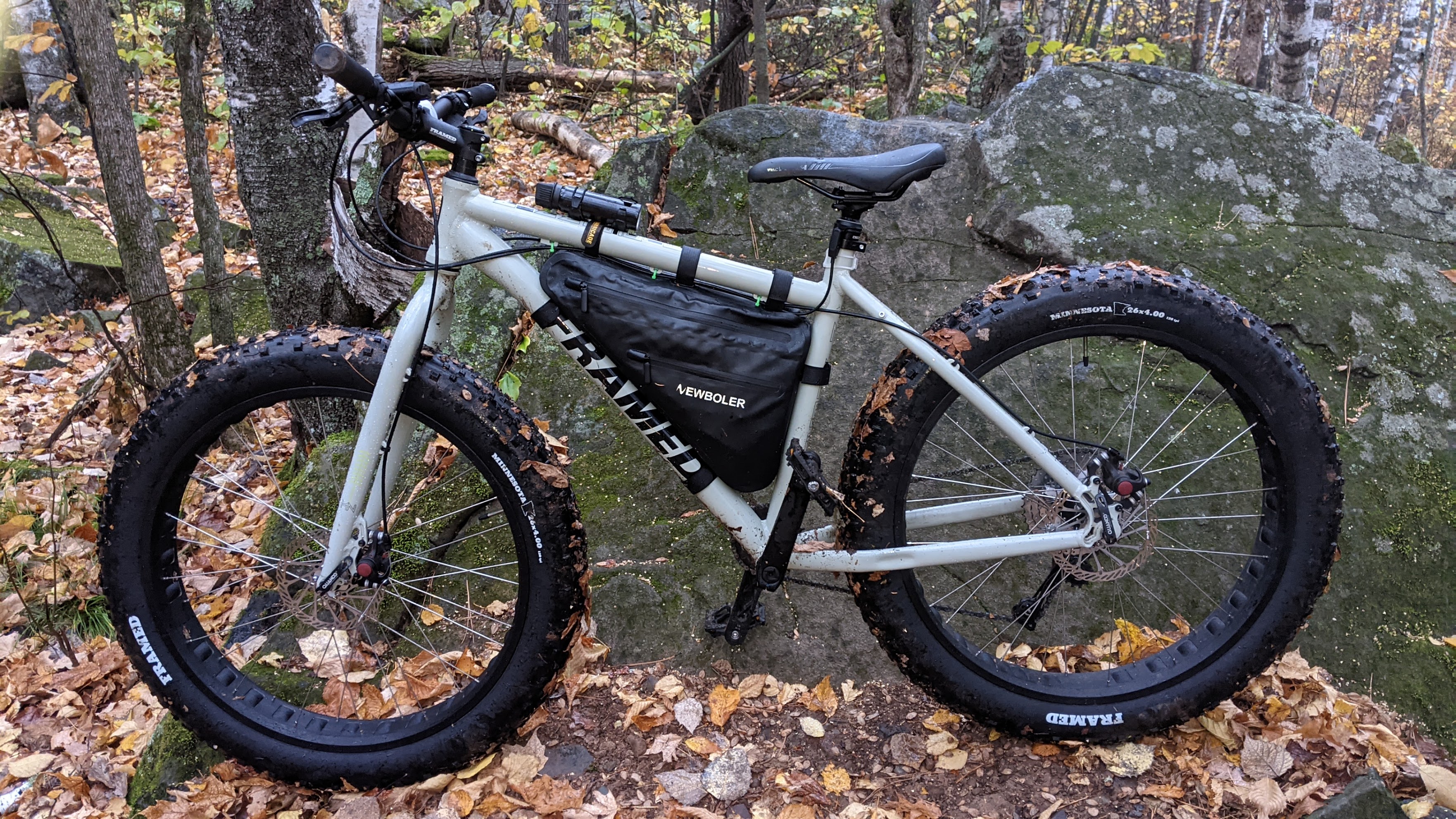

JT! Posted October 20, 2021 Report Share Posted October 20, 2021 Installed a dropper to the fatbike, obviously the saddle bag had to go so I found a frame bag that fits the triangle perfectly. Took it for a test spin on the most technical trail in riding distance called Stone Age. Yes, that rock it's leaning against is part of the trail, no, I didn't make it over. Quote Link to comment Share on other sites More sharing options...

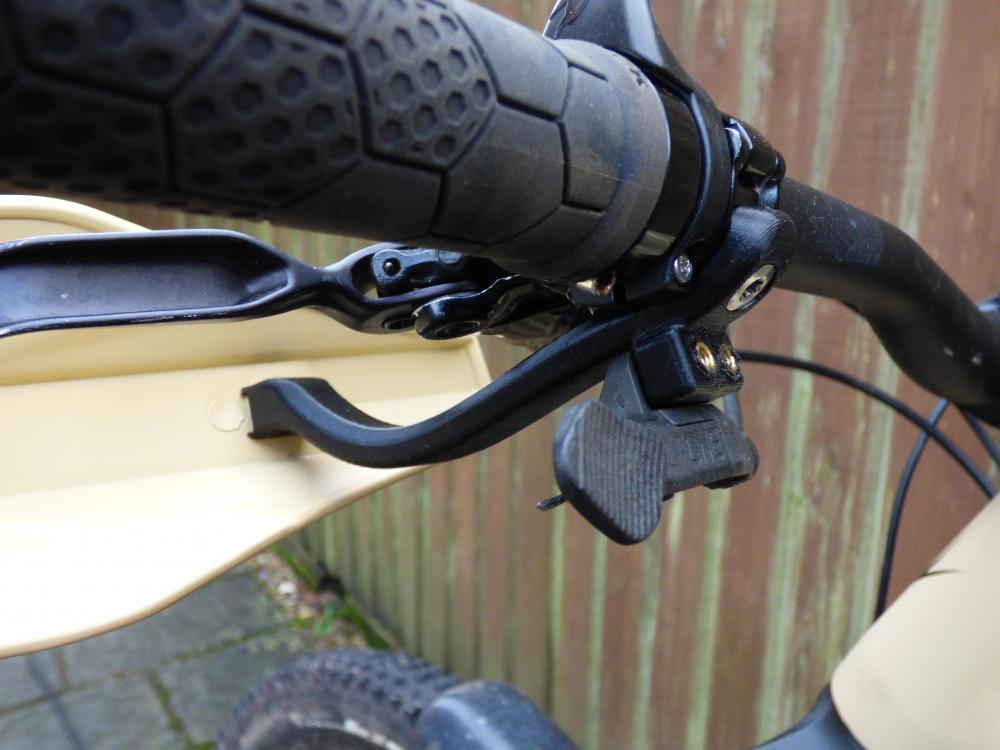

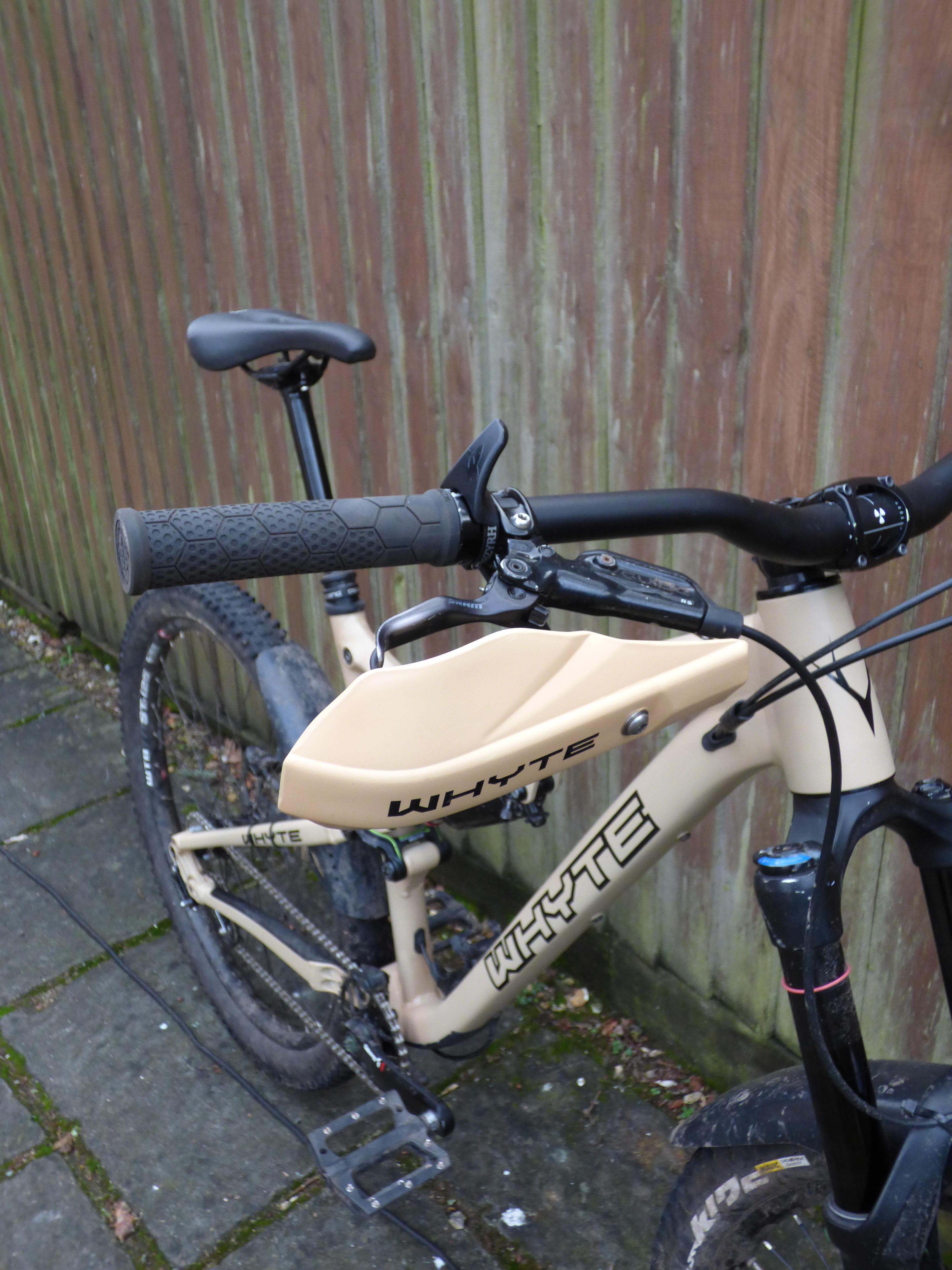

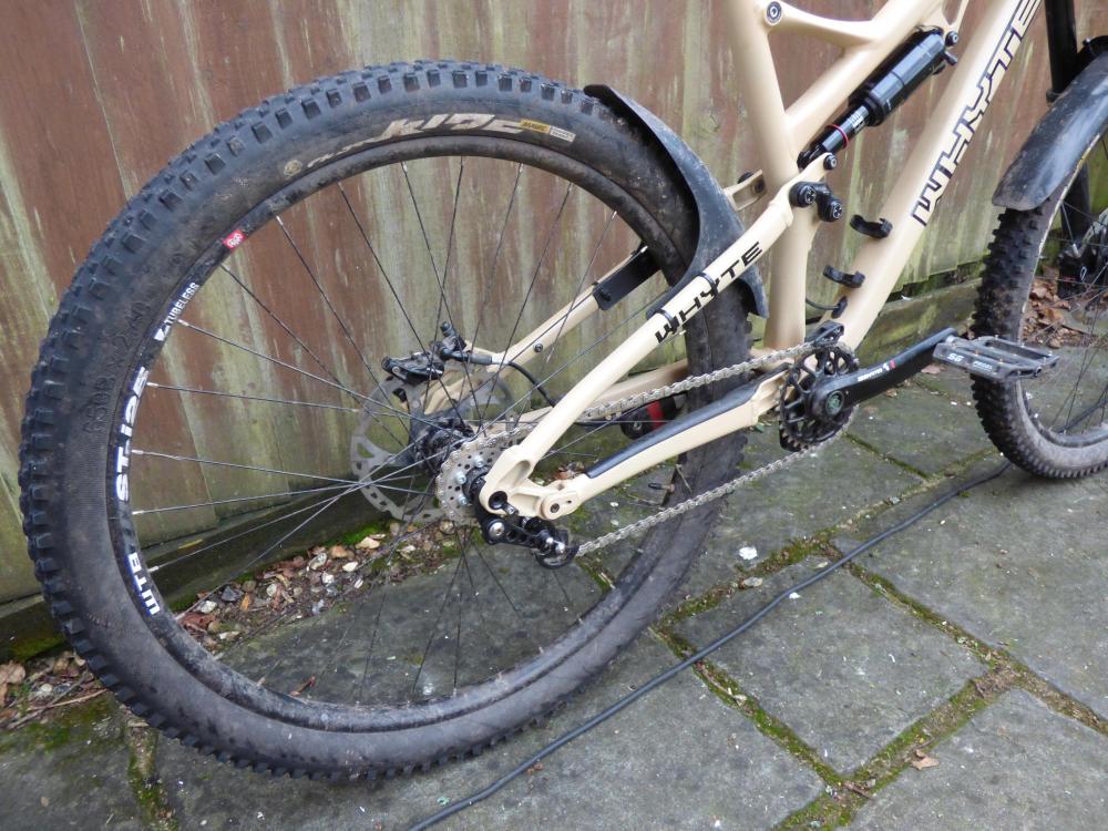

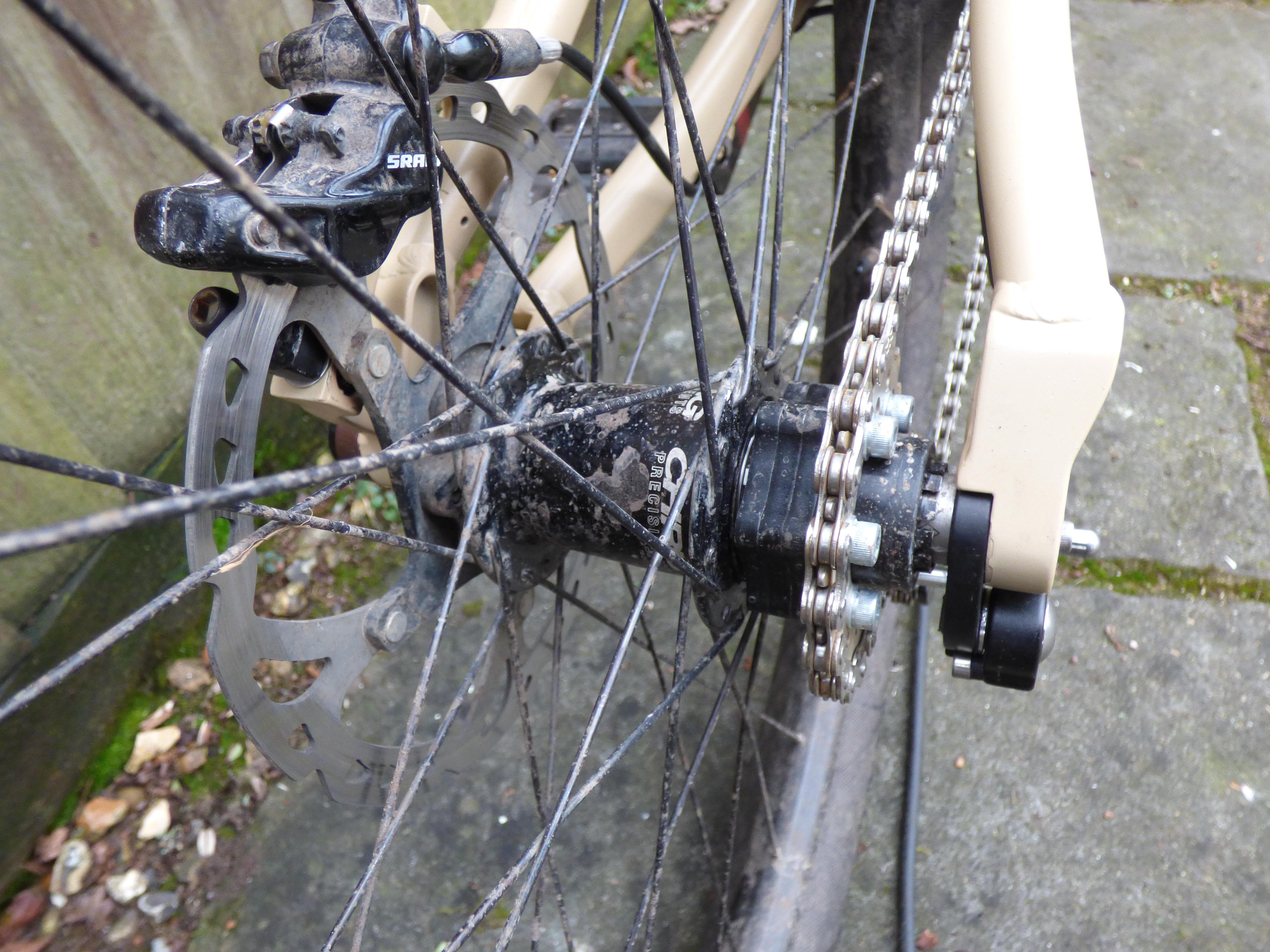

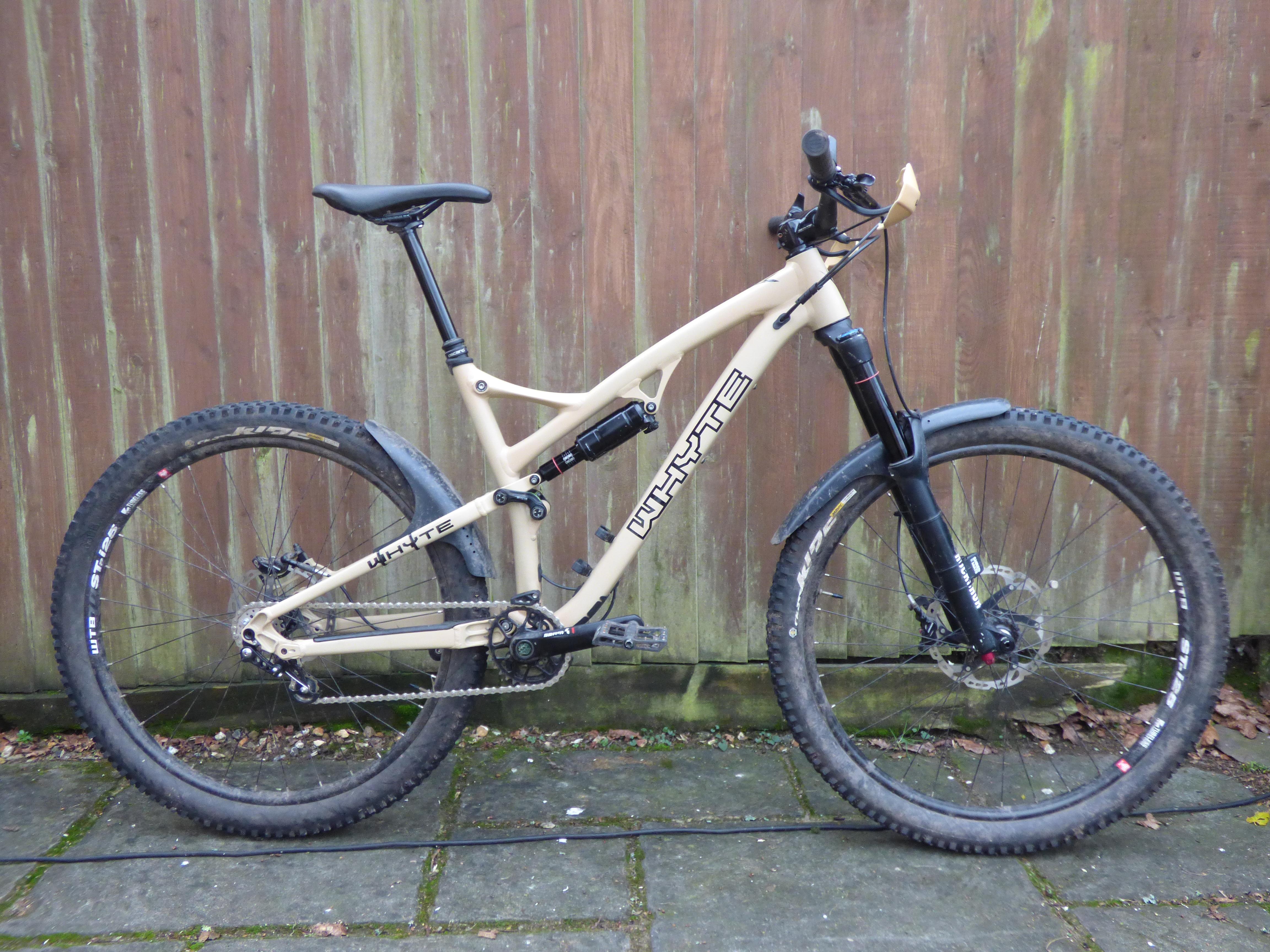

monkeyseemonkeydo Posted January 28, 2022 Report Share Posted January 28, 2022 I may have gone full retard... Not sure on the colour but fancied a change so here we go. Still the same medium 2015 Whyte T130 Works SCR, bought with Chris King Hubs etc. Now single speeded with a home made XD setup using waterjet cut spacers and the lockring from a dead XD cassette; mini MX handguards with 3D printed brackets that hang off the SRAM Matchmaker jobbies and integrating the dropper post lever on the left; trying out some of these thumb grip things for fire road grinding (Aliexpress specials for £3 rather than the expensive 'proper' ones). Still waiting on some desert camo decals for the forks and shock. It's a bit special... 4 Quote Link to comment Share on other sites More sharing options...
Tom Booth Posted January 29, 2022 Report Share Posted January 29, 2022 Nice! Looks good Dave, do you find the rear mudguard does much? Contemplating something similar for mine but really all I can see it doing is protecting the linkage Quote Link to comment Share on other sites More sharing options...
monkeyseemonkeydo Posted January 29, 2022 Report Share Posted January 29, 2022 52 minutes ago, Tom Booth said: Nice! Looks good Dave, do you find the rear mudguard does much? Contemplating something similar for mine but really all I can see it doing is protecting the linkage It does pick up a lot of crud so it definitely does something. If it prolongs the life of the bearings and stops quite so much crap getting stuck by the BB then it's worth it! Quote Link to comment Share on other sites More sharing options...
