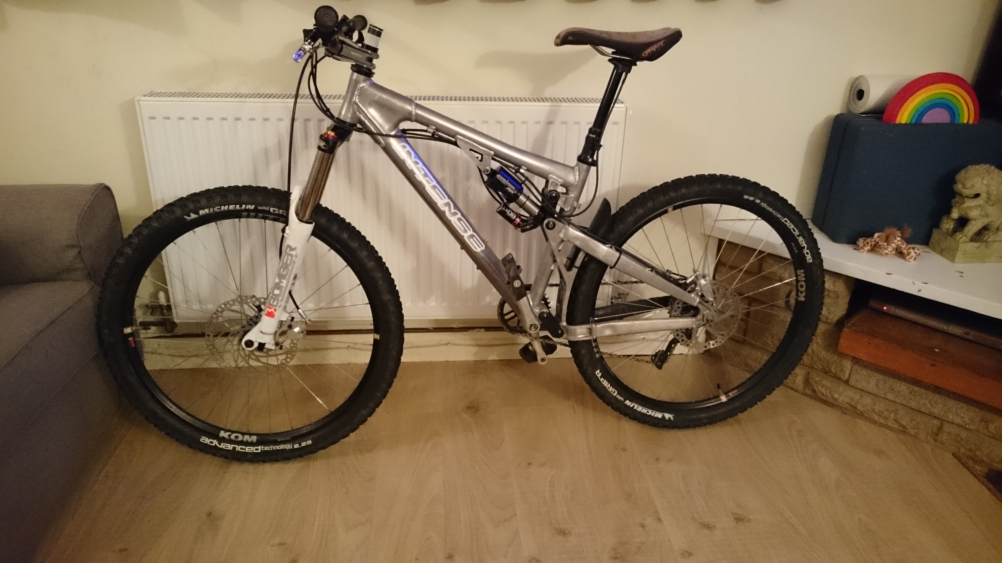

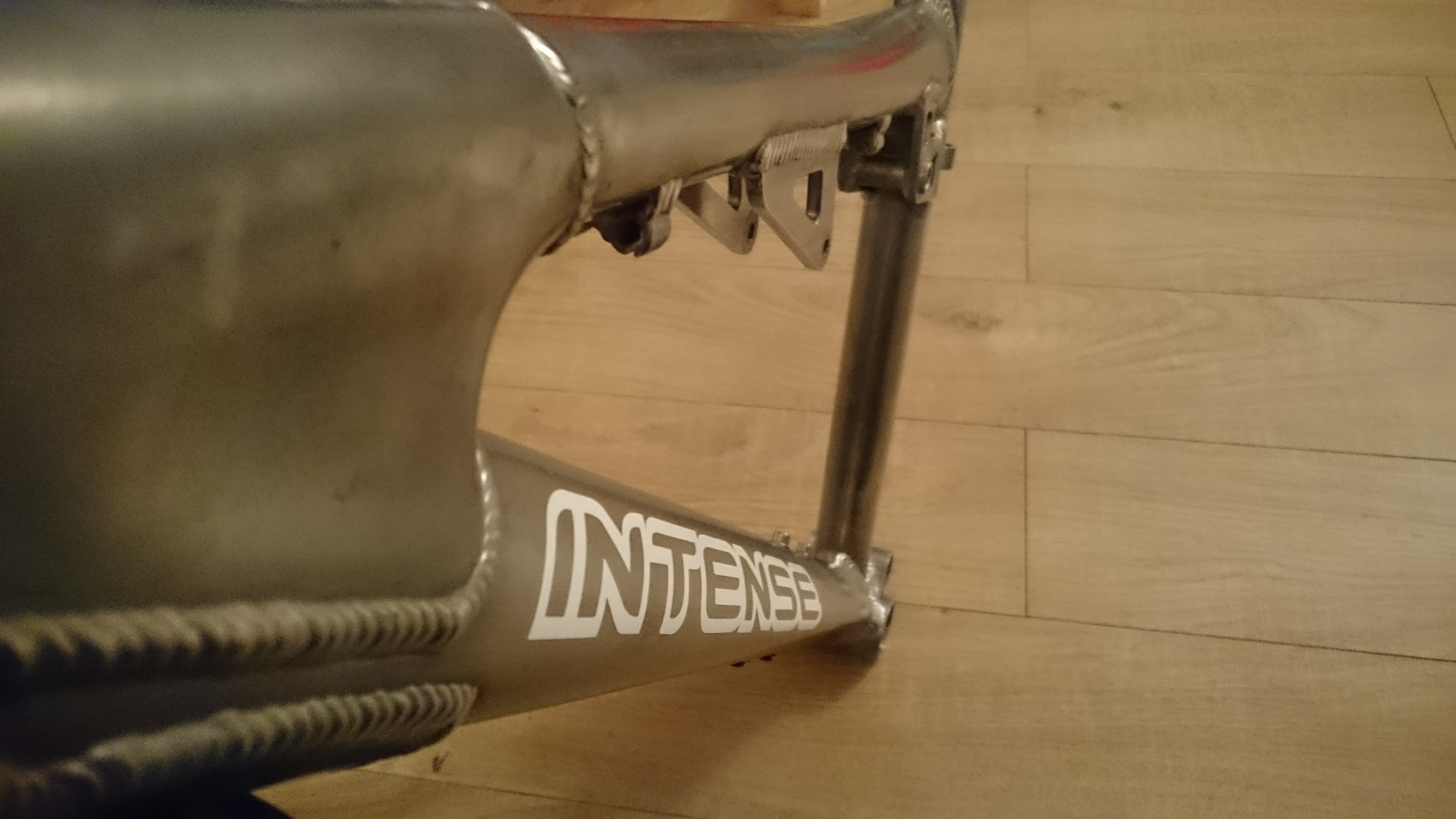

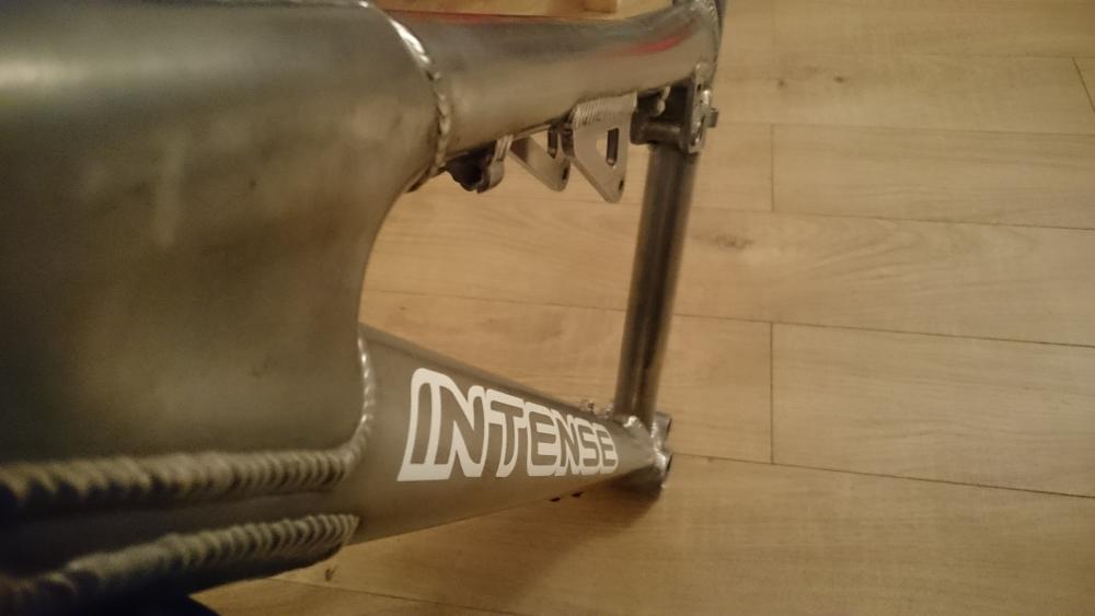

forteh Posted April 3, 2016 Report Share Posted April 3, 2016 That's it finished, I was aiming at replicating the original intense factory raw finish, welding haz, machining and tube forming marks. Stripped the powder coat off using a combination of dichloromethane stripper and 2pack paint solvent, a quick stainless wire brush over the welds to clean out the last of the staining and a quick and dirty autosol to bring it up again. I'll leave it as is now and let it oxidise back to dull aluminium Quote Link to comment Share on other sites More sharing options...
Tom Booth Posted April 4, 2016 Report Share Posted April 4, 2016 Were you still using the Strip away stuff Ed? Quote Link to comment Share on other sites More sharing options...

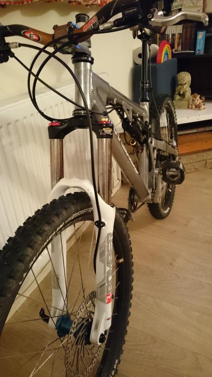

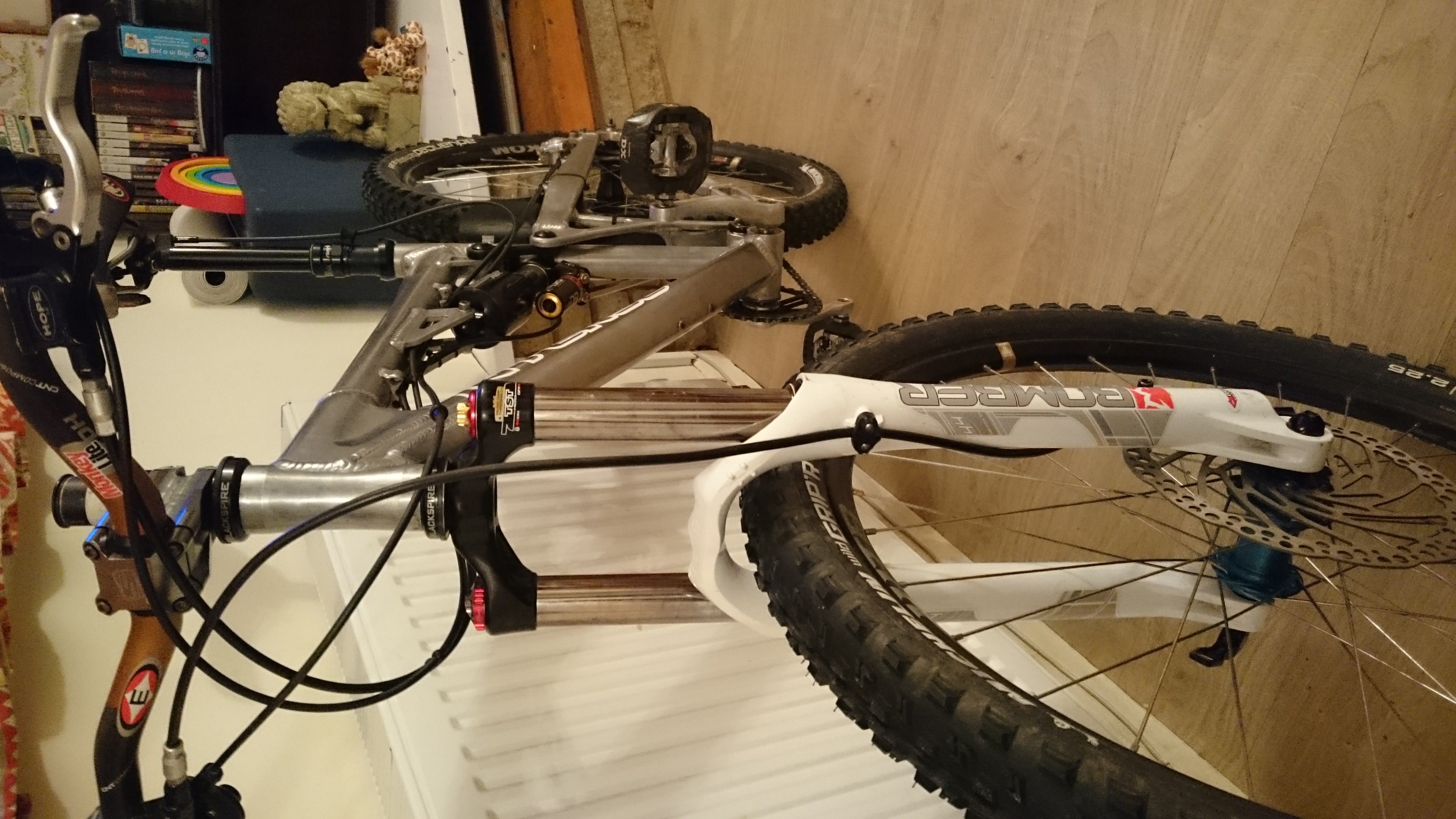

forteh Posted April 9, 2016 Report Share Posted April 9, 2016 On 4/4/2016 at 7:03 AM, Tom Booth said: Were you still using the Strip away stuff Ed? Expand Yup, theres still some left that I'm going to pass on to my mate who wants to strip an old touring frame This happened, hoping to assemble the bike this afternoon 1 Quote Link to comment Share on other sites More sharing options...
Tom Booth Posted April 9, 2016 Report Share Posted April 9, 2016 Awesome, that's good Ed. I just stripped a set of powdercoated race forks for paint, it's evil stuff! Quote Link to comment Share on other sites More sharing options...
forteh Posted April 9, 2016 Report Share Posted April 9, 2016 It's not evil, it just stings a little when you forget to brush the sticky active goop off your skin Quote Link to comment Share on other sites More sharing options...

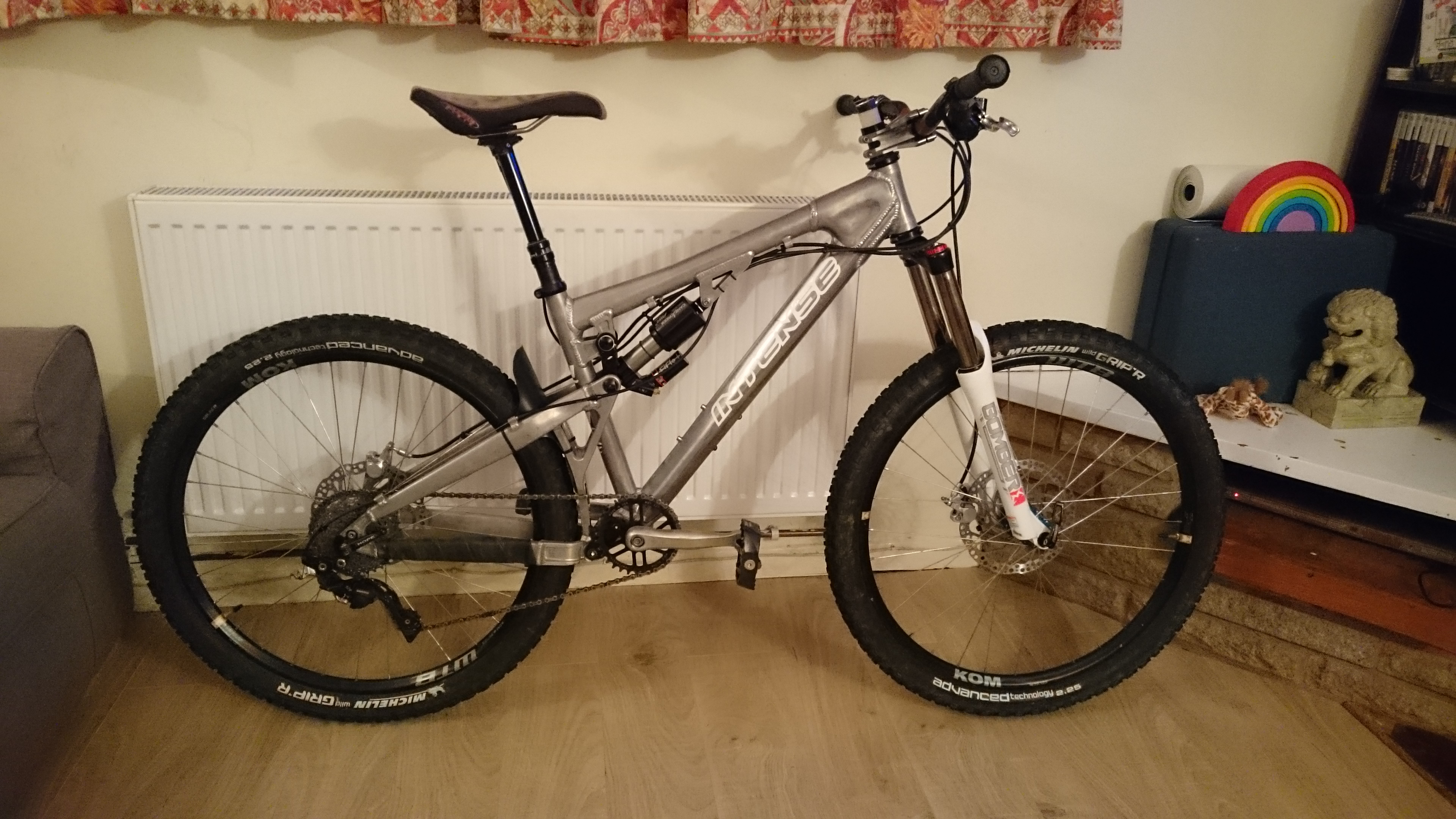

forteh Posted April 9, 2016 Report Share Posted April 9, 2016 Something like this, I f**king love the look of it if you don't mind me saying Ignore the long steerer, hoping to service the forks tomorrow and cut it down. 1 Quote Link to comment Share on other sites More sharing options...
bing Posted April 10, 2016 Report Share Posted April 10, 2016 Looks good that mate. Looks short on the wb though for a full susser Quote Link to comment Share on other sites More sharing options...
forteh Posted April 10, 2016 Report Share Posted April 10, 2016 It is a short wb, the 5.5 is known for being a very steep twitchy frame that you have to keep on top of otherwise you're eating shit. I like it though, similar geometry to the chameleon which I've been riding since 98 so somewhat familiar with the ride. I dare say compared to some modern gravity sleds it's probably scary in the really fast and steep but nothing at cannock phases it at all and it works as a perfect trail bike Quote Link to comment Share on other sites More sharing options...
