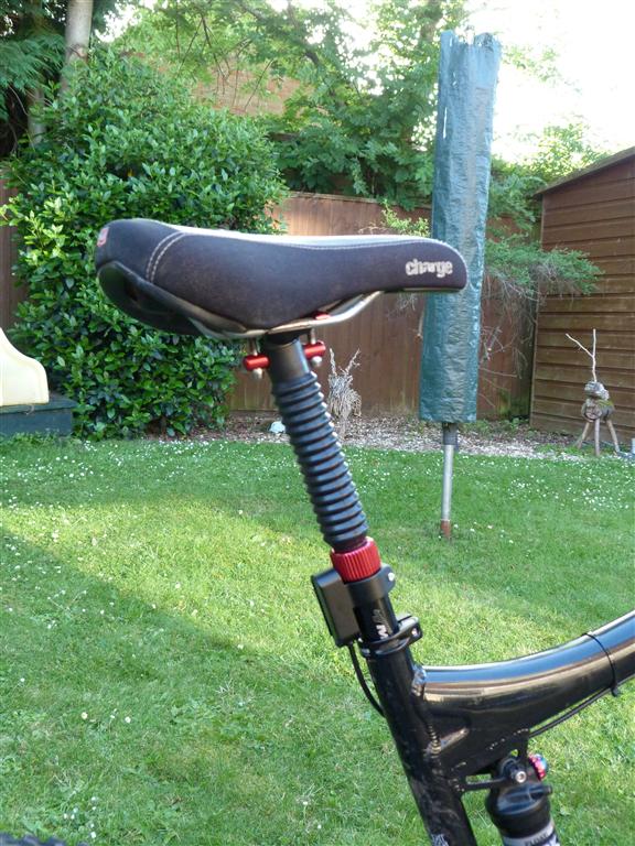

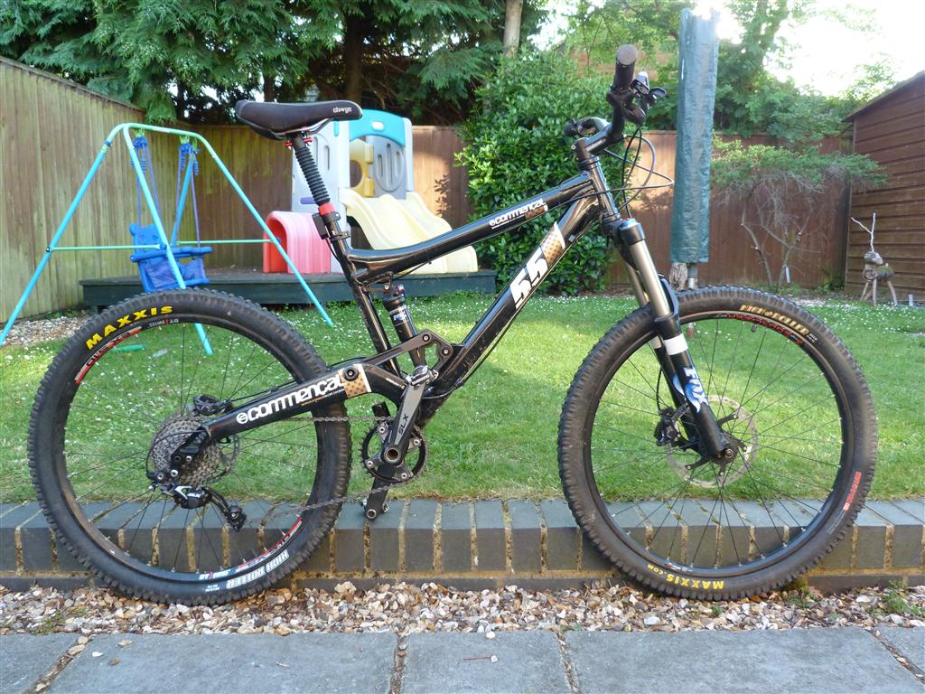

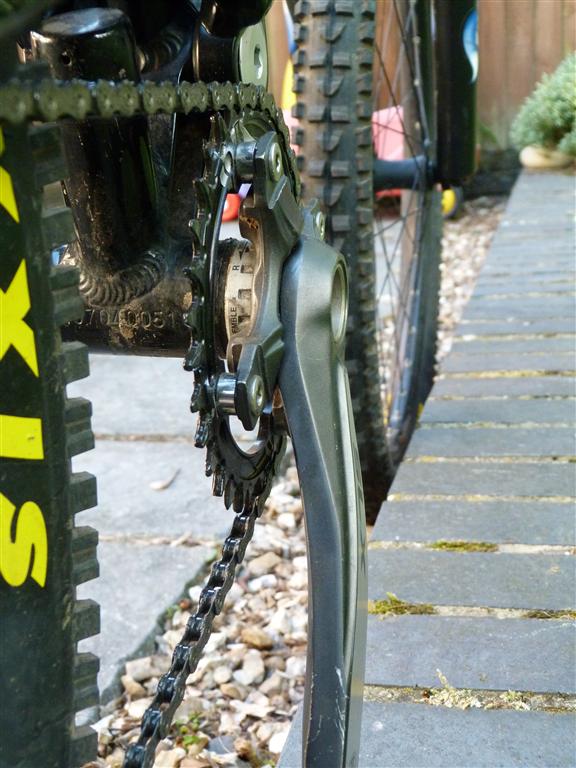

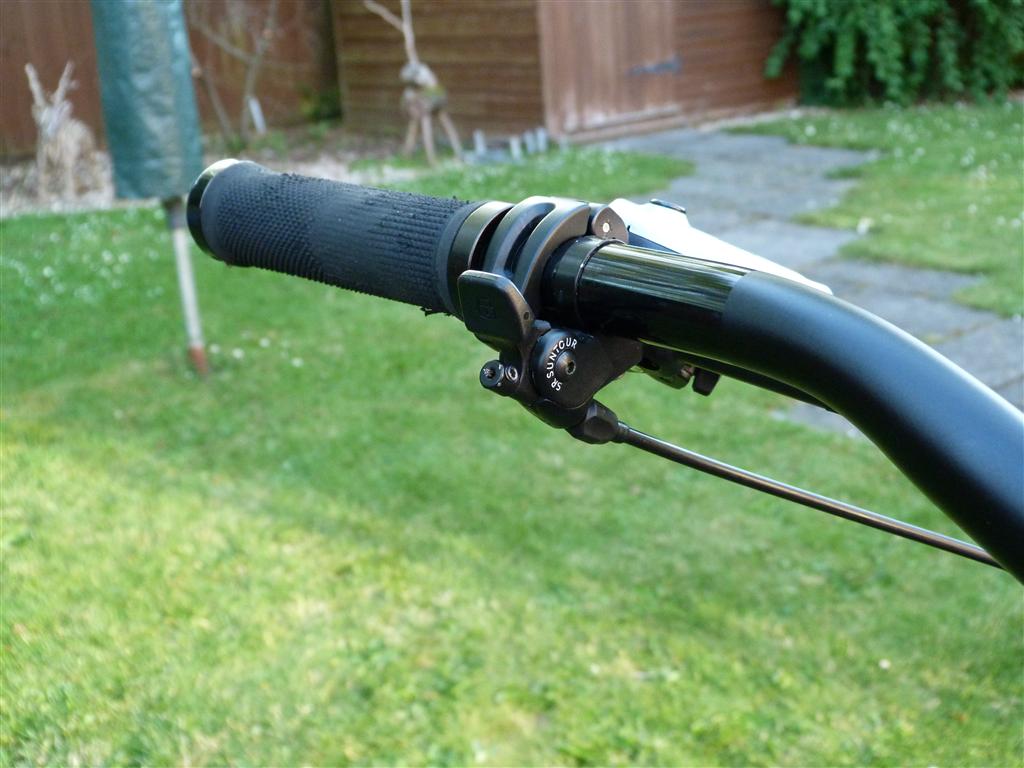

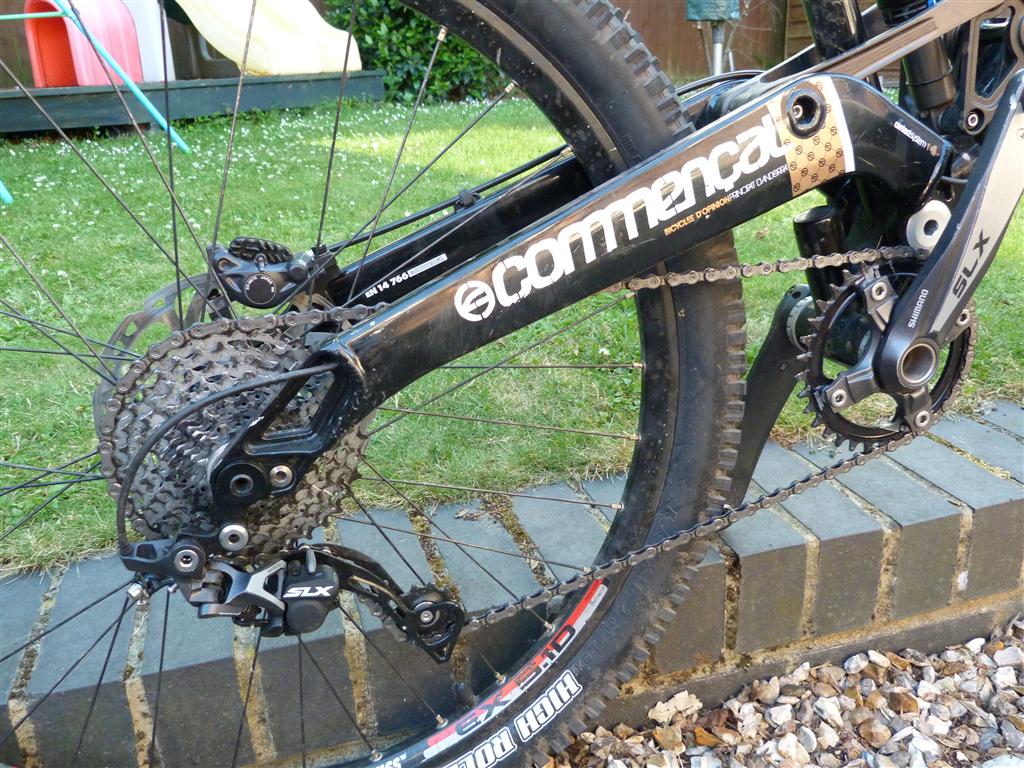

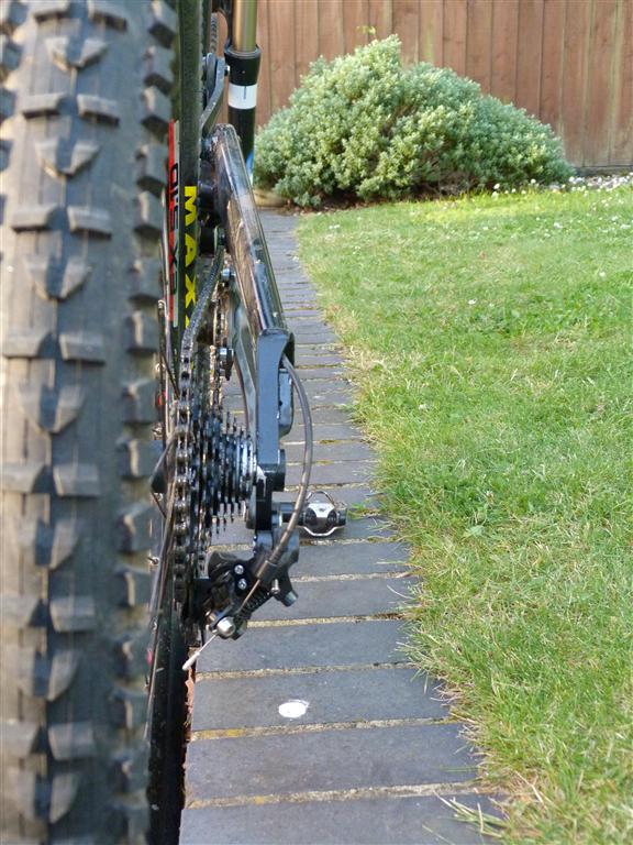

monkeyseemonkeydo Posted June 17, 2014 Report Share Posted June 17, 2014 Was seriously considering spending £2k+ on a new bike but decided that actually I'd be doing it for the sake of it so instead spent ~£250 on the Meta to bring it a bit more up to date. Changed to 1x10 setup with an SLX Shadow+ rear mech, SLX shifter with display removed, XT 11-36 cassette and Superstar 34T narrow wide ring up front. While I was at it I also upgraded from Avid Juicy 5's (running on 185s) to SLX brakes with RT76 rotors, upped to 203 on the front and 180 on the rear. Final change was that I've been messing round with my home made dropper for a while but wanted to try a remote system and since the Meta has a 27.2 post the options are limited. Thought I'd try the cheap option of a TMars Gravity Dropper copy for £47 which so far seems pretty good. The reviews were a bit mixed but mainly were either 'great for the money' or (reading between the lines) 'I have no idea how to work a spanner, set up a cable brake/gears and take my bike to a shop to fix a puncture'. As some people said the lever seemed a bit dodgy so I immediately paired the post to a slimmed down Suntour remote lockout lever which seems to work just dandy. After fitting the Superstar ring I wasn't too happy with the chainline so added some spacer chainring bolt things I had which seemed to work a treat. Puts the ring chain close to the pivot cover things but still clear so no worries. Final note to self: when fitting a new chain to a full sus bike as well as setting the length relative to the worst gearing set up also remove the air from the shock to see how the suspension acts on the chain length. Oops. 1 Quote Link to comment Share on other sites More sharing options...
N.Wood Posted June 17, 2014 Report Share Posted June 17, 2014 What does 'narrow wide' actually mean? I havn't ridden mtbs for years. Quote Link to comment Share on other sites More sharing options...
forteh Posted June 17, 2014 Report Share Posted June 17, 2014 Every other tooth has a wider stepped section so it interlocks with the shape of the chain to reduce sideways movement, the teeth are also full height to prevent the chain from lifting off the ring. Developed by sram but not patented for some reason and now everyone makes them, I recently put a wolftooth middleburn direct mount on my intense and dropped almost a pound in weight simply by removing the chainguide! Quote Link to comment Share on other sites More sharing options...
