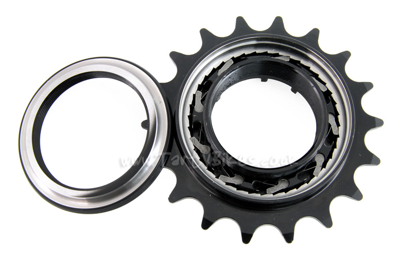

cai Posted February 27, 2013 Report Share Posted February 27, 2013 After 2 years my silver/original SL exploded (the outer ring snapped in 3 places) today whilst riding rocks, thankfully I'm not too hurt. I've had a look at the freewheel page on Tarty and the SL still looks like the top choice, but it's now black, is this still the same freewheel just with a colour change or has it had a complete re-design? Is it still as reliable as the original SL? Quote Link to comment Share on other sites More sharing options...

trials hoe Posted February 27, 2013 Report Share Posted February 27, 2013 The new ones aren´t what they used to be, but still the best fw out there. Maybe new try all could be contender? looking at how shallow the teeth on the ratchet are, i'm going to say no....... vs the echo 3 Quote Link to comment Share on other sites More sharing options...
cai Posted February 27, 2013 Author Report Share Posted February 27, 2013 Ive got one of the prototypes which is just terrible, what other choices are there? There's not a huge choice. The Insprired 60 click looks the same as the 60 click Tensile freewheels, so both have the locking on the wrong side. The 72 click viz/rockman and 108 click viz/rockman/try-all/trialtech look like catalogue parts - they may be okay though? Then there's the Try-All 120.9 which could prove unreliable. The rest of them are out of my price range.. Quote Link to comment Share on other sites More sharing options...

cai Posted February 27, 2013 Author Report Share Posted February 27, 2013 Mixed reviews for the Try-All then. I'd rather hear about the Echo SL. How is it any different than it used to be? Quote Link to comment Share on other sites More sharing options...
ghostrider88 Posted February 27, 2013 Report Share Posted February 27, 2013 they usually skip a bit at the beginning, nothing too bad, but it might cause damage to the pawls/outer ring=more skips/broken pawls. Outer rings are also more prone to breaking. This sounds bad I know, but you will have hard time finding better freewheel still. Quote Link to comment Share on other sites More sharing options...
williams Posted February 27, 2013 Report Share Posted February 27, 2013 My 'new' black SL is awesome, wouldn't change it against any other freewheel. Never skipped or anything like that. Sounds good aswell. Quote Link to comment Share on other sites More sharing options...

SamKidney Posted March 1, 2013 Report Share Posted March 1, 2013 Would be epic if they were made like the first lot. Feeleys got one of the original SL freewheels on his mod and it sounds completely different to my newer black SL. 1 Quote Link to comment Share on other sites More sharing options...
trialsiain Posted March 1, 2013 Report Share Posted March 1, 2013 Yea I agree Sam I still have a silver one and it's so much louder and more of a clicking noise than black one Quote Link to comment Share on other sites More sharing options...
Jake. Posted March 1, 2013 Report Share Posted March 1, 2013 Yea I agree Sam I still have a silver one and it's so much louder and more of a clicking noise than black one I've got both, the silver one is louder. Quote Link to comment Share on other sites More sharing options...
cai Posted March 1, 2013 Author Report Share Posted March 1, 2013 Other than noise, is there a difference? Quote Link to comment Share on other sites More sharing options...
SamKidney Posted March 1, 2013 Report Share Posted March 1, 2013 It certainly seems to be holding up better. The early SL freewheels were sweet, but it seems like the last few silver SL's were in the same boat as the current ones. Me and two mates bought them just before they were discontinued, and all ours broke in under 6 months. Either cracking, skipping or gradually loosing engagements. Im on my 3rd/4th SL now. Quote Link to comment Share on other sites More sharing options...
