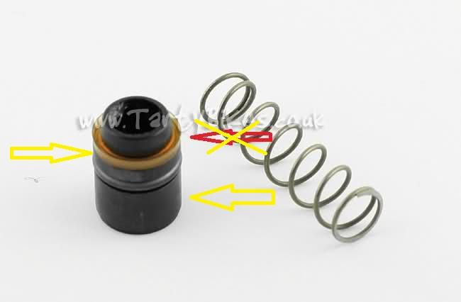

trialsiain Posted February 20, 2013 Report Share Posted February 20, 2013 see when you lot say to "sand piston" is it this part you mean ? http://tinypic.com/view.php?pic=do8588&s=5 Quote Link to comment Share on other sites More sharing options...
FamilyBiker Posted February 20, 2013 Report Share Posted February 20, 2013 those surfaces Quote Link to comment Share on other sites More sharing options...
trialsiain Posted February 20, 2013 Author Report Share Posted February 20, 2013 those surfaces so do you have to take the oring off to get at the top one Quote Link to comment Share on other sites More sharing options...
FamilyBiker Posted February 20, 2013 Report Share Posted February 20, 2013 (edited) yep.if you dont youll end up with a leaking brake in worst case Edited February 20, 2013 by FamilyBiker Quote Link to comment Share on other sites More sharing options...
trialsiain Posted February 20, 2013 Author Report Share Posted February 20, 2013 how do i get that black bit out Quote Link to comment Share on other sites More sharing options...
FamilyBiker Posted February 20, 2013 Report Share Posted February 20, 2013 should you?nah Quote Link to comment Share on other sites More sharing options...
trialsiain Posted February 20, 2013 Author Report Share Posted February 20, 2013 should you?nah what ? how do i get the piston out of the lever or does it just fall out ? Quote Link to comment Share on other sites More sharing options...
FamilyBiker Posted February 20, 2013 Report Share Posted February 20, 2013 (edited) best is to have the lever blade removed,then undo the bleed screw and push the piston out with a spoke or similar through the bleed port. IF it doesnt come out by itself does that make sense? Edited February 20, 2013 by FamilyBiker Quote Link to comment Share on other sites More sharing options...
trialsiain Posted February 20, 2013 Author Report Share Posted February 20, 2013 ah ok thanks, im not sure if it needs to be done though my problem is that the brake pads keep sticking on when im on back wheel and let brake off it does it, but if im pulling lever when not on bike they move quite snappy Quote Link to comment Share on other sites More sharing options...

trialsiain Posted February 21, 2013 Author Report Share Posted February 21, 2013 it was my lever piston thing i put my spare one in and lever works great just need to bleed Quote Link to comment Share on other sites More sharing options...
