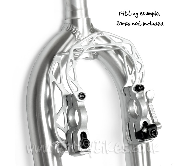

lucas-87 Posted February 16, 2013 Report Share Posted February 16, 2013 Hey guys just bought a 2004 magura hss33 of my friend for £5 I thininits a hs33 its got a little adjuster on the leaver the trouble im having is I cant see to get it to fit right all he has given me is the leaver and brake callipers does it need some sort of mounting bracket im replacing a v brake its also got some weired leaver like a quick release any ideas ??? Quote Link to comment Share on other sites More sharing options...
ghostrider88 Posted February 16, 2013 Report Share Posted February 16, 2013 You need evo 2 mounts if you have V mounts on your frame. Quote Link to comment Share on other sites More sharing options...
FamilyBiker Posted February 16, 2013 Report Share Posted February 16, 2013 Quote Link to comment Share on other sites More sharing options...
lucas-87 Posted February 16, 2013 Author Report Share Posted February 16, 2013 Ah right tidy im still not sure lol mine look this So do I not just need this www.chainreactioncycles.com/Models.aspx?ModelID=9445 Thanks Quote Link to comment Share on other sites More sharing options...
chris H Posted February 16, 2013 Report Share Posted February 16, 2013 If your frame is v mount, then what you have is just the older version of what has been shown to buy. Yours threads in and the little plastic legs position and lock into place holding the cylinders. Quote Link to comment Share on other sites More sharing options...
lucas-87 Posted February 16, 2013 Author Report Share Posted February 16, 2013 So do the pegs sit against the frame ? Quote Link to comment Share on other sites More sharing options...
trials owns Posted February 16, 2013 Report Share Posted February 16, 2013 (edited) Id have done with it, and buy the complete set here, http://www.tartybikes.co.uk/brake_clamps/magura_evo2_brake_adaptor_kit/c74p10934.html Cheaper than just the one bracket at chain reaction cycles Edited February 16, 2013 by trials owns 1 Quote Link to comment Share on other sites More sharing options...
ghostrider88 Posted February 16, 2013 Report Share Posted February 16, 2013 So do the pegs sit against the frame ? Yes.it stops the brake from moving outside,so it should be in contact with the frame. Quote Link to comment Share on other sites More sharing options...
lucas-87 Posted February 16, 2013 Author Report Share Posted February 16, 2013 Id have done with it, and buy the complete set here, http://www.tartybikes.co.uk/brake_clamps/magura_evo2_brake_adaptor_kit/c74p10934.html'>http://www.tartybikes.co.uk/brake_clamps/magura_evo2_brake_adaptor_kit/c74p10934.html Cheaper than just the one bracket at chain reaction cycles Cheers bud just ordered one thanks Quote Link to comment Share on other sites More sharing options...
