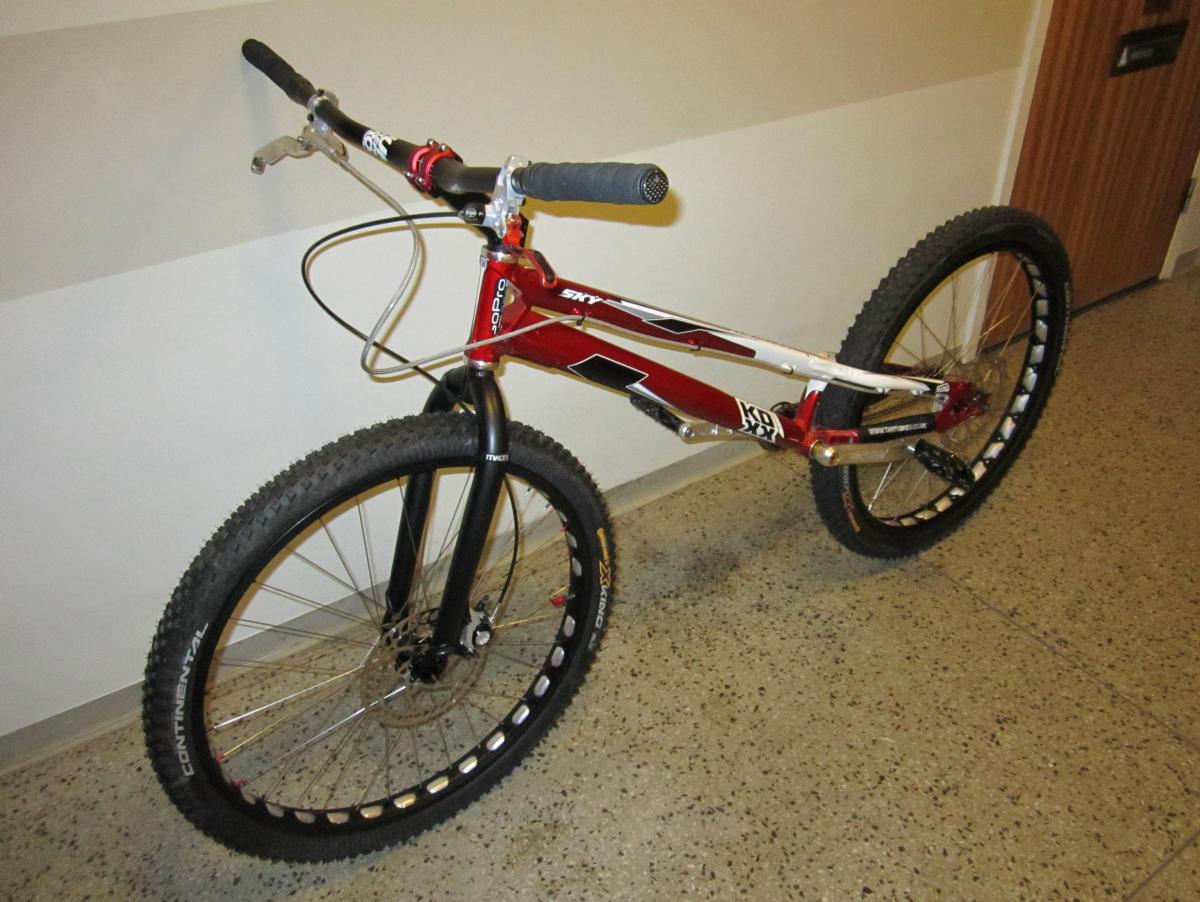

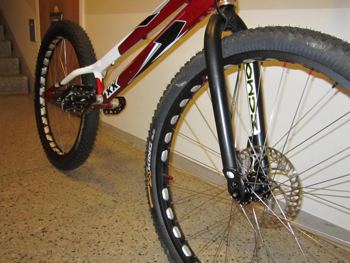

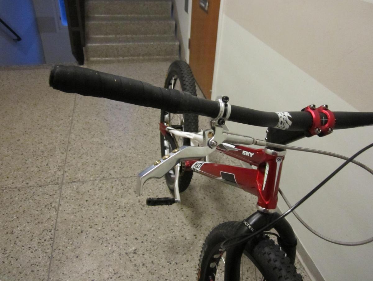

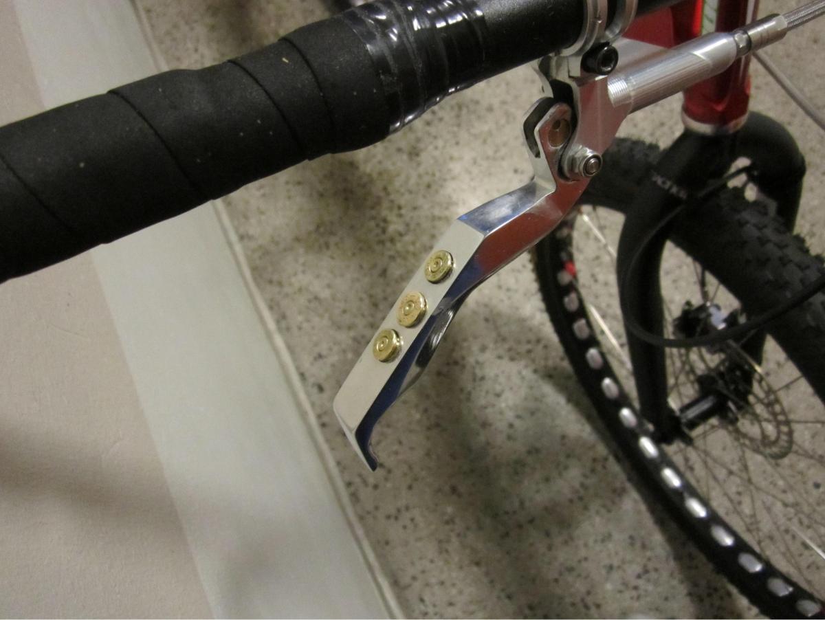

Thehiphopsolidier Posted January 16, 2013 Report Share Posted January 16, 2013 Frame-KOXX RED SKY Disc Fork-Echo urban 2012 Rims-Echo TR, bigger holes and Tryall K2 Hubs-Trialtech Race Sealed Disc front and Because Rear Disc rear Spokes-Sapim Race Nipels-V!S alloy red/black Tires-Continental X-King Race/supersonic black chilli (will use kaser in the sping) Tubes-Kenda Pedals-Onza hognesium BB-Reset TI-carbon 128mm with TryAll NoWar 2013 bolts Cranks-Born cnc super light 172mm Bars-nukeproof warhead 800mm Stem-NEON Bikes 30-120mm Brakes-Hope Trial, trial zone and mini handels + custom blades (two 9mm and one 357magnum ammo) Disc-Hope 180mm front Hope Monty 190mm rear Freewheel-Echo SL 108, 18t Sproket-Echo SL TI 15t Chain-KMC 710 sl TI Bashring-Trial tech twin TI Headset-Echo SL Grips-bar tape Barends-Carbon fiber push in -9kg 1 Quote Link to comment Share on other sites More sharing options...
BradJohnson Posted January 16, 2013 Report Share Posted January 16, 2013 That lever is mental! Bike looks sweet, And it's well spec'd. Quote Link to comment Share on other sites More sharing options...
williams Posted January 16, 2013 Report Share Posted January 16, 2013 Bike looks really nice! Where in Sweden are you based? Im from Stockholm and know every rider in stockholm:) Quote Link to comment Share on other sites More sharing options...
Lewis Gething Posted January 16, 2013 Report Share Posted January 16, 2013 Im from Stockholm and know every rider in stockholm:) What if there are riders in Stockholm who you do not know about Williams Nice bike by the way! Quote Link to comment Share on other sites More sharing options...
Danny00135 Posted January 16, 2013 Report Share Posted January 16, 2013 That looks very nice indeedy Quote Link to comment Share on other sites More sharing options...
Greetings Posted January 16, 2013 Report Share Posted January 16, 2013 Koxx design is hard to beat. Shame there are so few of these Sky bikes around. Quote Link to comment Share on other sites More sharing options...
Rockman Posted January 16, 2013 Report Share Posted January 16, 2013 Your right brake lever is upside down, it'll f**k the seals and diaphragm. Nice bike though Quote Link to comment Share on other sites More sharing options...
williams Posted January 16, 2013 Report Share Posted January 16, 2013 What if there are riders in Stockholm who you do not know about Williams 1 Quote Link to comment Share on other sites More sharing options...
Lewis Gething Posted January 16, 2013 Report Share Posted January 16, 2013 Hahaa okay sorry I hope that thehiphopsoldier is from Stockholm though 2 Quote Link to comment Share on other sites More sharing options...
Thehiphopsolidier Posted January 17, 2013 Author Report Share Posted January 17, 2013 I live and ride in södertälje. The brake is a flipflop design so no problem. The brake lever blade i 100% hand made (no power tools used) Quote Link to comment Share on other sites More sharing options...
HippY Posted January 17, 2013 Report Share Posted January 17, 2013 is Sweden that dangerous that you need to store your ammunition even in your lever? awesome bike and pretty bad-ass Quote Link to comment Share on other sites More sharing options...
Rockman Posted January 18, 2013 Report Share Posted January 18, 2013 I live and ride in södertälje. The brake is a flipflop design so no problem. The brake lever blade i 100% hand made (no power tools used) It's not a flip-flop design, it only has one diaphragm. Quote Link to comment Share on other sites More sharing options...
Bigman Posted January 21, 2013 Report Share Posted January 21, 2013 Bike looks lovely, however I am going to agree with Rockman, those levers are not flip flop, so you really should source a new lever for that brake so that the reseviour is the correct side, like he says it could cause issues with seals, I am surprised the oil isn't leaking out of the over flow slot in the reseviour cap..... Adam Quote Link to comment Share on other sites More sharing options...
315r Posted January 22, 2013 Report Share Posted January 22, 2013 Imposible, hope levers are not flip flop, surprised if this brake works well... Reservoir could contain air on the top, if the lever is upside down this air could be introduced in the circuit. Quote Link to comment Share on other sites More sharing options...

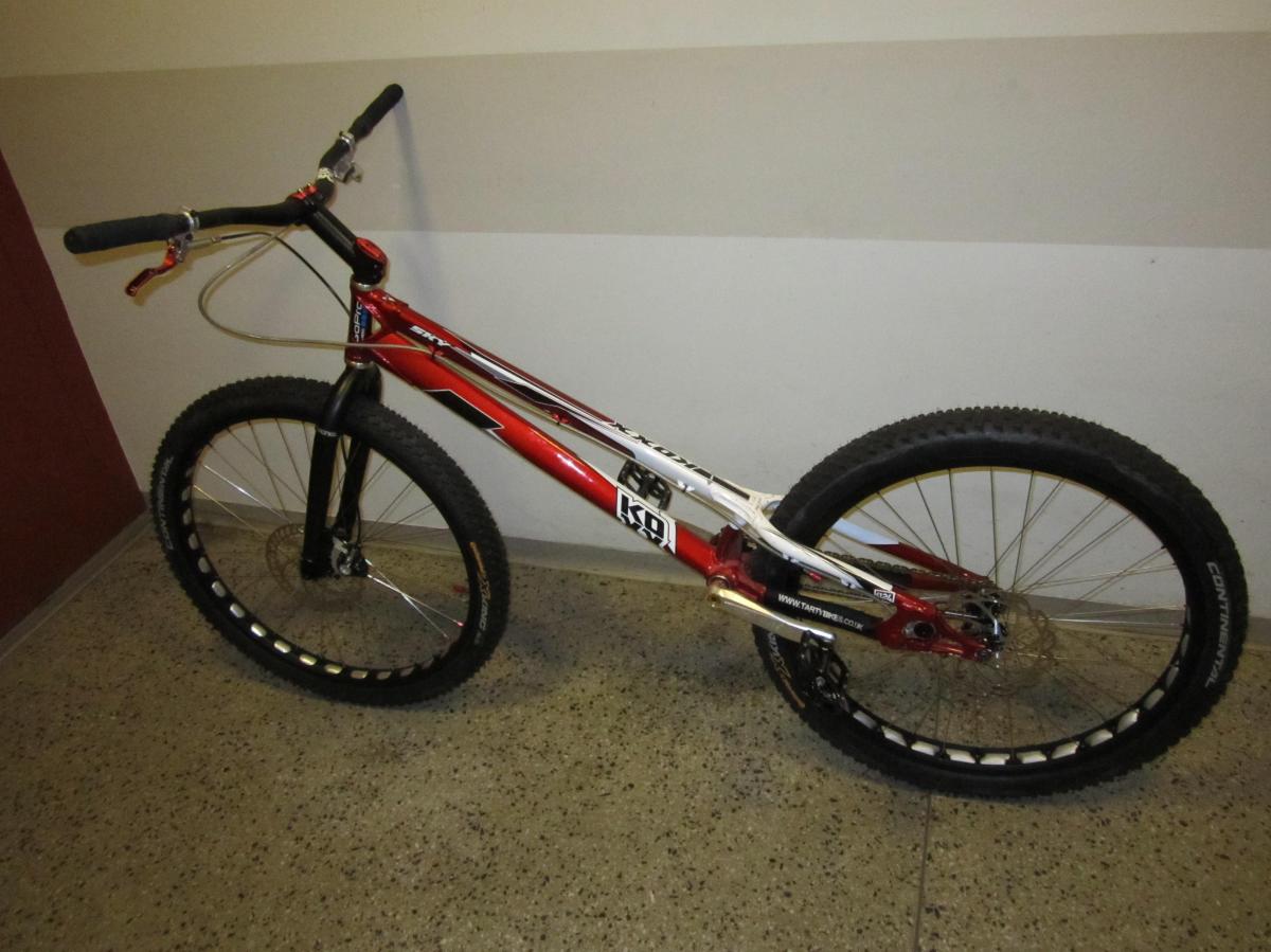

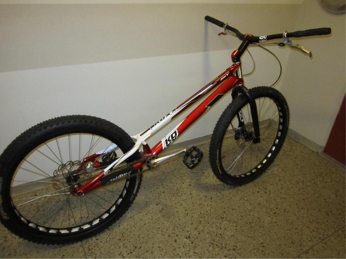

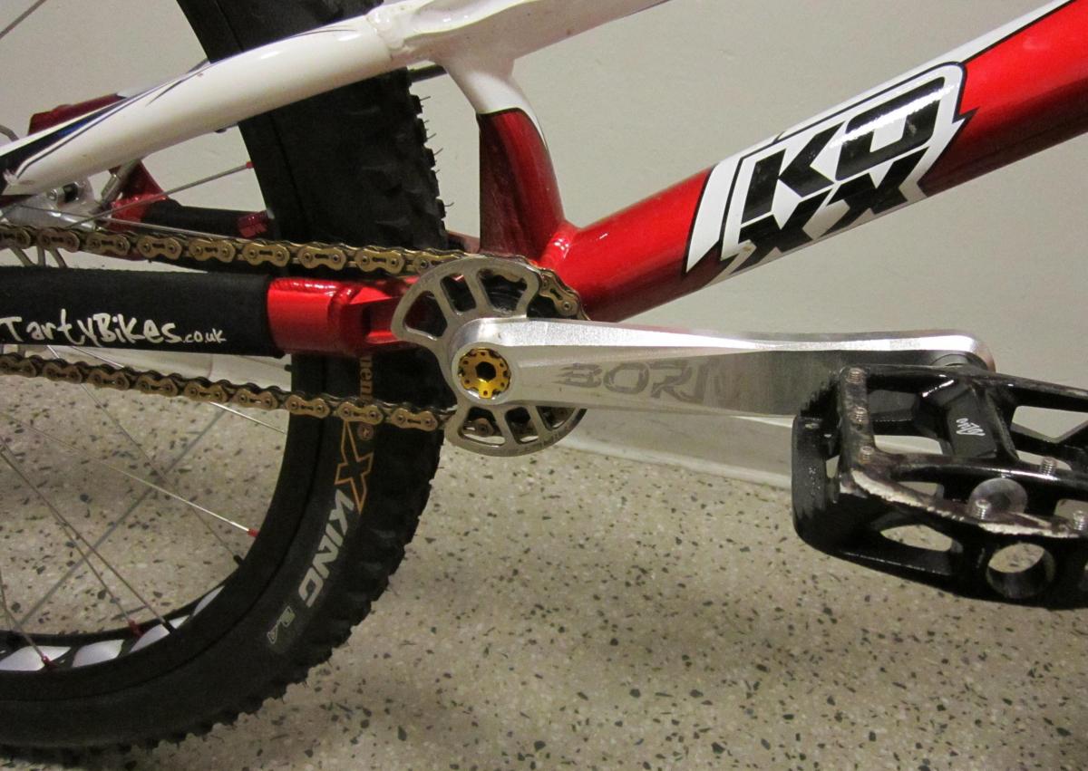

Thehiphopsolidier Posted April 5, 2013 Author Report Share Posted April 5, 2013 A smal update. Last update before my full carbon bike. Quote Link to comment Share on other sites More sharing options...
chimpanzyyyy Posted April 5, 2013 Report Share Posted April 5, 2013 that's some serious porn 1 Quote Link to comment Share on other sites More sharing options...
Rusevelt Posted April 5, 2013 Report Share Posted April 5, 2013 Cool rim tape design on the rear. Quote Link to comment Share on other sites More sharing options...
williams Posted April 5, 2013 Report Share Posted April 5, 2013 That looks awesome:D Quote Link to comment Share on other sites More sharing options...
Danny00135 Posted April 5, 2013 Report Share Posted April 5, 2013 Nice rim tape.. But it just looks so short :/ Quote Link to comment Share on other sites More sharing options...

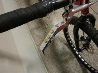

Thehiphopsolidier Posted July 18, 2013 Author Report Share Posted July 18, 2013 New pics. custom carbon fiber blade and disk. 1 Quote Link to comment Share on other sites More sharing options...
XYXLV Posted July 18, 2013 Report Share Posted July 18, 2013 Mate, can you tell us about carbon rotor? How it works and how did you did it? What about overheating? 1 Quote Link to comment Share on other sites More sharing options...
AdamR28 Posted July 18, 2013 Report Share Posted July 18, 2013 With normal pads, they are pretty loud, but work well... Don't like heat!A better quality carbon fibre would take more heat though. Quote Link to comment Share on other sites More sharing options...
