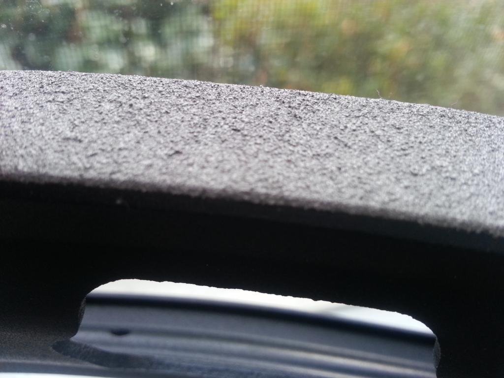

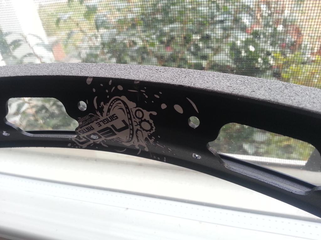

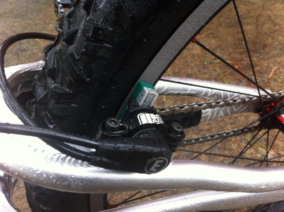

rupintart Posted January 15, 2013 Report Share Posted January 15, 2013 (edited) Not sure how interested you UK folk would be in getting a rim coated from the US but I figured I'd post my impressions on here too. No more grinding, no more weakened rims from grinding cause you have a full sidewall. Works just as good in wet too. I'm glad I did it. I'm so stoked to never have to grind my damn wheel again. If you want low maintenance, this is the route to go for sure. As far as pricing goes, Nigel gets a better price the bigger the batch is. My batch was a small batch of 4 rims, so my pricing was on the higher end of the scale but it's still worth doing if you never have to grind again. IMO, it pays for itself after like 2 or 3 grinds for having no hassle, let alone not weakening your rim every time you have to grind. I have nearly 20 hours on them now and the pad life isn't any worse than with a harsh grind. Below is a short vid for those of you curious as to how it sounds and works. http://youtu.be/zcC6FhYPA_c There's more on the forum below if you're wondering if it's like the plazmatic coating of the past, etc. http://www.observedtrials.net/vb/f3/nbkohrings-coated-rim-48907/ Edited January 15, 2013 by rupintart 1 Link to comment Share on other sites More sharing options...

rupintart Posted January 15, 2013 Author Report Share Posted January 15, 2013 (edited) Works as good as a harsh grind and works the same when wet. The only con to this coating is it costs money to get done. It's better than a grind in every way in that you don't have to do it anymore, it doesn't wear, good for the life of the rim since it's bonded to the rim, you don't weaken your rim from grinding (flatspots, easier to knock out of true, etc), works just as well wet as it does dry, consistent. Anybody who's ridden the plazmatic coating back in the day knew how it performed, this is an improved version. FWIW, there's a past and/or current world champion using it as I type this, but contractually (sponsorship) can't publicly outright say they're running it. He's on his second set and he's ridden them on video if you pay close enough attention. That's all I can say about that. Edited January 15, 2013 by rupintart Link to comment Share on other sites More sharing options...

Blake Posted January 15, 2013 Report Share Posted January 15, 2013 One letdown. How do you deal with contamination? Link to comment Share on other sites More sharing options...

rupintart Posted January 15, 2013 Author Report Share Posted January 15, 2013 (edited) The material is bonded to the rim via very high heat so it's more or less part of the rim now. I can see that it would make people stand-off-ish to it because it's an added expense, but like you just pointed out you would have to replace 2 more rims AND you would be grinding ever couple of weeks. Meanwhile I'm still using one rim and never had to touch an angle grinder and still have better wet performance than you would AND spent the same amount of money over all (less money than you if you account for the time it takes to grind and/or pay to build your wheels.) If you don't care for the expense, say so. Don't bag on a product that you (not you specifically, generally speaking) have no experience with especially since very experienced riders are having great success with. If it's too rich for your blood, that's fine....many things are beyond many people's budget and it's to be expected that not everybody would want/afford it. This is simply an alternative to those that are can afford and/or are willing to explore other options. It's part of the reason the trials community is so far behind the rest of the cycling community, people are quicker to hate on new things rather than experiment or actually improve on things. That $145 price is on the high end if not topped out because the guy coating prefers large batches, so the price drops the more rims he has. That $145 price is the top of the scale if your rim were the only one in a batch (like mine practically was). Plazmatic didn't fail at it, nobody bought it because people were too cheap to spend $150 on it 10 years ago. The plazmatic rims that were coated, most of them are still kicking around fyi. And considering inflation, it being cheaper now (and improved upon) says it's a viable option now. Most of the reason people buckle rims is because the sidewalls are half the thickness they originally were from grinding over the weeks and/or months. Grinding significantly reduces the vertical and lateral strength and almost exponentially reduces the lifespan of the rim from increases in the stress/fatigue per volume of material. It's simple physics. If something isn't as thick as another, it's not as strong with the same forces applied. Never mind the fatigue factor of aluminum of being under stress and tension constantly. As far as contamination, since the material is bonded to the rim, you don't have to worry about solvents deteriorating the adhesion, so Simple Green or any household cleaner will do the trick. Edited January 15, 2013 by rupintart Link to comment Share on other sites More sharing options...
