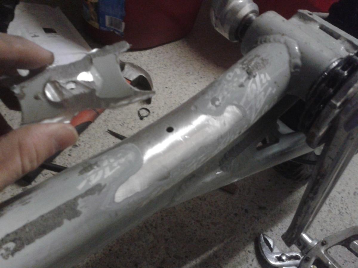

SamKidney Posted January 13, 2013 Report Share Posted January 13, 2013 Right, I recently purchased another Ice 2. I love the frame, and Im all too aware they're hard to come by now, so I want it to last. My previous one cracked at the bashplate weld ends, so I intend to remove them to eliminate the stress riser. My method would be to use a dremmel, and cut along the inside of the welds just enough to remove the bash mount and its gusset, but not go through the downtube, and then file away the remaing welds until theyre flush with the downtube. Would this be the right way to go about it, or would I encounter any problems? Cheers. Quote Link to comment Share on other sites More sharing options...

SamKidney Posted January 13, 2013 Author Report Share Posted January 13, 2013 (edited) It's being whipped off tomorrow. As for the stress point, it is exactly like how a fork breaks. The stress a fork goes through ideally needs to be dissipated as equally as possible. The 4 bolt mounts on a rear of a fork interrupt this dissipation, and the stress is diverted to this point, causing a weak point. I.e, the stress riser/point. Thats what I can make sense out of it. An example of this would be try-all having a line of weld from the mounts up the leg up to the crown on their forks in an effort to evenly spread this stress. I dont know if it works, someone who's ran both examples would have to comment. Disc forks tend to last far longer than their 4 bolt counter parts because they dont have the mounts welded to the back of the legs. Im hoping, in applying the theory to my frame and removing the mount, I eliminate its weak point and prolong its lifespan. Edited January 13, 2013 by Echo Lite 09 Quote Link to comment Share on other sites More sharing options...

chris_trials Posted January 13, 2013 Report Share Posted January 13, 2013 Actually, the weld doesn't create a stress point. If anything it adds strength, however, if you were to file/grind the weld so that it sits flush with the frame then that would create a stress point where you've thinned out the frame. All I would do is remove the main body of the mount and leave the welds alone 2 Quote Link to comment Share on other sites More sharing options...

SamKidney Posted January 13, 2013 Author Report Share Posted January 13, 2013 It wouldnt be thinning the frames tubing. It would be filed so the weld is removed, with as small amount of tubing as possible. Like I said, I'll be going ahead anyway. If it lasts longer, great. If not, then it can only last as long as it would with it being there if the stress riser hasn't been removed. Sam, you are reading way too much into this. frames break, it's a fact of life. the damage on your old one was more than likely already done. cut the bolt hole thing off, smooth it off and leave it at that. mine has that, and it's not cracked in the 3 years me or josh barker had it Its something Im genuinely interested in, and dont mind finding out about. Im all too aware that frames break, I went through 5 last year. Quote Link to comment Share on other sites More sharing options...

BradJohnson Posted January 13, 2013 Report Share Posted January 13, 2013 I'd use a hack saw to cut off the thick, then do the rest with a dremmel and/or file. That way it eliminates the chances of slipping with a grinder and taking chunks out of bits you really shouldn't. Quote Link to comment Share on other sites More sharing options...
SamKidney Posted January 14, 2013 Author Report Share Posted January 14, 2013 (edited) Well, its done. Ground the welds down until I could just see the divide where the weld met the gusset, lifted it out, then filed the remaining welds down. All smooth. Edited January 14, 2013 by Echo Lite 09 Quote Link to comment Share on other sites More sharing options...
