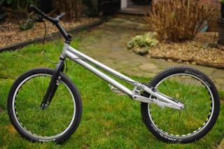

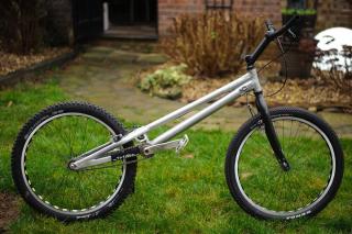

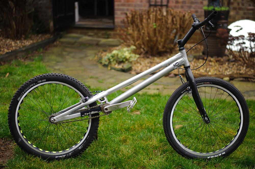

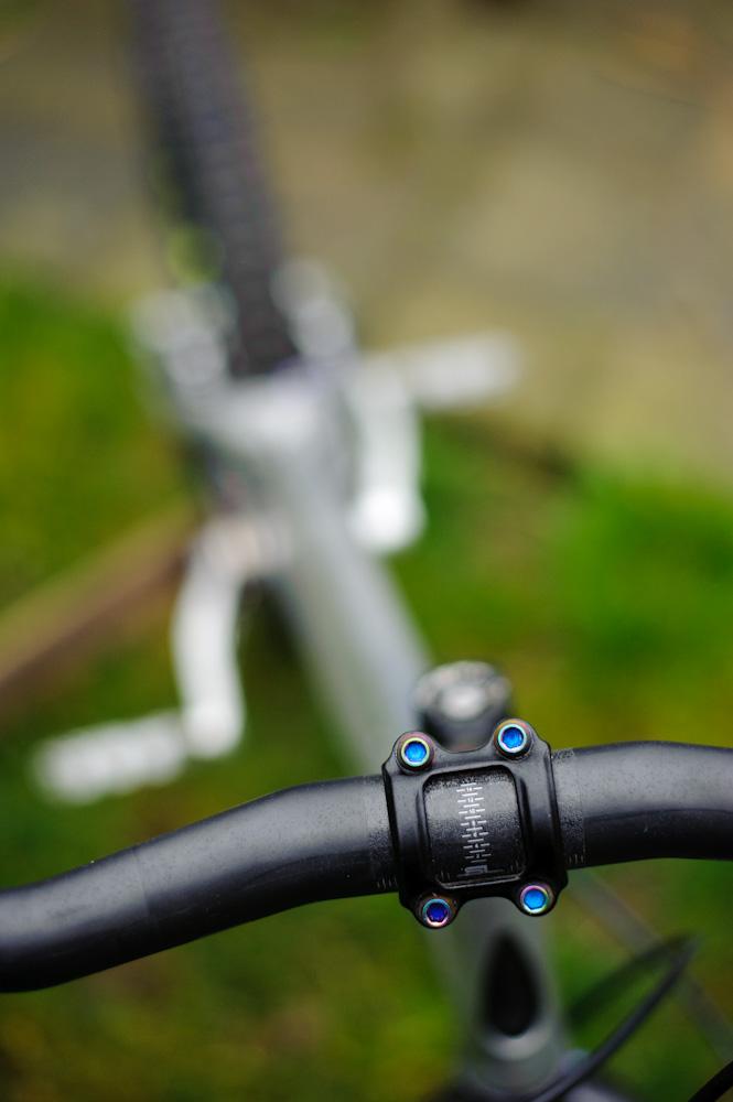

Joe Papasnap Maher Posted January 5, 2013 Report Share Posted January 5, 2013 Thanks to Tartybikes and Tnn for there continued support and also Stan titanium for hooking me up with some Sweet Ti Goodness!! Rockman Radix 24" Frame Rockman Spade Forks Trialtech Sport Lite Bottom Bracket Rockman Lite Cranks Trialstech SL Titanium Halfring Magura HS11 Front and Rear Trialtech Splitters Front and Rear Stan Ti Bolts and Fittings Front and Rear TNN Adm Blacks Front and Back Tartybikes Forged Stem 165x30 Trialtech SL Carbon bars Trialtech Foam Grips Neon Bow Headset Echo SL 108 Freewheel Bonz Pro Light Rear Rim Laced on Because Rear Hub V!z Single Wall 2013 Front Rim Laced on Onza Sealed Non Disc Hub. Schwalbe Fat Albert Rear Tyre Kenda Block 8 Front Tyre Weighed Today at 8.28kg 2 Quote Link to comment Share on other sites More sharing options...

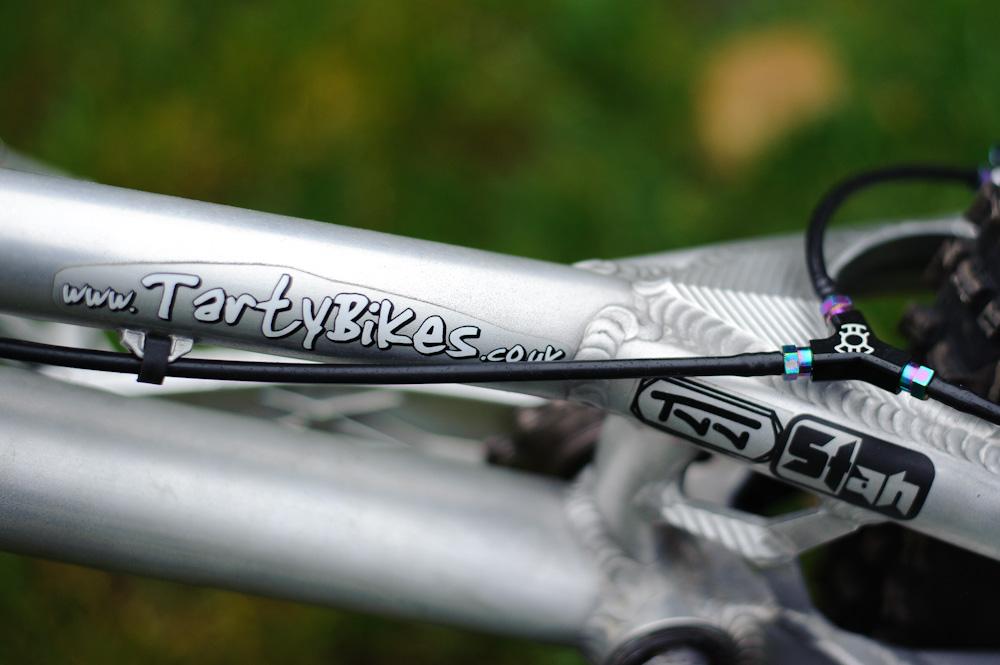

Sam T Posted January 5, 2013 Report Share Posted January 5, 2013 Could have put the rear splitter under the top tube, would have looked awesome Apart from that I agree! 1 Quote Link to comment Share on other sites More sharing options...

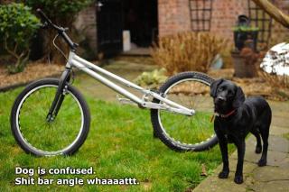

SamKidney Posted January 5, 2013 Report Share Posted January 5, 2013 I like your dog. CUTE! Quote Link to comment Share on other sites More sharing options...

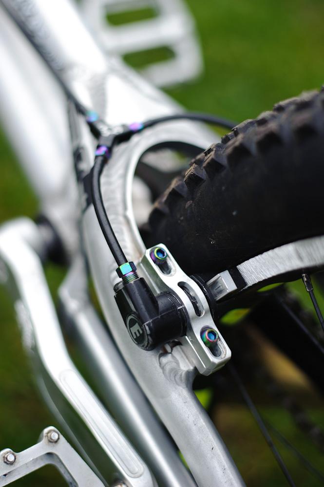

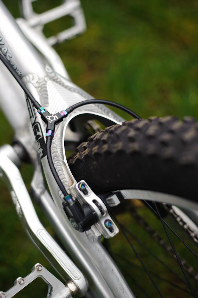

Jake. Posted January 7, 2013 Report Share Posted January 7, 2013 Not overly keen on the crossovers, cool idea though. Bike looks really nice without the orange. It's at a pretty good weight. Quote Link to comment Share on other sites More sharing options...
ChrisTrials2012 Posted January 7, 2013 Report Share Posted January 7, 2013 http://www.trials-forum.co.uk/index.php?app=core&module=attach§ion=attach&attach_rel_module=post&attach_id=58603'>bars.jpg How? Pretty moderate bar angle, not fully Carthy, not fully Ali. 2 Quote Link to comment Share on other sites More sharing options...
Joe Papasnap Maher Posted January 7, 2013 Author Report Share Posted January 7, 2013 How? Pretty moderate bar angle, not fully Carthy, not fully Ali. Yer..Best of both worlds Quote Link to comment Share on other sites More sharing options...

Dave Anscombe Posted January 7, 2013 Report Share Posted January 7, 2013 Over time wont the slightly longer cross over pipe cause problems-like slower piston ? Quote Link to comment Share on other sites More sharing options...
Jake. Posted January 7, 2013 Report Share Posted January 7, 2013 Over time wont the slightly longer cross over pipe cause problems-like slower piston ? Why would it? As long as it's all bled properly the fluid will have to go somewhere when the brake lever is pulled. Quote Link to comment Share on other sites More sharing options...

SamKidney Posted January 10, 2013 Report Share Posted January 10, 2013 How does the Bonz rim compare to the Viz for holding a grind? Quote Link to comment Share on other sites More sharing options...
stunt man t Posted January 10, 2013 Report Share Posted January 10, 2013 Over time wont the slightly longer cross over pipe cause problems-like slower piston ? its a sealed system it doesnt matter, 1 side could be 2cm long and the other could be 2ft long it would still work the same Quote Link to comment Share on other sites More sharing options...
Joe Papasnap Maher Posted January 10, 2013 Author Report Share Posted January 10, 2013 How does the Bonz rim compare to the Viz for holding a grind? A little better id say.. Quote Link to comment Share on other sites More sharing options...
Erik_f12 Posted January 10, 2013 Report Share Posted January 10, 2013 (edited) like it!! what is the size of the kenda? 2.1 or 1.95? Edited January 10, 2013 by Erik_f12 Quote Link to comment Share on other sites More sharing options...
Mark W Posted January 10, 2013 Report Share Posted January 10, 2013 You do slightly lose points for not putting your rear splitter under the top tube and running two longer hoses to the cylinders, but aside from that it's beltin'! 1 Quote Link to comment Share on other sites More sharing options...
Joe Papasnap Maher Posted January 10, 2013 Author Report Share Posted January 10, 2013 You do slightly lose points for not putting your rear splitter under the top tube and running two longer hoses to the cylinders, but aside from that it's beltin'! I am changing it tomorrow Quote Link to comment Share on other sites More sharing options...
