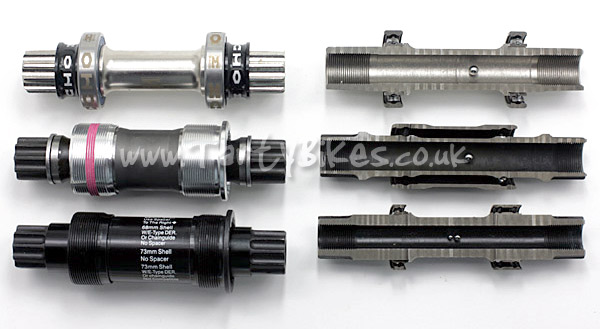

stunt man t Posted January 4, 2013 Report Share Posted January 4, 2013 (edited) http://www.tartybikes.co.uk/images/custom/bbs/large_echourban3.jpg looking at the cross cut of the bb even if you tuck some off, the bolts wudnt screw down far enough unless you used washers...... which I WOULDNT! Edited January 4, 2013 by stunt man t Quote Link to comment Share on other sites More sharing options...
ashleys sugden Posted January 4, 2013 Author Report Share Posted January 4, 2013 lets face it you've tried it all, you either have to accept the bb is dead, but your best option is to run a tap through it to re new the threads then the bolts should go in fine! from you video though it looked like you ripped some threads off?! http://www.ebay.co.uk/itm/HSS-Tap-Set-M15-x-1-0-15mm-/290831767895?pt=UK_BOI_Metalworking_Milling_Welding_Metalworking_Supplies_ET&hash=item43b6ec9957 screw thathttp://www.tartybikes.co.uk/images/custom/bbs/large_echourban3.jpg looking at the cross cut of the bb even if you tuck some off, the bolts wudnt screw down far enough unless you used washers...... which I WOULDNT! ah ok, if my dad cant bring a 15mm tap from work i will have to buy another, is any getting rid of a second hand one? i cant afford to buy a new one ideally :/ 1 Quote Link to comment Share on other sites More sharing options...
