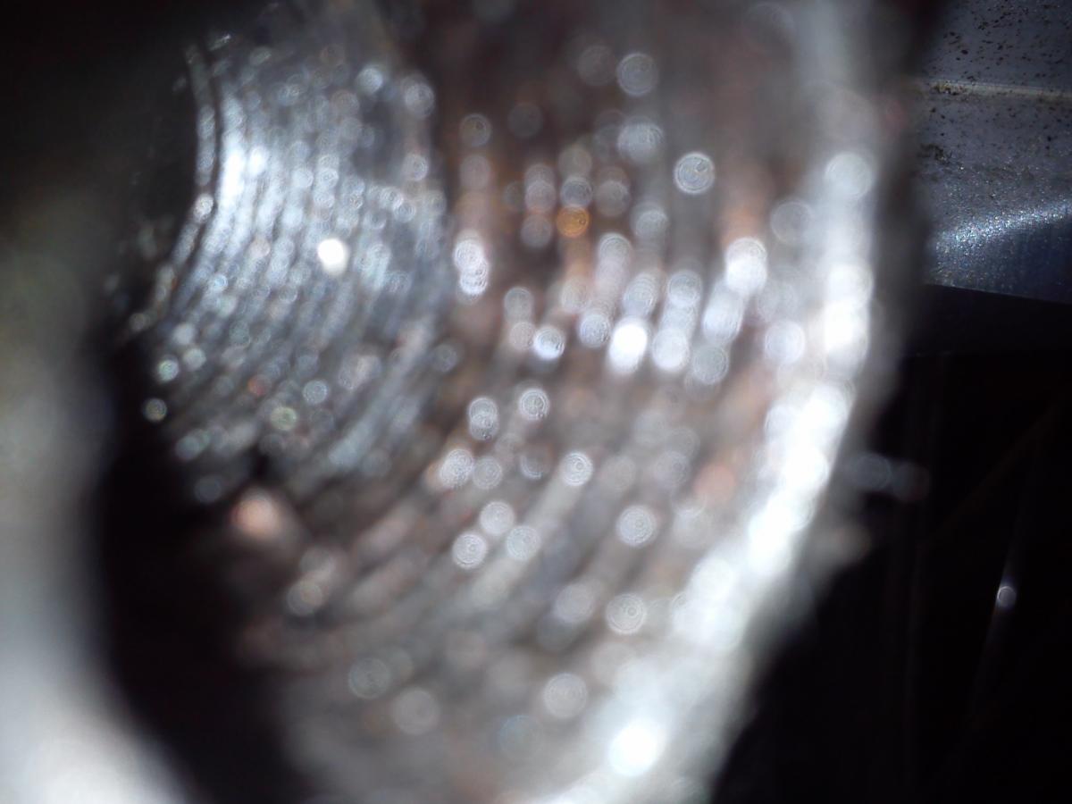

Get up some pics, I've never heard of this happening before..
video and pics shortly
that's taking threads off the end of the bolt dude, it looks like the threads on the end of it are gone too meaning it won't have any way of starting to turn in the threads of the bb. do you have a tap you could run down the bb threads? might be able to rescue the threads of the bolt, snap a pic of it as a silhouette with a light behind it so the threads are visable.

Looks like bb threads to me?
the threads look fine though :/
